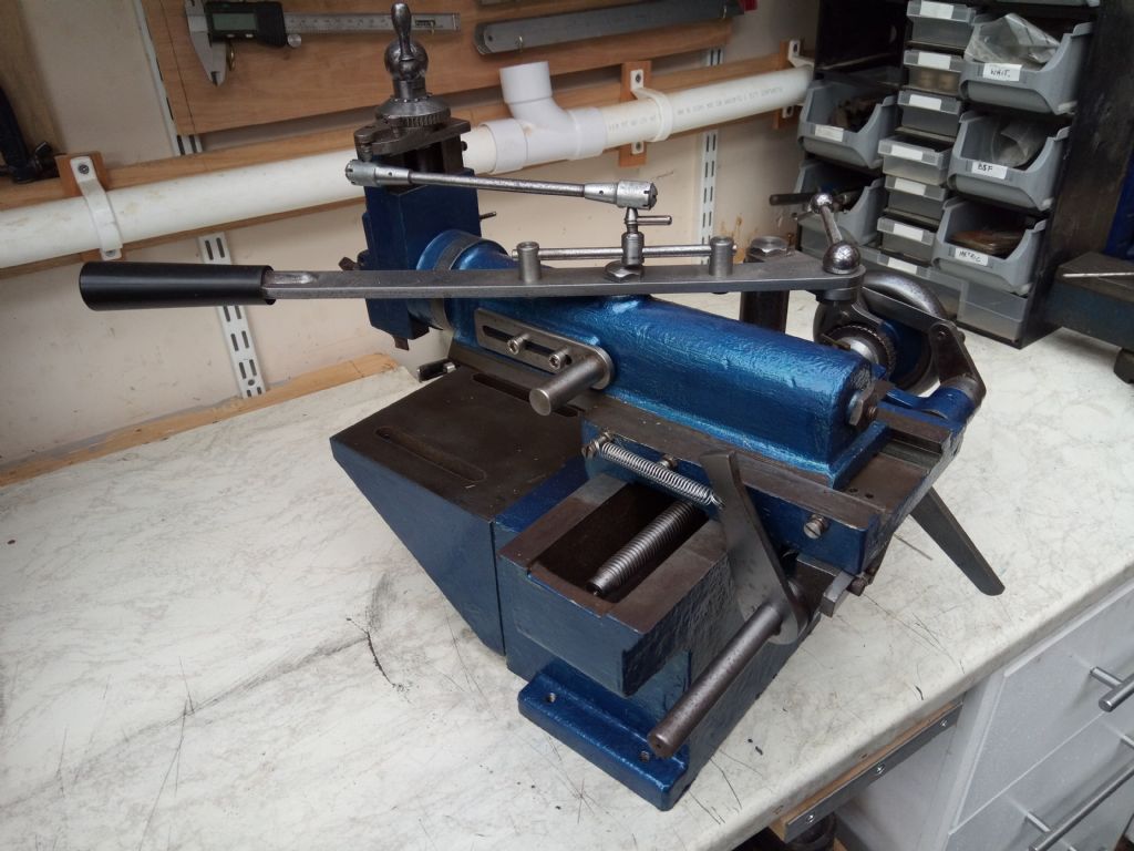

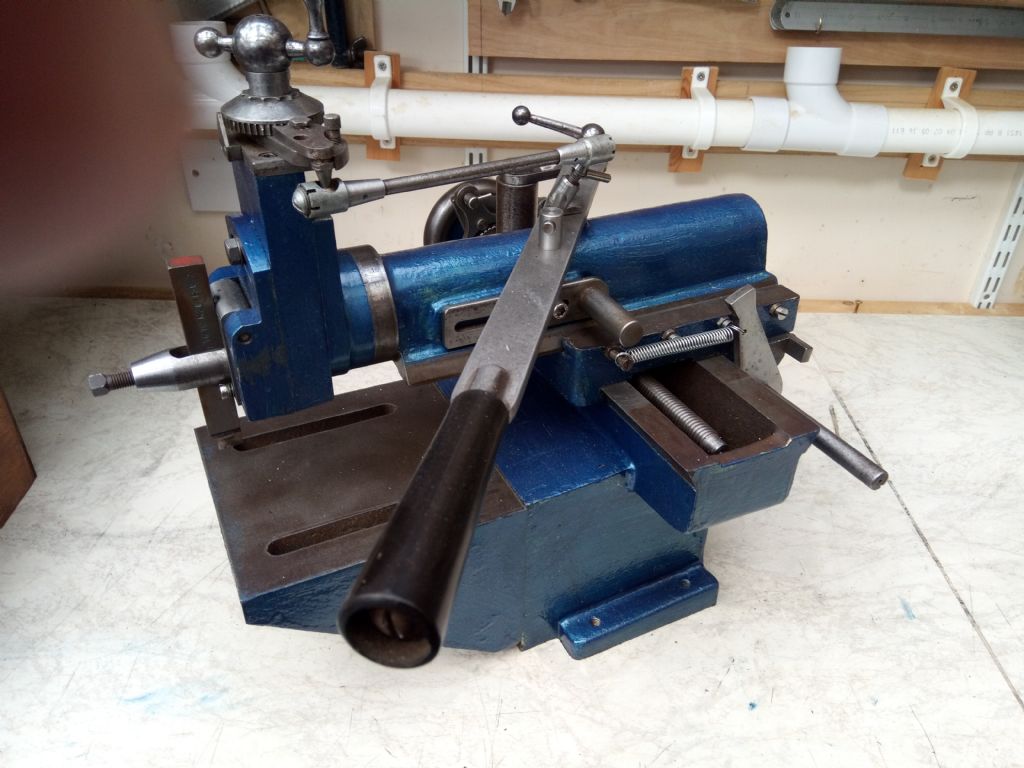

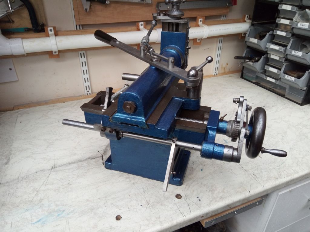

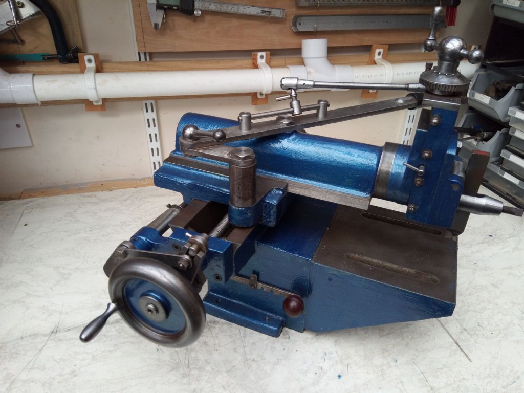

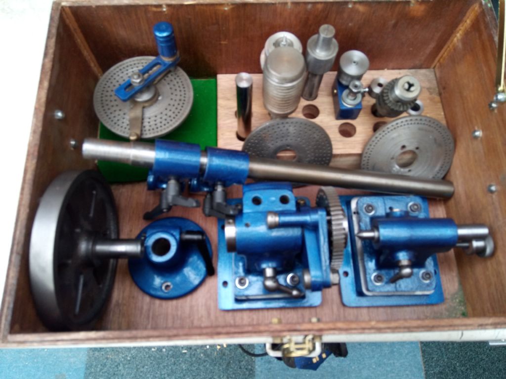

                        #464335
                        Redpiperbob
                          @redpiperbob16487
                          Hi All
                          Here are some pics of the shaper now. The cross feed return spring was broken so I have put an extrernal one on the right hand side of the machine. I still need to change the crossfeed leadscrew and nut . Then thoughts on motorizing the beast. Apart from the leadscew/nut this machine was built very well I have already cut a keyway with it. I am most chuffed with this buy.
                          and here are a couple of pics of my Piller tool and Versitile deviding head Of course to GHT's designs. I am just finishing the interior of the box.
                          Thanks for looking
                          Bob
                          Edited By Redpiperbob on 13/04/2020 09:46:20
                          #464420
                          Frank Gorse
                            @frankgorse
                            Nice paint job,makes mine look very neglected.I’ve never seen the auto downfeed before,presumably a mod by a previous owner? Mine doesn’t have the ball handles on the pivot arm,just hex heads with oil holes. And there's an extra mechanism on the left side with a brown knob on it,what exactly does that do? Regards, Frank

                              #464430
                              Redpiperbob
                                @redpiperbob16487
                                Hi Frank Thanks for the comments. I use Hammerite paint it can hide a lot of things. The knob that you talk about hits the leaver you cansee sticking out in picture 3 this limits the travel of the cross slide. there are 3 positons on the arm of the brown knob I havent worked out the distances yet.
                                If youneed any other info please let me know only too glad to help.Thanks

                                            #490404
                                            Bazyle
                                              @bazyle
                                              I see what you mean about it looking like and Adept, except for the ram. Some close ups of the downfeed would be interesting and more on the brown lever when you figure it out. Especially views on whether it a mod worth doing on others when you have used it a bit. In a way an auto stop feature seems a bit pointless on a manual motor unless the operator is shaping in his sleep wink Maybe fit a bell to wake him up.
