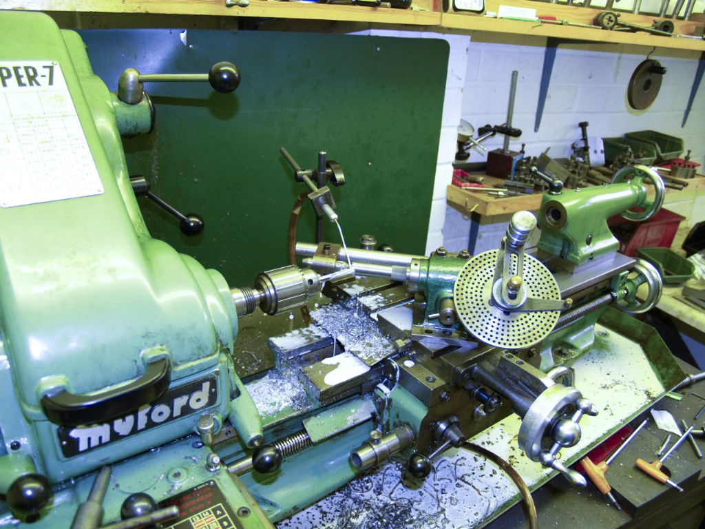

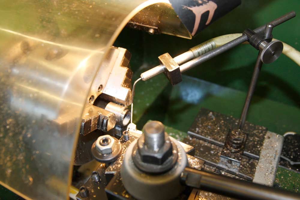

                                        Depends on how you flood – the mess. Most commercial systems using the plastic clip together lines just dump a a whole lot of mess everywhere. What one wants is a relatively small amount of coolant directed to the right spot.
                                        Right spot means that the coolant holder has to go on the head, not the table – because the head doesn’t move WRT to the cutter – and when drillng from the quill it doesn’t move WRT to the job.
                                        So by using a magnetic or a modified DTI holder on the head, its very easy to get the coolant in exactly the right place, and without having everything flop about while one tries to set it up..
                                        Quantities – I use a 2mm vetinerary needle. I get a nice high pressure jet, so its blowing swarf away, and it keeps the cutting point flooded and cool – but there isn’t actually all that much coolant in circulation. Its a neat and tidy system which works well
                                        Health risks – well perhaps. I tend to keep my face further from the cutter than my hands.

                                            Alvin – you wanted some details of the coolant system. Regrettably the one for the mill is under construction, so here are some shots of the lathe versions. The only difference is that the mill one is being mounted on the head with a sliding drop rod, so it’s height adjustable.
                                            Pumps are, for the Myford the Axminster cheapie – which also supplies the Dore Westbury.. And for the ETR lathe, the one that came with the lathe. For ages on the DW mill/Myford, I just used the same basic spout (thin brass tube from a model aero suppliers will be just as good) and a wall mounted gravity feed, and a catching can. So a pump is not essential.
                                            Valves – I use one of the little Gas Valves, but I have a spare 1/4″ globe valve from my steam fittings box, so I shall use that on the big mill.
                                            This is the standardsetup on the ETR.
                                            And reversed feeding through a hollow boring tool
                                            And the Myford.
