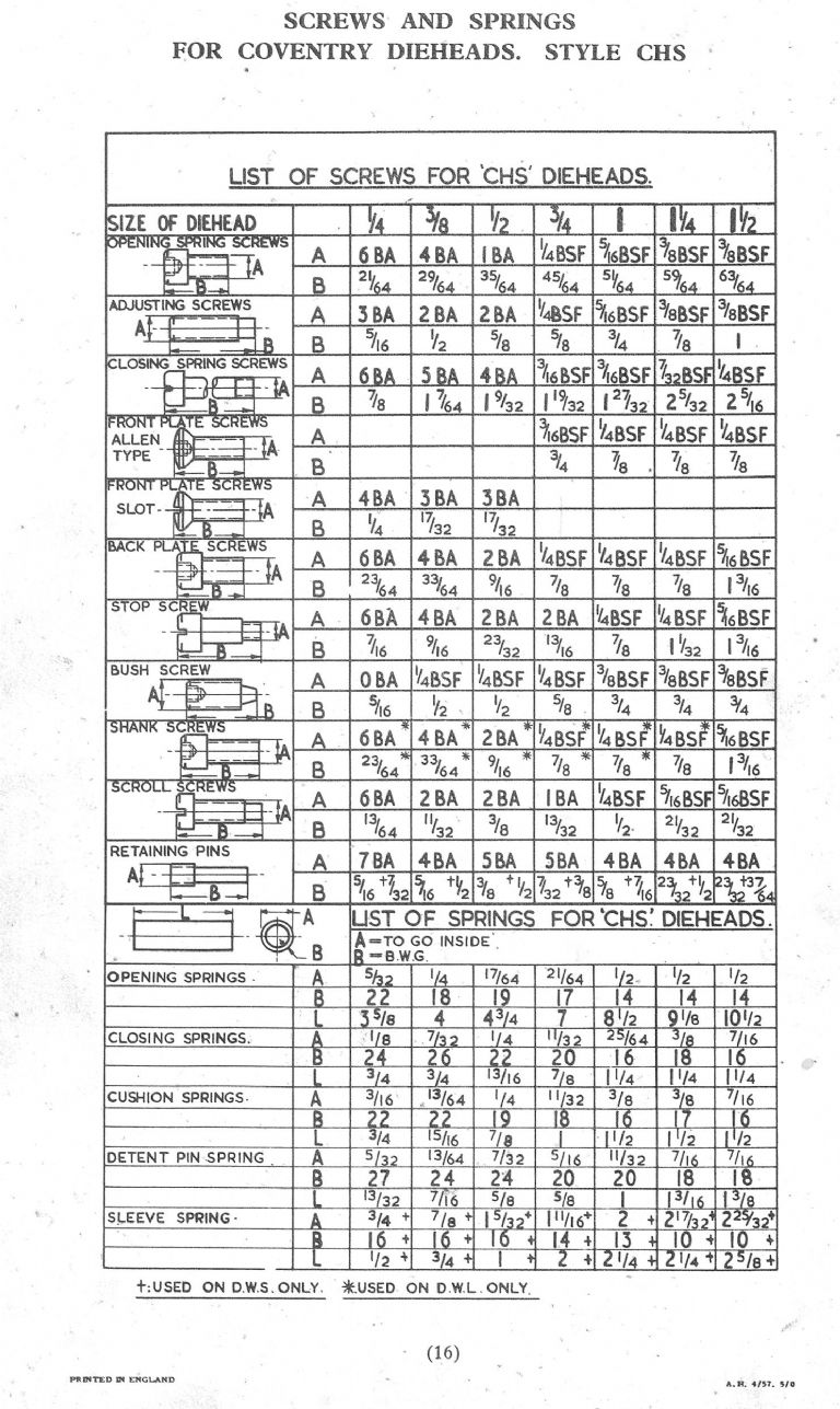

      My Coventry Die Heads are missing some threaded parts and I'm struggling to identify what thread form they will be.
      1/2" CH Die Head; front plate screws
      3/4" CH Die Head; front plate screws; Shank Screw; Closing Spring Screw
      Any ideas what Alfred Herbert's designers might have specified back then?

          All Herbert die head screws were imperial size BSW/BSF/BA. They did not go near metric till early 70's, Doubt if they would have altered specs.
          UNC/UNF only used on american licenced tools Devlieg/Microbore
          Taps /Dies etc were manufactured at Blackhorse Road Site.

            Hi Paul, welcome to the forum and I hope the scan below gives you the information you are looking for.
            Regards Nick.

              Wow, That is fantastic guys. I'm really glad I joined your forum. I can now get on and refurbish / repair the Die Heads. Thanks for you help.

                  Hi Paul, I've just noticed that you mentioned CH Die Heads and that I've put the CHS list up, so here's the the CH list.
                  Regards Nick.

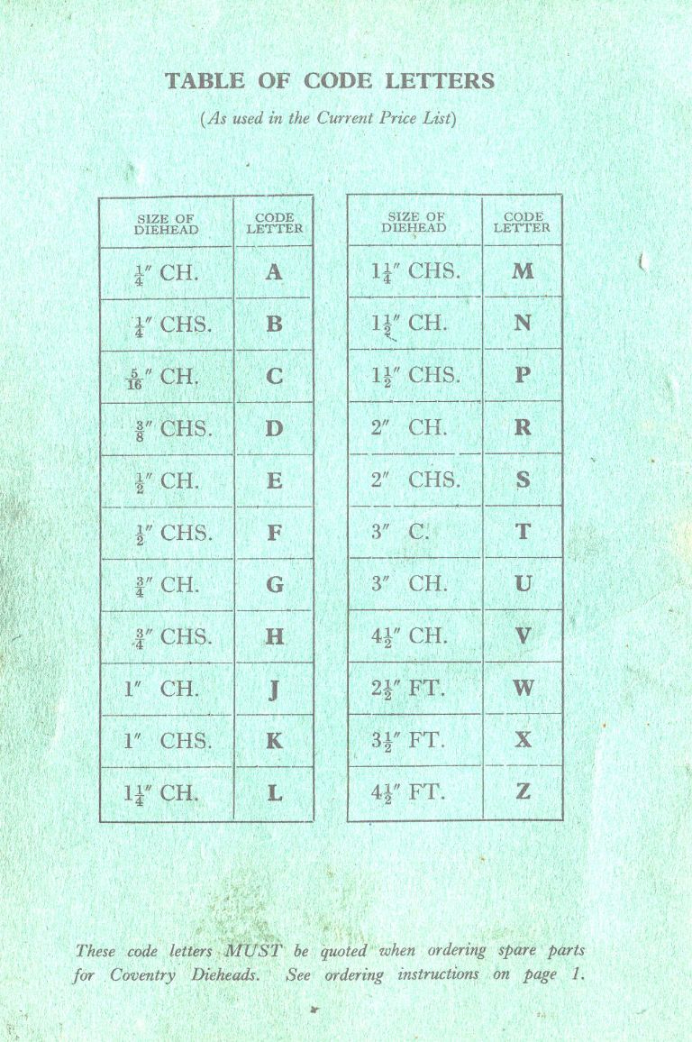

                    Hi, these code letters maybe useful to anyone who has a Coventry Die Head.
                    Regards Nick.

                      That makes sense now. I read that CH were non standard threads.
                      New problem now! what does .136, .155 & .175 refer to?
                      Paul

                          Sorry, That was badly put by me. It was the thread form that appears to be missing from the chart. I think from the sockets they are 40 TPI so I'm going to turn a .155" x 40TPI Whitworth screw and see if it fits.

                            I checked the screw pitch on a front plate screw and found 40TPI but I had a diameter of .147"

                              Hi Paul, it does seem strange that the TPI is not mentioned and there isn't any other information in the scans from a complete booklet publication. 5/32 x 40 ME looks as if it is about the right size though for 0.155, if the TPI is correct, but a 5/32 BSW might work if the TPI happens to be 32. If the threads are 40 TPI, you might get a slightly over size 1/8 x 40 BSW / ME to work for the 0.136 and for the 0.175, a slightly undersize 3/16 x 40 ME might work.
