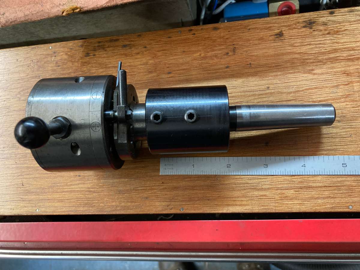

                    JohnF
                      @johnf59703
                      Hi Roger, I have a 1/2″ die head and use it regularly on my Super 7, I made a Morse taper adaptor to mount it int the tailstock, indeed I/we use these in industry on centre lathes and cut many hundreds of threads without any issues of the taper coming loose.
                      Here is a photo of mine, I did not drill through, never had the need up to now but there’s no problem in doing so within limits of course.   Many of the stub arbors on offer are too small in diameter and length, the nearest I found was here they have one 40 x 40mm better if it was larger but you could of course make your own.

                      Roger King 1
                        @rogerking1
                        Lots of really good help here, thanks all.
                        Thanks JohnF, I’ve ordered one of those, at £12 including postage you can’t go far wrong.  Just need to turn it down to suit and make up a sleeve to join them and I should be good to go.

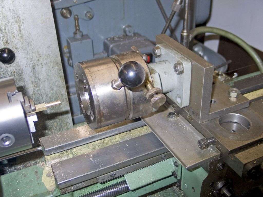

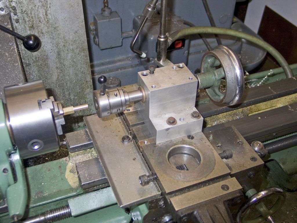

                                      Phil P
                                        @philp
                                        This is my set up.
                                        workshop_017_24_Dec

                                          @dc31k
                                          On Phil P Said:
                                          This is my set up.
                                          The original poster asked “Is there a straightforward way of mounting this device to a Super 7 tailstock?”
                                          Would it be correct to say that your photo does not show a Super 7 tailstock?
                                          To me, it looks like an ML7 tailstock with the quite rare Cowells rack-operated attachment. If the OP does not have these parts, what might be an alternative?

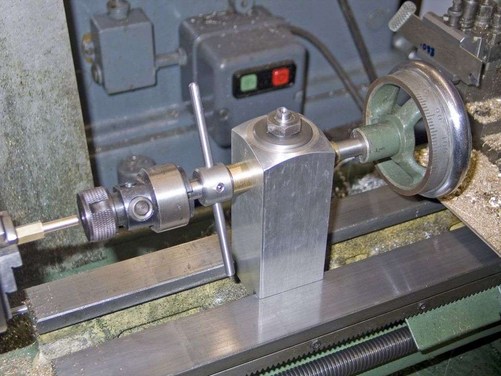

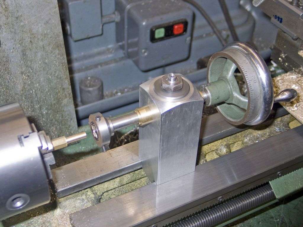

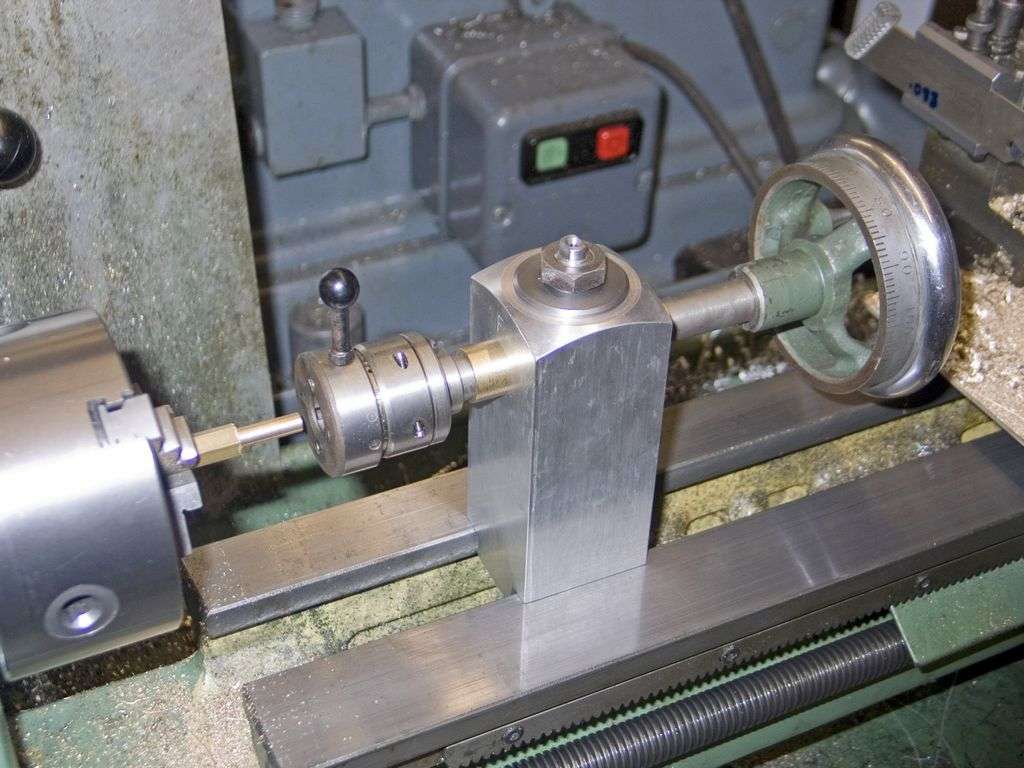

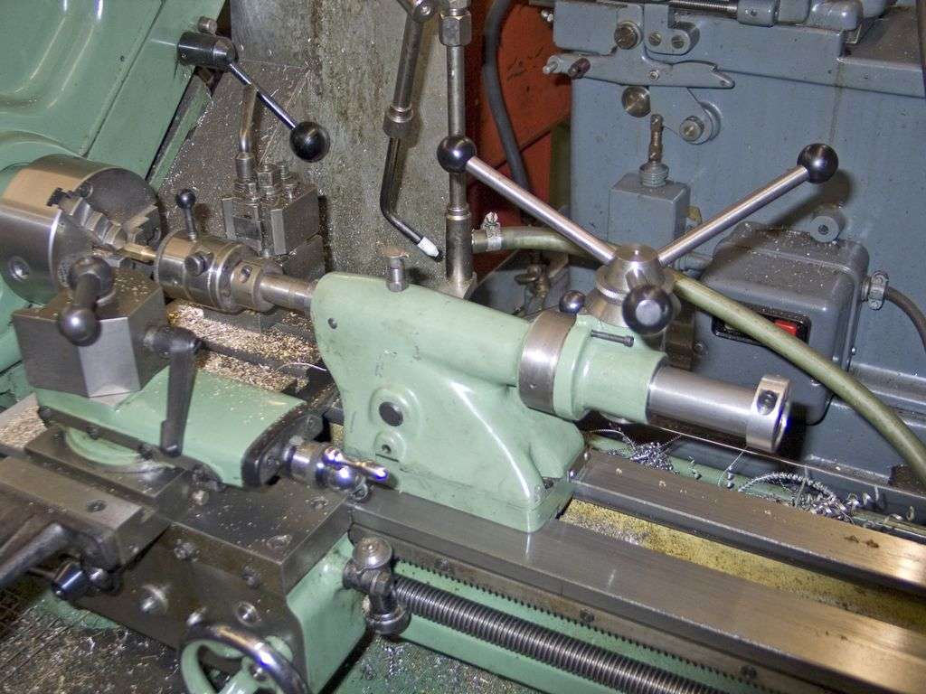

                                            #712547
                                            Phil P
                                              @philp
                                              I have used a large 3/4″ diehead fastened to the cross slide.
                                              workshop 019 24 Dec
                                              Then another version where the work says still and the die head is rotated, still mounted on the cross slide.
                                              workshop 021 24 Dec
                                              Whilst that version works well, it still means faffing around removing the top slide each time, so I finally ended up with this attachment that can be fitted and removed in less than a minute.
                                              workshop 013 24 Dec
                                              It can be used with normal die holders and tap holders.
                                              workshop 015 24 Dec
                                              workshop 016 24 Dec
