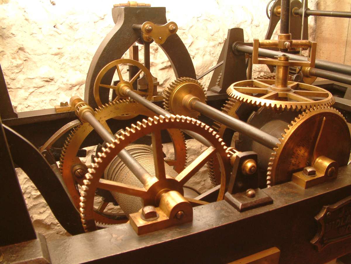

      I appreciate this is akin to asking how long is a piece of string! But the recent thread on getting parts cast piqued my interest. I am slowly progressing with my clock project, and am fabricating the frame from steel angle. However the original frame is cast iron, and the thread made me wonder what getting a frame cast might cost in iron or aluminium.
      Clock Frame
      I wondered if someone who has had such parts cast might give me an idea of the order of magnitude of cost of getting it done as a one off. High tens, low hundreds, high hundreds or in the thousands?
      I do have a 3D printer, but no experience of making  patterns for casting. Excuse the decimal places in the dimensions, they are an artefact of my 3D modelling.

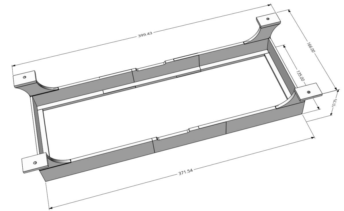

          Thank you Jason. Sorry for the delayed response. My CAD program (MOI) can now give me volume data – it’s just that I have never had the need to do so. So I had to find the external script that does so, remember how to install and run it.
          To answer your question, the volume of the part is 175cm3. All the walls are 5mm thick. I am fabricating from 5mm angle so all the parts are based on that. The real thing has the walls 3/4″ thick, which would be 4.5mm to scale, but I simply chose suitable stock steel angle.
          Thinking about it, I also wonder how the pattern would be put in/extracted from the mould, with the feet sticking out from the sides one way, and what is the top surface the other side. The original must have been done somehow as It shows no signs of  seams or welding – although with a date of 1889, it probably predates gas or electric arc welding.

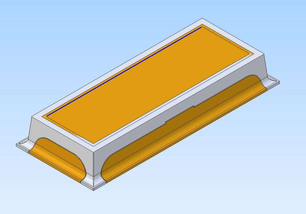

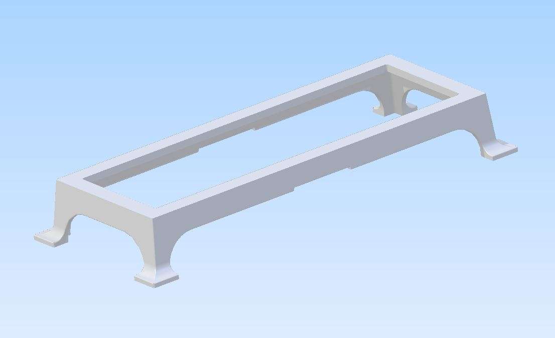

              I must have a thicker pencil than you Peter, I sketched this out this morning and got 223cm3 which gives a weight of 1.57kg, though my feet have a bit more material in them I did opt for 5mm thickness. I’ll PM you what it may cost.
              clock stand
              As to casting as well as the pattern you would ideally need to produce what is sometimes called a follow board. This is a piece to fill in the inside of the pattern when the first half is moulded right way up. It is then removed when the other half is moulded so the sand can fill the internal void. I’ll draw that up later as it is easier to see than explain. Someone casting at home where time is not a problem may simply scoop out the unwanted sand.

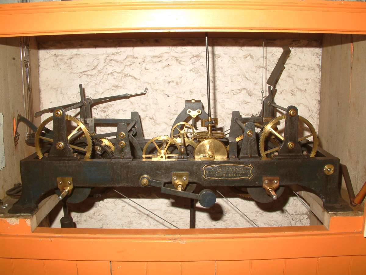

              Peter Cook 6
                @petercook6

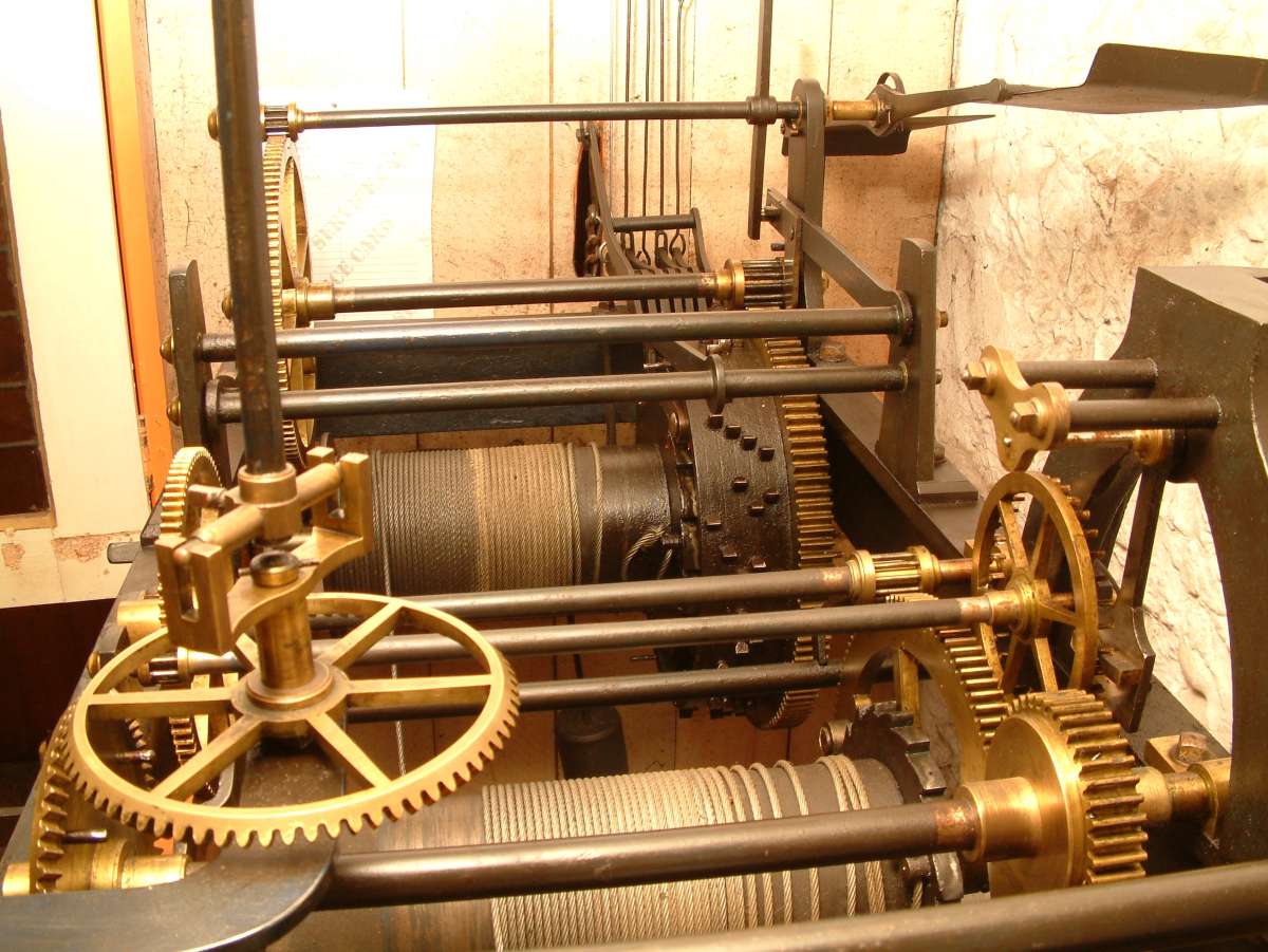

                As requested.

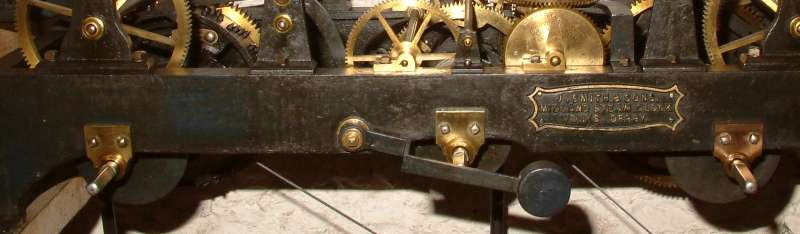

                The first is an overall view of the clock in it’s case (apologies for the case colour – I didn’t paint it!). The second is the the time train showing the suspension hanger with the strike train behind. The third is the chime train with the time train in the foreground.
                The frame appears to be a one piece casting. It has casting flaws in places ( small blow holes etc). All the uprights are also cast and bolted onto the frame. I can’t see (or feel) any joints in the frame.
                Other examples also made by Smiths (this one is dated 1889) seem to be much the same components. I presume it was delivered in pieces by horse and cart, probably either from the GWR station in Newbury or from Hungerford and assembled on site. The Lambourn branch did not open until 1899 – 10 years after the clock was installed.
                Thoughts on its manufacture would be welcome.

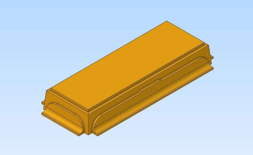

                    So to mould the frame that I showed above you would need to make something to infill it so that you are in effect moulding a solid part, the infill would nee dto look like this
                    follow
                    You would then stand the infill and pattern on a flat surface and mould the sand around them.
                    mould 1

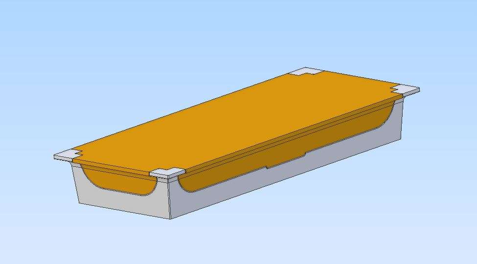

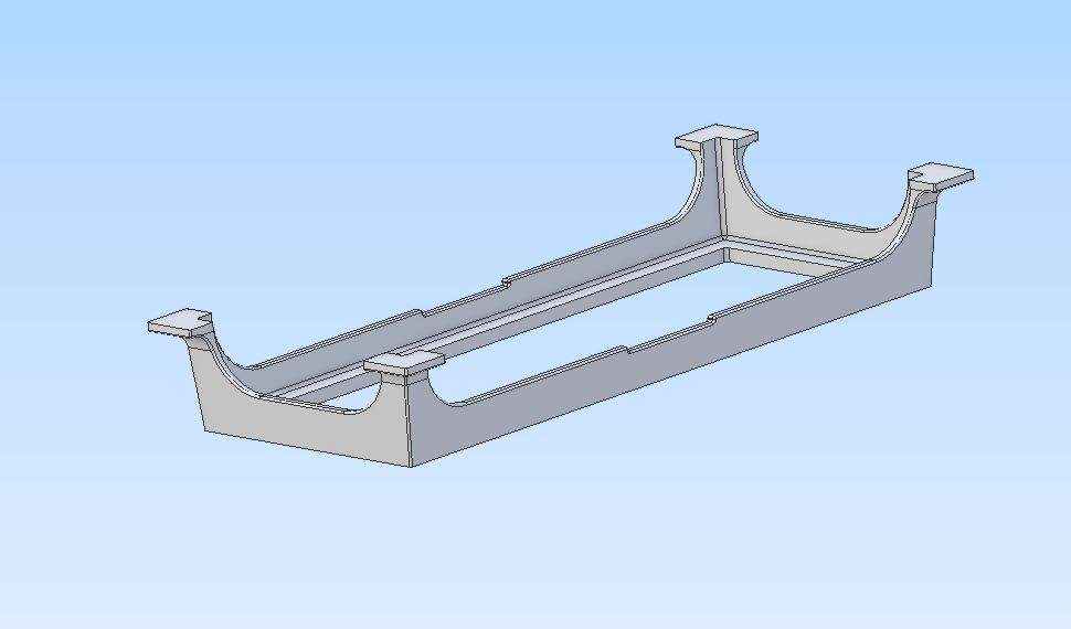

                    The box can then be turned upside down and the infill removed but pattern left in place, other half of the box positioned and filled with sand. This sand will then take the place of the infill so once the pattern is removed you will only have a void in the sand equal to the pattern which subsequently gets filled with iron.
                    mould 2
                    mould 3
                    You will need some draft angle on the “vertical” sides of the pattern so it can be pulled from the sand 2-3deg should be OK. A shrinkage allowance of 1% is what I tend to use for iron so pattern would be 166 + 1.66 = 167.66mm for example. Also a machining allowance on all surfaces that are to be machined which would be the top surface and the underside of the feet, couple of mm should do. Though think how you will machine them on a small mill.
                    You could 3D print the patterns from several parts and join them together or use a hardwood or even MDF but choose a decent one like Moisture resistant MDF as it is a lot denser than shed bought MDF.
                    As for the various attached cast posts etc at that size I would tend to go with silver soldered steel fabrications rather than castings with the possible exception of the arch-shaped one which looks a bit thicker. If these were cast they would be quite thin and you risk the problems of them cooling too quickly which can result in hard areas that become difficult to machine. Consider having all the sheet metal parts of the fabrications laser cut if you don’t want to mill them.

                            The Smith’s clock in the restoration images was dated to 1922 so 30+ years later than mine, but more importantly post the first world war when welding (arc & gas) moved from ideas into mainstream. So it’s more than feasible that post war Smiths adopted more modern manufacturing methods.
                            It’s interesting that on my clock the front plate reads J Smith  & Sons. Midland Steam Clock Works. Derby. On the later one the same plate reads J Smith  & Sons. Midland Clock Works. Derby. Eng.
                            The reference to Steam as a symbol of modernity having been dropped, and Eng. added, possibly a pointer to a more international business.

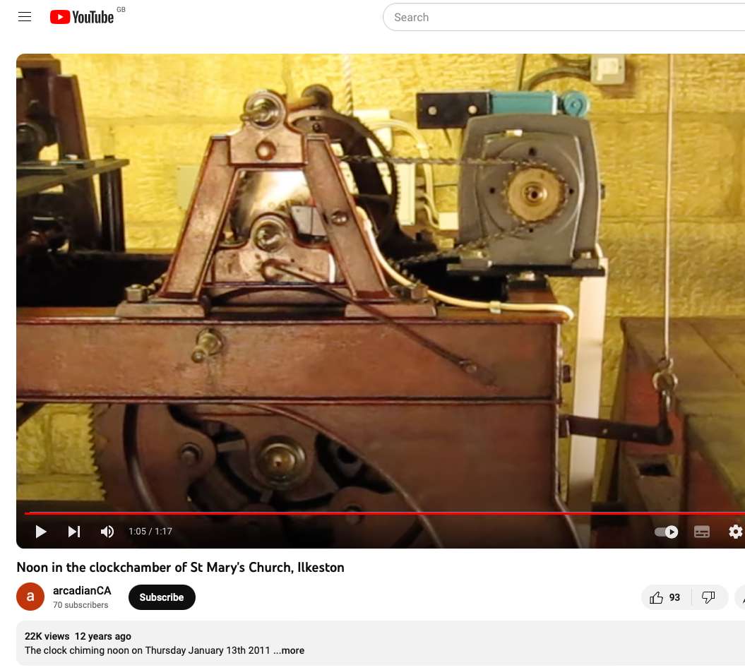

                                I presume you are familiar with the engraving on the Smith’s historical timeline, Peter … but have you seen how the bed of the clock at St Mary’s Ilkeston is actually constructed ?
                                https://youtu.be/k8o9vtbhZu0?feature=shared
                                Aside from the motorised winding … I wonder how much of that bed is original.
                                What was actually delivered to them ?
                                [ just an interested bystander ]
                                #697957
                                  How would you say that one is constructed, Michael? I could not say one way or the other if it is a steel/iron fabrication or based on castings. Would help if the ends could be seen.

                                    Most of the ones I have seen from this era whilst on clock tours have been cast iron and in one piece
                                    #697973
                                      It has the look of a “fabricated prototype” to me, Jason
                                      it rather looks  like a load of small castings sitting, interlocked, in shallow channels.
                                      … I’ve been busy scheming block-work and insulation [for a proposed extension] today, so haven’t done more than glance at it, but I will have a good look tomorrow
                                      What it certainly is not … is what’s shown at 1864 on the time-line.

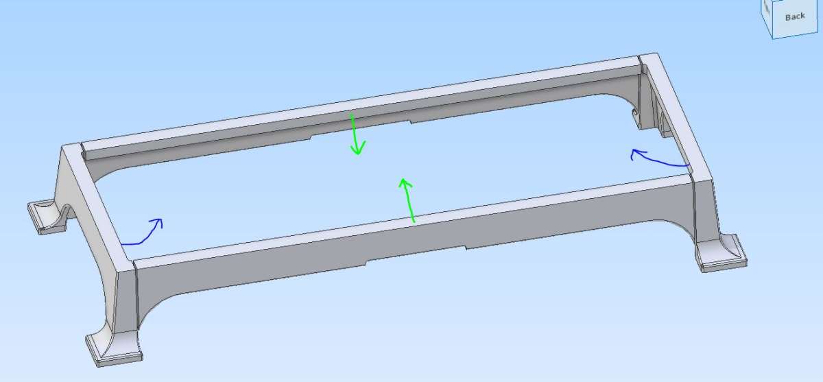

                                                I was looking at quite a few of the cast ones last night and think they may have been cast in another way, the odd bit of roughness in the corners a scan be seen here may also indicate how they were cast without the draft angle as they do look to be vertical sided.
                                                It would need the pattern making in four parts that can be extracted from the sand by moving them into the central void so no draft needed and then a sand core would probably have been used when casting. May also explain why the feet are not the same at the ends as they are on the faces.
