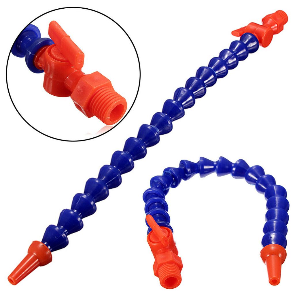

                  One of my first coolant pumps was a winscreen washer pump which worked OK for a reasonable time but eventually the oil in the solution caused the impeller to fail. As you already have one, use it.
                  Flexible coolant nozzles with a control valve are cheap on ebay.. This one costs AU $1.09 delivered from China. **LINK**

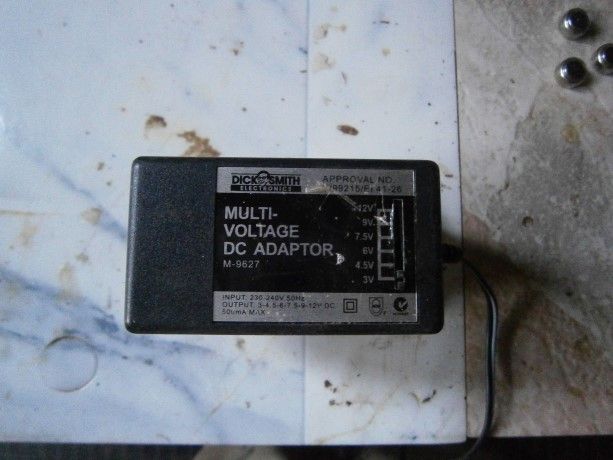

                      As this is a 12V pump you will need a power supply. Using a variable supply is a much better way of controlling the flow than throttling the output.
                      If you only have a fixed 12V supply and are throttling the output, try putting a 12V lamp in series with the motor (start with a 21W brake light and swap to a 45/55W headlight if not enough pressure.) This will provide a near constant current supply to the pump, reducing flow (speed) but maintaining torque and thus pressure as you throttle the output. using the lamp will produce less stress on the pump and reduce power consumption.

                              I ordered a window washer kit from epay comes with a roll of hose etc.
                              I my box of power packs ( 2 boxes to be honest) I found this one.
                              I will keep the on I found for my lathe.
