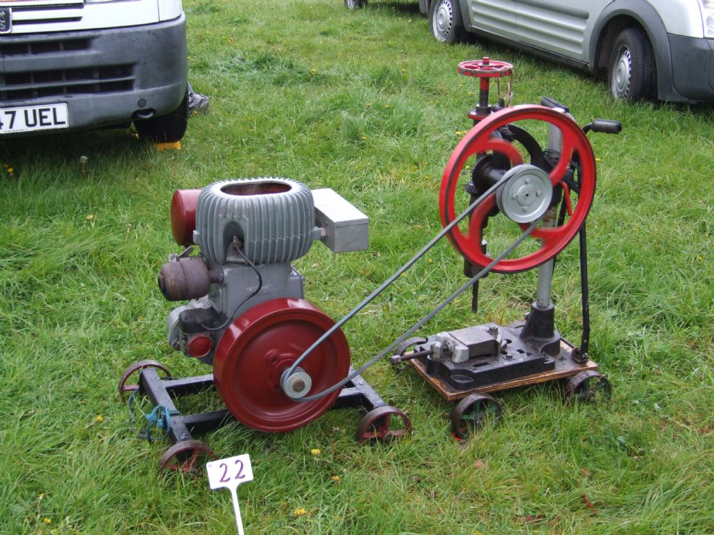

                  martin perman 1
                    @martinperman1
                    Rainbows,
                    This can be seen regularly on rally fields as a means of driving a manual drill.
                    Just replace the Wolesley engine with an electric motor smiley the engine runs at 650 rpm so the drill goes quite slowly.
                    Martin P
