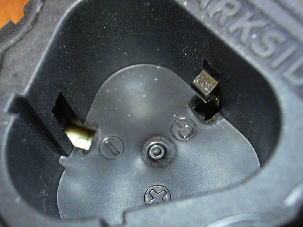

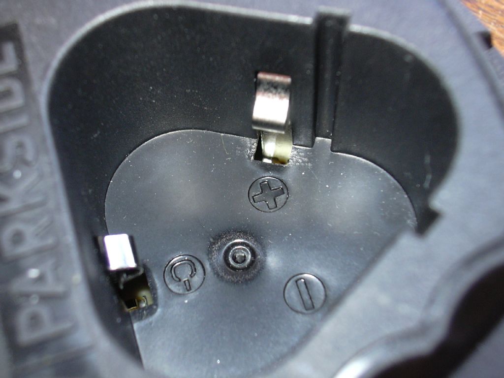

      Imagine my surprise, then, when I discovered that the charger (well, my charger) has only two electrical contacts. Let's see if I can insert the photos:
      and
      The positive contact is there as is a contact with an unfamiliar symbol, but while there is clearly a provision for a negative contact, that position is empty!

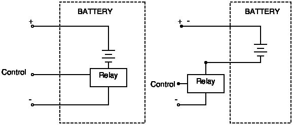

              If it works I wouldn't worry about it. There's more than one way of skinning a cat and battery chargers are no exception. Just an example, imagine the charger uses a relay (it would be electronic rather than mechanical) to disconnect the battery when the positive line rises above a certain voltage.
              The relay can be inside the battery, in which case there are three wires (left circuit), or outside the battery, in which case there are two wires (right circuit):
              This is just an example. Unlike a car battery and NiCADs etc, modern rechargable batteries are often stuffed full of electronics. Rather than an external controller in the charger deciding when a battery is charged, the battery either cooperates by signalling internal state back to the charger, or takes over entirely. Batteries and their chargers range between plain stupid (like my car battery charger), or highly intelligent like the battery in my newest laptop.
              So the two wires on the Parkside might mean:
              1. Manufacturing error (in which case it either won't recharge or run the motor) , OR
              2. Cost has been reduced by simplifying the battery and charger. The long-term effect would be reduced service life. OR
              3. The battery has been upgraded so it doesn't need a control wire. (This isn't unlikely, because the charger will be based on an integrated circuit, and is likely clever enough to handle two wire thicko batteries, three wire semi-smart batteries, and brainy two wire batteries.)
              Signalling has moved on; for most of my life extra wires were necessary to control equipment. Not so today – it's quite common to find devices exchanging control data over power lines, or a bus. Conversations are decoded by microcontrollers which can read sensors and operate switches to make stuff happen. No need for lots of wires.

                              I have just got my 12V Team angle grinder out of the garage for a look, and it is the same as yours, with the + and C- contacts in the charger which connect with the + and T on the battery, which also has a – connection. Confusing isn't it. Take the end off the battery and the circuit board is exposed.

                                  That third symbol looks like it indicates "insertion" (oooh er missis!) does it perhaps turn on the charger as you push the battery in?

                                      It is the symbol found on a lot of illuminated power switches. You've probably seen it before but not thought about it.
