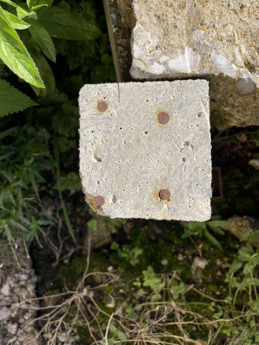

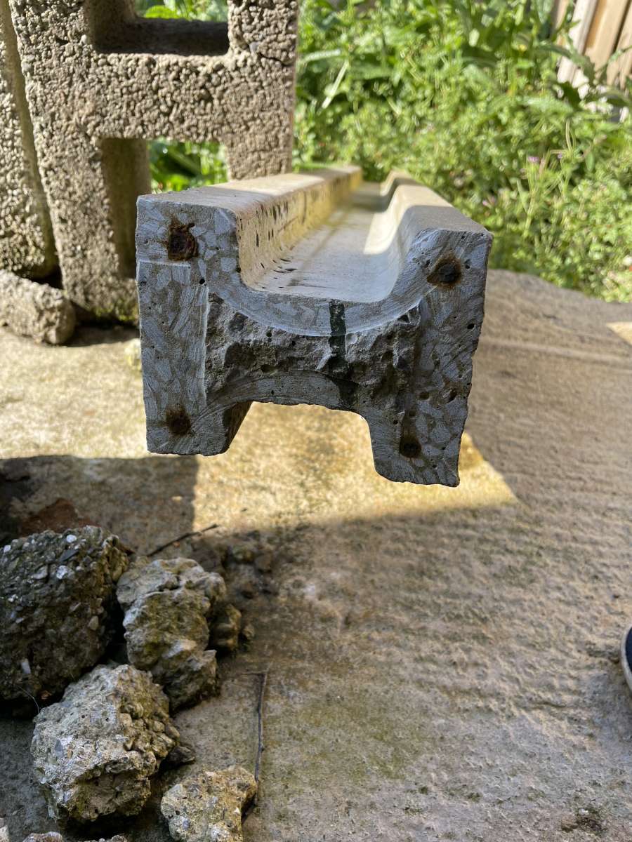

      Gents it would be very useful if I could drill holes it a single slot concert fence post, where is the reinforcing normally would it be either side of the slot ? also what type of drill bit would be best for the job ?

        So … to partly answer you question: The posts that I cut recently had four rods, spaced a little in from the four corners.

            There are often 4 thin wires in posts aranged in a square so drilling through the middle is generally OK if you want to fix a post to a wall

                Two examples:
                IMG_0184IMG_0183

                  If you have an SDS drill machine be careful ! My Bosch hammer has a force of 4Kg. The impact may shatter the post then you will know exactly where the reinforcing rods are. SDS bits are sharpened / formed as a chisel edge NOT a cutting edge, great for drilling holes in concrete that is a big lump but for more fragile concrete not so clever ! An ordinary hand drill with so called hammer action will be slower but less violent. Good luck . Noel.
