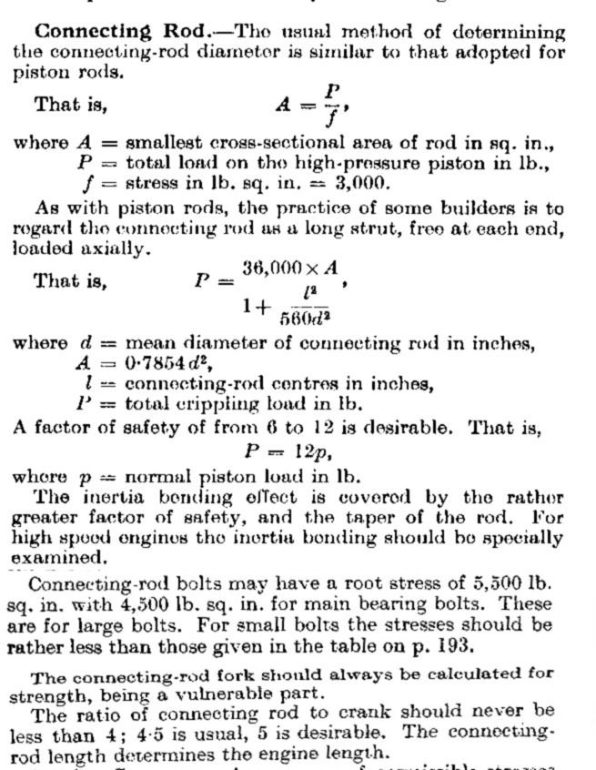

                                            Not perhaps a response to the original post, but there's an interesting section in The Engineers' Pocket Book of 1943 covering the design aspects of steam engines. (A fascinating little book despite its age & useful for diagrams of locomotive ancillaries such as lubricators, vacuum pumps etc).
                                            In the part covering connecting rods with its formulae for determining rod diameter, it states "The inertia bending effect is covered by the rather greater factor of safety and the taper of the rod". From which, I suppose, it might be inferred that a fish-bellied rod having two tapers, is stronger ~ as Martin Kyle comments.
