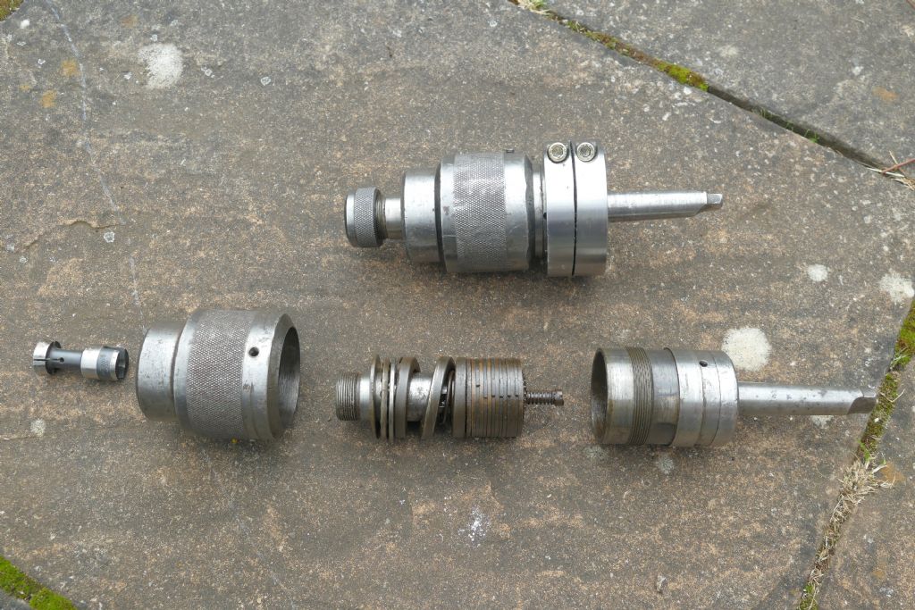

                  I've got these two MT2 tapping chucks that have adjustable slip and are sprung both in and out of the body. It makes power tapping in the lathe easy up to M12, I've not tried anything bigger. I have some spiral machine taps for the bigger sizes and the swarf just comes out like you were drilling a hole. I put a split collar on one to stop the taper slipping in the tail stock when used for bigger sizes. I didn't buy these as new so I don't think I would be able to justify the cost for them if that was the only way to get them. I don't have a full set of collets but do have some Snap-On tap driver sockets that are easily modified to fit, they just require skimming to a slightly smaller diameter and a slot for the drive pin. the basic principles are quite straightforward and I think a home brew design could be made.

                                Power tapping with a tapping head. The knurled ring allows the torque at which the clutch slips to be adjusted. If tapping a blind hole for instance the part holding the tap will start to rotate rather than strip the threads. I did a test on the other end of the plastic to set the torque high enough for it to tap in plastic and drive back out, if I left it at that setting it would not tap metal.
