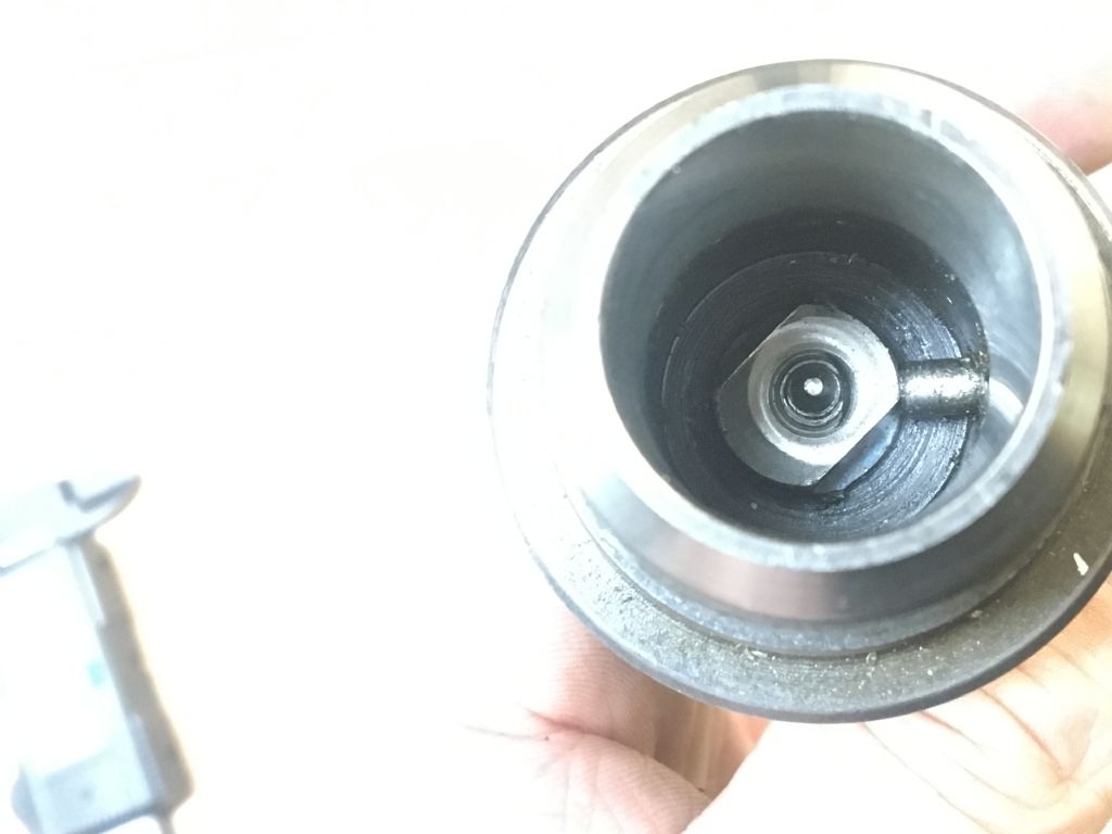

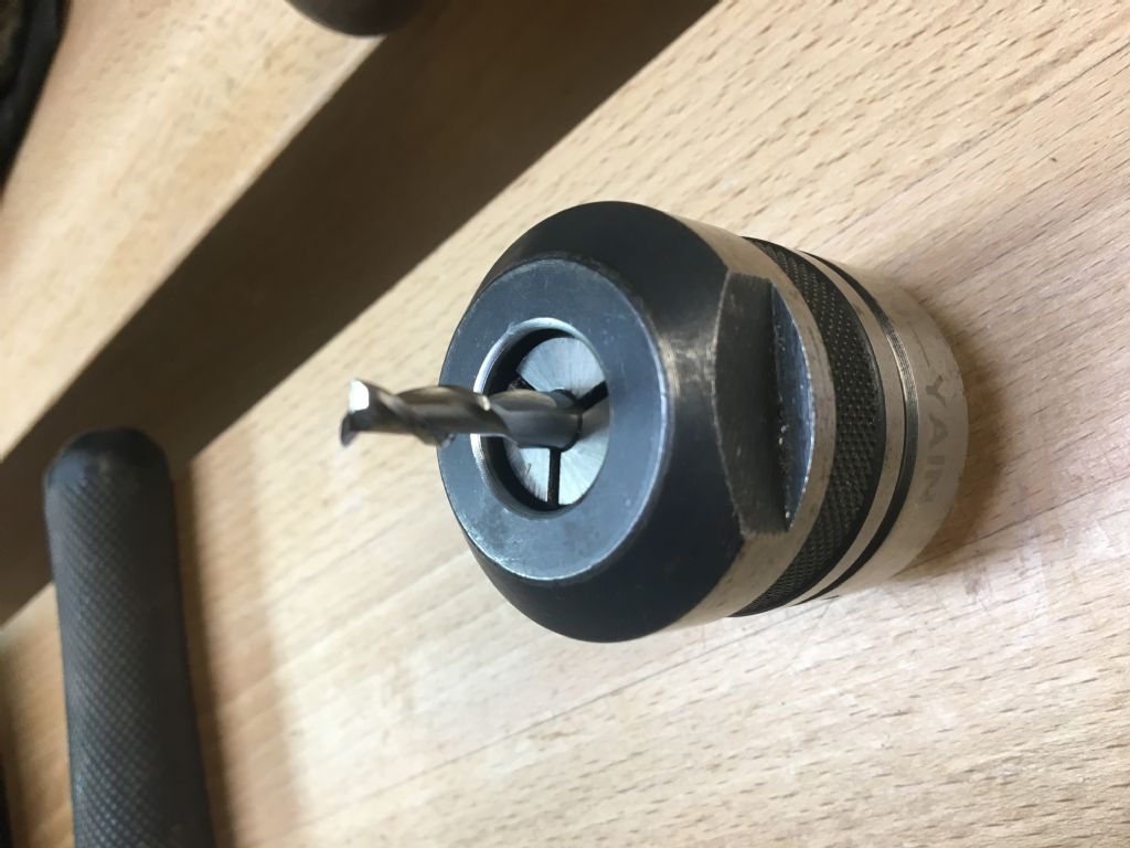

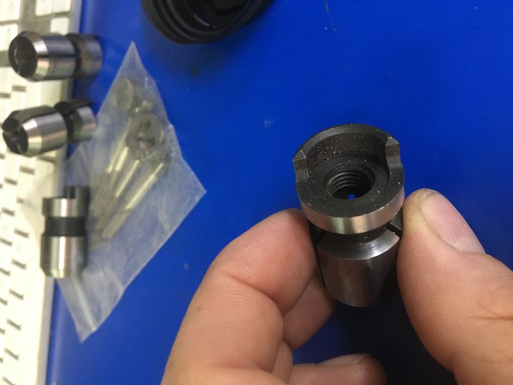

      img_5419.jpgHi Im new to milling and have bought this fb2. The collet and collect chuck that came with the machine seems to correspond but when I tighten the arbour/ chuck the 6mm collet and 6mm endmill are still loose, does anyone have advice where i might be going wrong?
      the colets i recieved are a mix of imprial and metric.
      If I need to buy a different type of collet chuck can anyone reccomend sutable? I did think about just going to Morse taper 2 style to add height but for now Id rather use what i have as money keeps flying out for other needed equipment.

          What is the size marking on the collet you're trying to fit the 6mm shank into?
          What is your procedure for tightening down the collet on to the endmill?

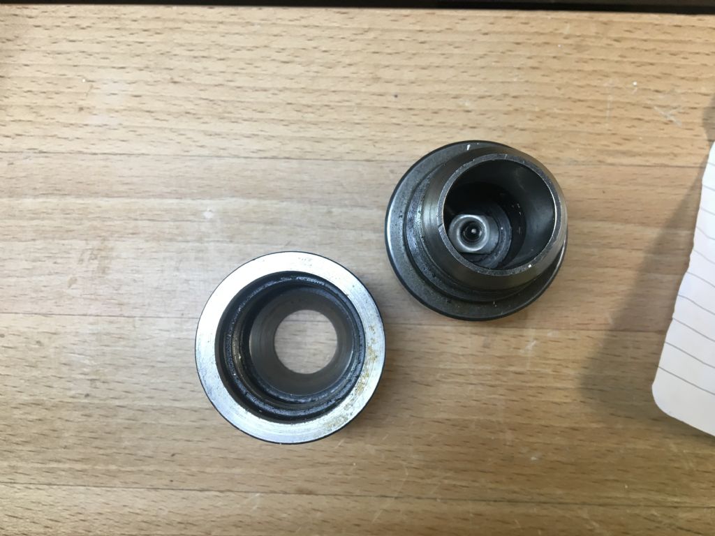

            That looks like an Autolock-style collet chuck designed to hold only the appropriate screwed-shank cutters – it won't hold a plain shank cutter.
            May be wrong – just trying to interpret the images! The body looks as if it has a centre point at the back which is a key part of the holding mechanism.
            On the other hand, with the right cutters, these are probably the most secure collet chucks you can get! There is a correct way to install cutters into these chucks, but let's make sure we know what we are looking at first.

                The collets have a threaded bore to suit threaded shank tooling. They will not close down on a plain shank tool. You need something like this. The centre drilling fits over the point in the back of the collet holder.

                  As said looks like an auto loc type Have the collets got a thread in the hole ? There are 2 sets, metric and imperial. Noel

                    I don't think they can be like ER collets as they have a circumferential groove at the point where the front and back tapers join which engages with the eccentric ring in the nut. I agree that it looks more like an Autolock-type. An angled view of the back of a collet showing any internal screw thread would settle the matter.

                      It's a Pozilock collet and holder. A Clarkson Autolock work-alike made by Vertex. Threaded shank cutters are a requirement and collets are available in metric and Imperial.
                      The likes of Chronos, Warco etc. sell collets.

                        Right! The thread is needed to make sure the collet is pulled hard against the internal taper. AFAIK Arc don't sell Pozilock though Warco do. Largely superceded by ER I think.

                          When clamping a cutter, if you judge the setting point of the cutter against the centre pip correctly, when fully tightened, the taper inside the closure nut seats against the corresponding taper of the main body. This ensures excellent concentricity and rigidity.

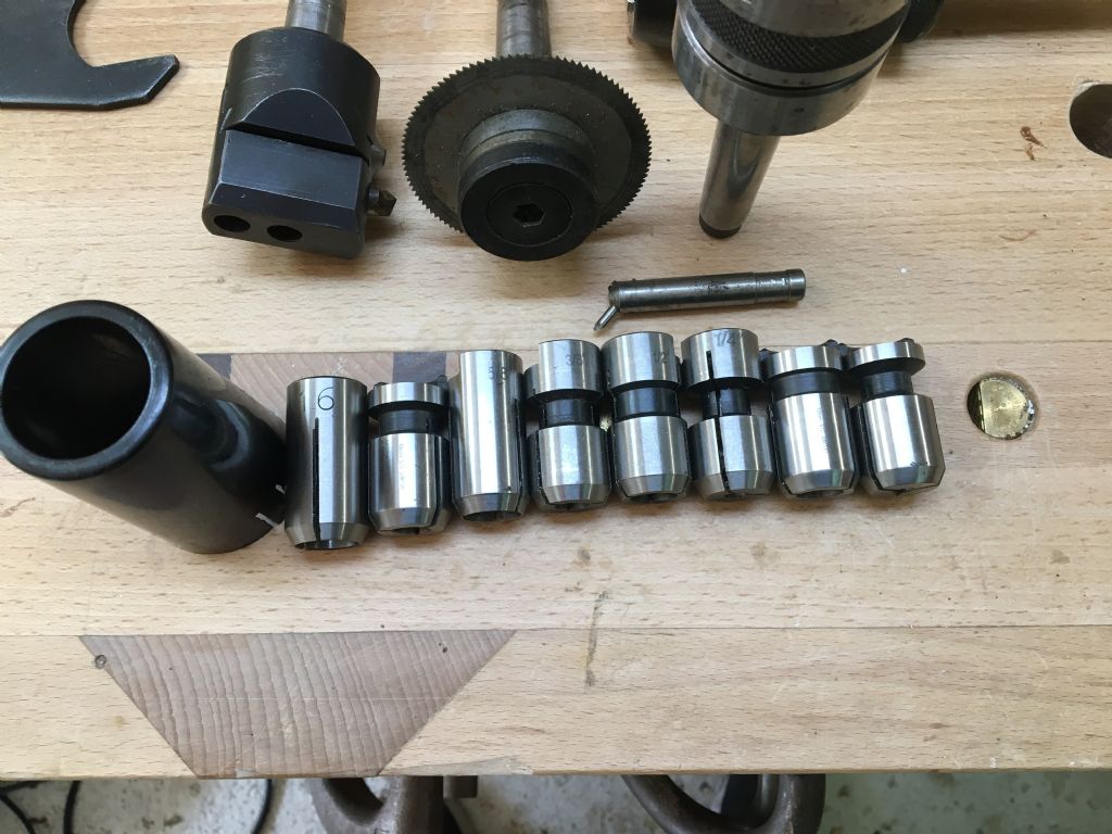

                            The big advantage with screw loc cutters is that they cannot walk out of the collet and they should self tighten. The disadvantage now is that they are out of fashion compared to fifty years ago and so the selection of cutters one can buy is less. Tracy tools also sell the cutters as do other suppliers.
                            As the OP has eight collets I assume he has a full set, both imp and metric.

                              Also note that this type of collet is far fussier than ER ones regarding diameter.
                              You must match like with like: a 1/4" collet will not grip a 6mm dia cutter shank, for example, although that is not the primary driving grip.
                              (It would be cruel to expect any collet system to cope with that huge mismatch, of course, but the screw-lock types are very much right-diameter only, even on the closer matches.)

                                      Hi heres a few more pics to help clarify on what i ight have.
                                      It came with a 1/4 3/8 1/2 5/8
                                      6, 10, 12, 16 mm
                                      there are threads in the collet which i believe reflect the collet size for each bit.

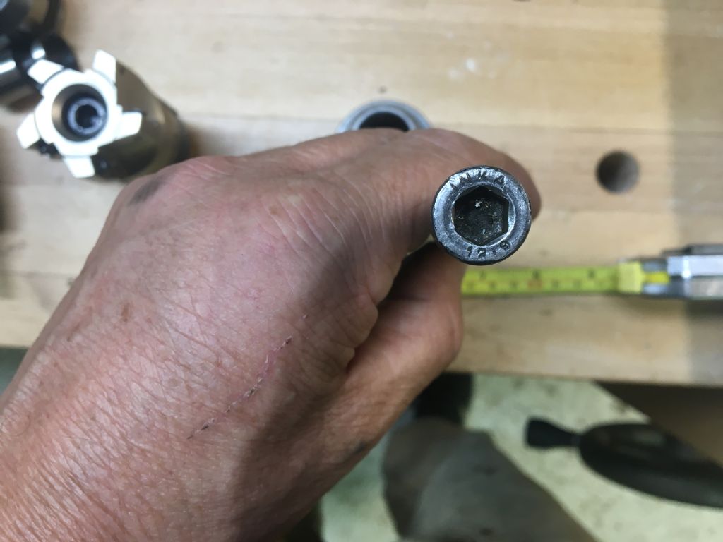

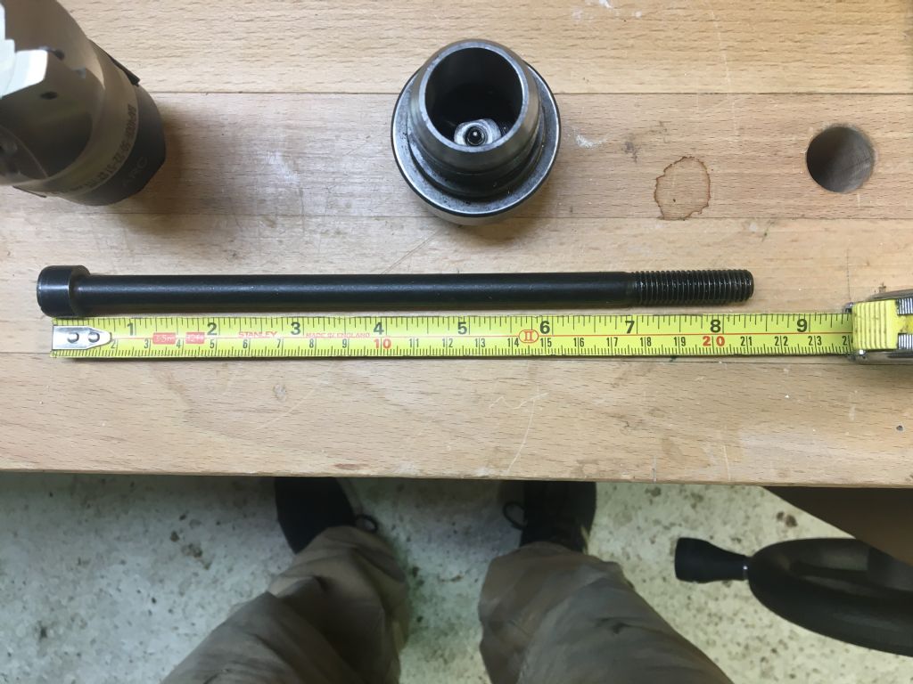

                                      Understood about the fitting the collet holder to the stem first unfortunately ive now found out that i have two thread systems with my chuks and holders. I have metric m10 1.5 alan key rod with the machine which fits my new facing end mill but doesnt fit any of my other collet holder chuck, and slottin chuck.
                                      so if any one knows the correct thread size id appreciate a link. see pics below its 210mm long.im guessing 3/8 16?

                                            That nicely confirms what you have been told yes

                                              3/8 x 16 sounds as if it mignt be 3/8 BSW which was the "standard" thread for drawbars in the Imperial world, until comparatively recently.
