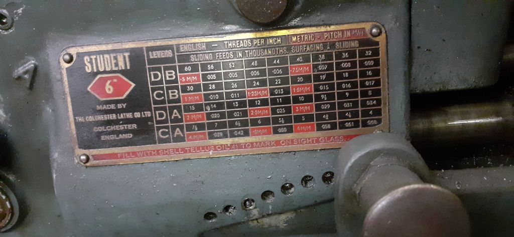

        Hi all,
        Firstly, glad to finally join the forum after years of lurking! I found myself tonight questioning a situation with my student lathe and thought 'right, its time….;
        The lathe was an eBay purchase and definitely has a 'history'. I've put off doing any screw cutting with it until tonight as I have access to better machines at work on the rare occasion I need to do any. At some point I had to have a crack and see how it got on, but to my frustration (definitely not suprise), I found that it didn't cut a TPI as I wanted it to. After stripping off the change gear cover I found that is runs a 24T drive gear, through a 120T intermediate gear, to a 45T driven gear, with no other spare gears at all. Balls.
        My first question to myself is, why? The lathe has a very nice selection of pitch options as standard! It just seems like hard work working anything out now. I see companies selling aftermarket gears give plenty of options so I must be missing something here (usually the case).
        My second question is, would anyone out there have a set of original 42/35/21T gears that they would part with? Or even just a 21T gear?
        Many thanks in advance!
        Drew

              #455229
              Ian Parkin
                @ianparkin39383
                Dc31k
                Certainly on my Colchester student the 21 t is the driver for 4 rows of threads and feeds
                the 42 is for 1 row of faster feeds and lower tpi’s
                this with a student with a gearbox on as the op’s
                Edited By Ian Parkin on 03/03/2020 19:12:37
                Edited By Ian Parkin on 03/03/2020 19:13:49

                  Jason – The thread I was aiming for was 16tpi, but with the 24 / 200 / 45 tooth arrangement that is fitted to the machine it came out way off, I didn't measure it as I knew whatever the case, it wasn't right. Someone probably had a method to it, but its turned out a bit of a pain and expense to me!
                  DC31K – Hopefully I can sort out some original gears (and I think I have a lead on what I need which would be nice, but its going to hit me nearly £100). I'll certainly pursue your suggestion should i find myself in a pickle though, thanks for that! With regard to your 2nd post, the manual says the original set-up is 21T driver, 200T intermediate and 42/35T driven gears.
                  Ian – my plate isn't the same as yours. Mine is all in one block (no extra line/mention of 42T) 87506801_190416325573605_8443135478860873728_n.jpg
                  Thanks for the input!
                  #455245
                  DC31k
                    @dc31k
                    Looks like there were a couple of different versions produced. The Student is quite a long-lived machine so changed through the generations.
                    Drew's plate is the same as the bottom four lines of Ian's plate, so is missing some of the finer threads.
                    It is interesting that Colchester did not provide for standard M12 1.75mm pitch threads on either machine. The same omission is made on the Chipmaster.
