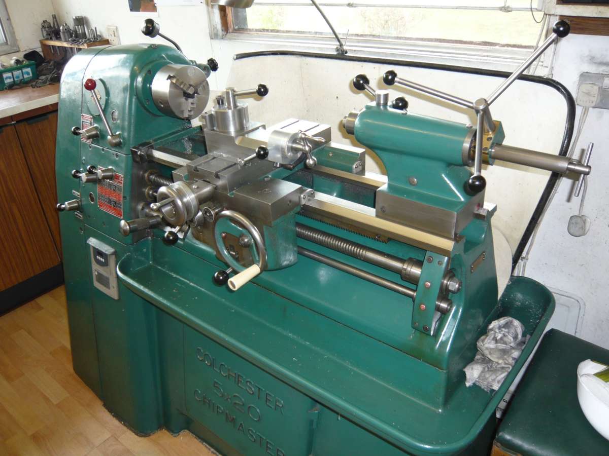

      320mm test long bar, ground 25mm diameter, centre drilled each end.
      Testing points – 10mm from each end of the bar, and traverse between.
      Measuring gauge – Mitutoyo 0.001mm digital dial guage with 10mm convex probe.
      I have a 1963 vintage Colchester Chipmaster lathe with an 8″ Set-Tru 3 jaw chuck and a dodgy tailstock. I trimmed the Set-Tru chuck until it was running true within 1um (half a tenth!). To be clear, this is purely rotating by hand and at no point did I start the motor. I’m sure the measurement would have worsened if I had, but it stayed stable rotating by hand through the tests.
      The tailstock measured 150um (6thou) out horizontally and -400um low (16thou). Centre drilling and drilling has got bad recently so I decided to do something about the tailstock. Like most tailstocks there are two parts, a base which you can lock to the bed as required, and a body which houses the quill. The horizontal error of the tailstock can be zeroed out by moving the body side to side with two opposing screws. It rides on a transverse key, in this case a body 90 degree Vee and a base Vee groove. The body is supported on the Vee groove at the front and pad at the rear, about 30mm long and the width of the tailstock, at the rear. There are also two small pads near the middle but the Vee and the main rear pad are the two places you can tailstock.
      There is an opportunity here to trim differential to remove any non-parallelism between the quill bore and the bed, but it seemeed ok here. I found some double sided adhesive tape on Amazon which is only 0.05mm thick (2 thou) so I decided it would be a lot less awkward to stick the shims to the base first, grease the lower surface of the body, and mate them. In this case I needed to raise the body of the tailstock by 400um (16thou). I thought I would be conservative and correct it by 14 of the 16thou and see how it looked. With 2 thou tape, it gave me 12thou shim for the rear. The front needs a little more thought. The shims are going on a 45 degree inclined surface (each side of the Vee groove). So the shim will lift by more than it’s thckness, so we need a thinner shim. School trig tells us the factor is sqrt(2) = 1.414. With the shim stock kit I had, I settled on 12thou for the back and 8th for the vee groove sides for a 14thou lift.
      I cleaned the base and body surfaces with acetone, guillotined the shims and applied oversize adhesive to them them and trimmed to size. Stuck each one in place and held hard for a while. Greased the body mating areas and reassembled. I now trimmed the side to side error as best I could. I fitted a ground MT3 centre in the tailstock, and I turned a 60 degree centre on a piece of ally bar in the chuck, and mounted the test bar between the centres. I fitted a 10mm diameter probe with a convex bottom to the dial gauge. These are good for smoothing out grooves and scratches, etc. I clocked the bar horizontally at the sides and vertically at the top, traversing the bar with the gauge holder fixed on the lathe cross slide. Luck shone on me again and the horizontal error along the bar was 1 to 2um.
      The vertical component which was our mnain target was down from 400um to 65um (about 2.5thou). If I was doing a lot of turning using the tailstock I may consider improving that, but for the majority of use which is drilling and centre drilling it is fine. The drill used to jump and make you think it would break but it’s fine now.

          Well done. From the factory the tailstock would have been set a thou or two high to allow it to come into line with wear. So a small amount of vertical error is not critical, as you have found.

              The bed certainly has wear. I’ve never tried to quantify it, but the edges of the bed that the tailstock and saddle ride on are just about discernibly low compared to the unused part. The wear is going to come from decades of sliding the saddle and tailstock up and down the bed. The saddle is a big flat object with a fairly linear moving force so should contribute fairly even wear. The tailstock gets pushed forward slightly digging the leading edge in, and then pushed back digging the trailing edge in. This is conjectured to lead to curved wear of the tailstock base and wear of it’s mating surface on the bed that is worse toward the average position of it. In practise, a lot will be down to poor maintenance. Fine swarf and grit on the bed and lack of lubrication will take it’s toll. No wipers on the tailstock either. Maybe I’ll put some TPU filament in the 3D printer and see what I can come up with.
              BTW, I did a rough test of the quill alignment relative to the bar and was pleasantly surprised. Same setup, I just moved the tailstock back and brought the quill forward to engage the bar again. This would also incorporate errors due to change in wear in different parts of the bed. From the quill reading zero, back to reading 80mm, the tailstock end of the test bar showed no discernible horizontal error, and only 0.015mm (1/2 thou) vertically. It really must have been my lucky day!.

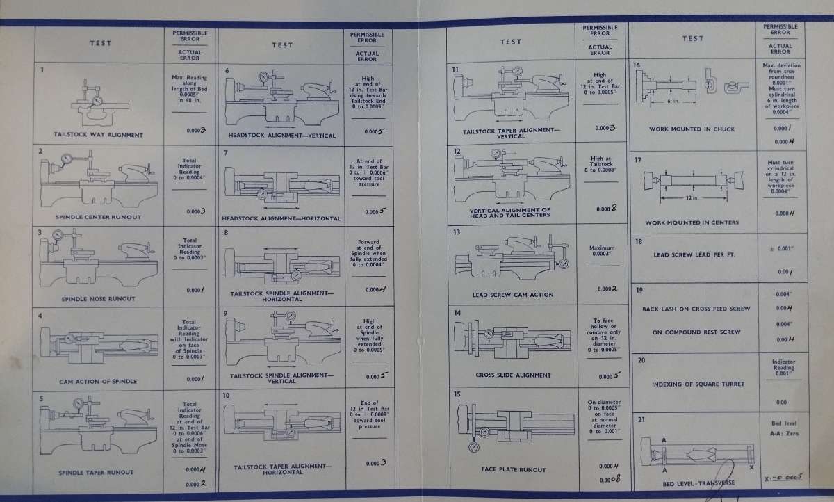

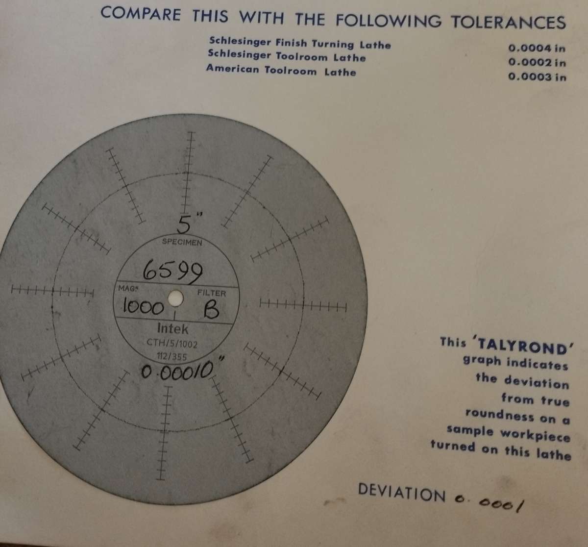

                    John MC
                      @johnmc39344
                      I’m finding it difficult to believe wear is the problem.  The saddle and tailstock work on different parts of the bed.  there is near zero load on the tailstock when its moved so will not wear, unlike the saddle, so wear is extremely unlikely to be a problem.
                      I would be looking at for other reasons, distorted bed for instance.
                      My Chipmaster is a mid-1970’s machine, was there ever a change in bed design?
                      For interest, attached are the accuracy charts for my machine.

                        I had a similar problem with my Chipmaster. I added a 6 thou shim at the 45 degree guide this then got the tailstock barrel parrallel to the spindle axis but it was still about 6 thou too low. I then made a No 3 Morse taper male insert and bored a No 2 Morse taper female hole in the male Morse 3 insert, the Morse No 2 bore was offset 0.015″ eccentric. This was  the inserted into the Morse 3 tailstock barrel and rotated to match the vertical spindle centreline, then it was pulled into the tailstock barrel by a hollow bolt. The horizontal adjustment was made via the normal adjustment setting. This gave me a Prefered Morse No 2 tailstock because all my parts from my previous lathe were No 2 Morse. I also added a rack drive to the tailstock.
                        Alan
