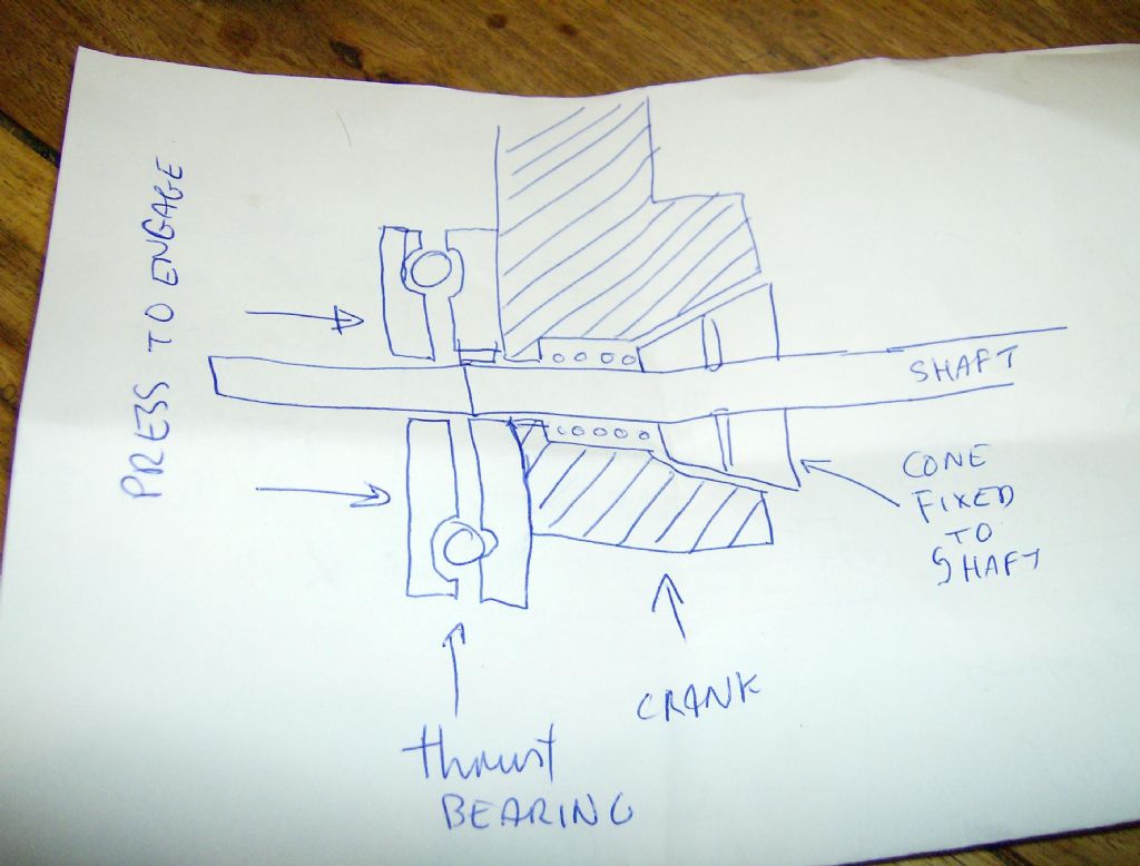

            Sub Mandrel
              @submandrel
              What about having a cone clutch on the crank, with a release spring inside. Have a thrust bearing with a suitable lever to allow you to push the crank onto the cone and start pushing:
              If you need to transfer more force, replace the cone with a dogged clutch. I do realise (now) that the bearing and leave would need to be arranged to push the crank outwards, so they don’t foul the push rod…

              Peter Bell
                @peterbell11509
                Thanks for the sketch, I think that would be ideal if the shaft revolved but it pushes. I have a picture of the rod but I am dont know how to put it in the reply like you did?

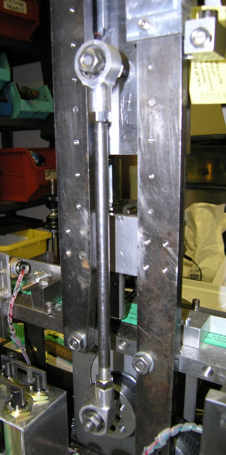

                      Peter Bell
                        @peterbell11509
                        Hi Neil,
                        Thanks for the advice, here is the rod in question.
                        It is driven from the crank at the bottom and pushes a numbering head up and down  mounted on linear bearings on the other side.
                        It is difficult to disengage the crank as there is also a pully mounted with it which drives other parts.
                        Odd I know but I thought there is bound to be someone out there who has done this before?
                        Peter
                        #60138
                        Sub Mandrel
                          @submandrel
                          Perhaps a strong spring in the pushrod, and just clamp the head.

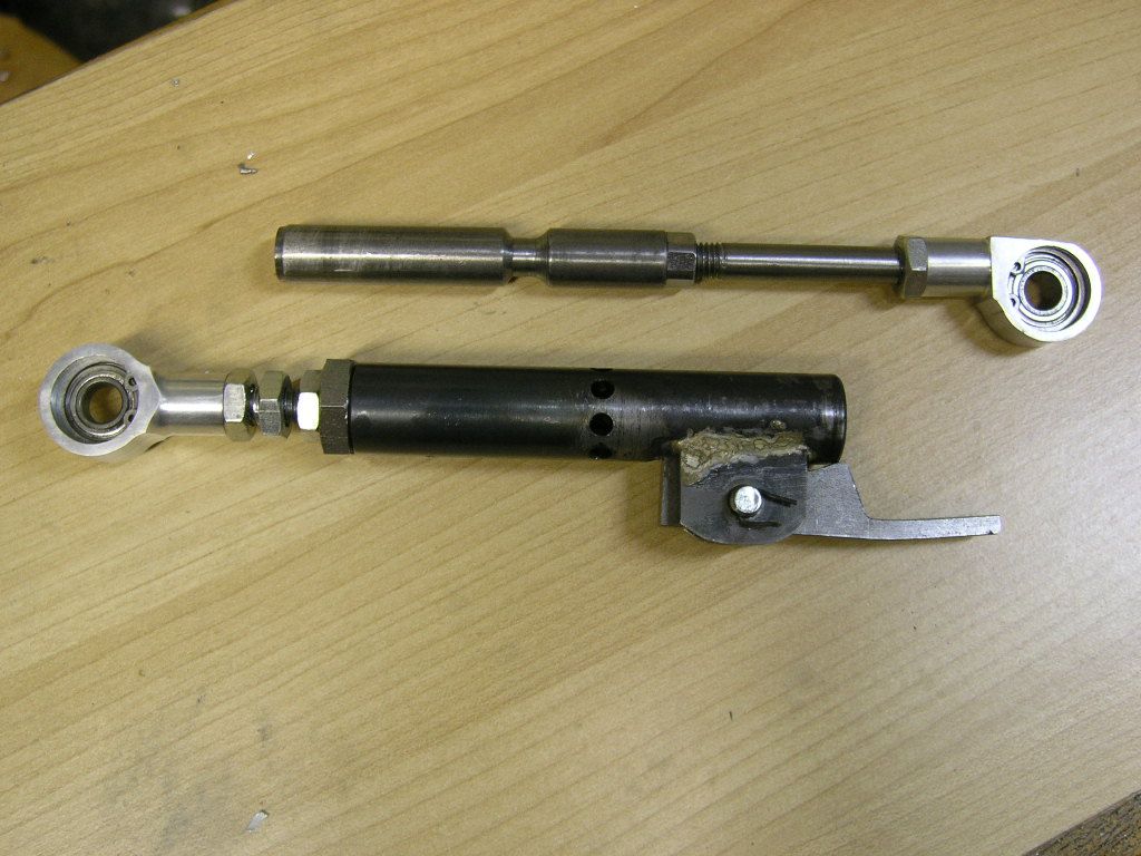

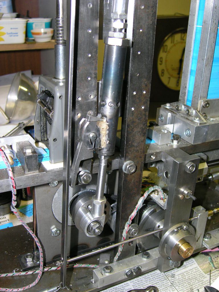

                                Peter Bell
                                  @peterbell11509
                                  Hi,
                                  Just an update on my rod link/clutch. Made a rod and sleeve with a pawl. The two are locked together until tripped by another  solenoid operdated rod which disengages the drive. I have some electronics to sense when and it it needs to do this.
                                  To my surprise it seems to work fine!
