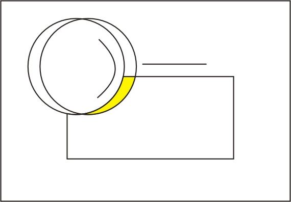

      Either the spindle is running in reverse or the photo has been flipped horizontally. You can best see the orientation of the teeth at top left.
      Phil
      #207007
        The photo hasn't been flipped, in the original you can see the headstock of the lathe in the background (it's on an old lathe with a milling attachment).
        The end will always have approaching 'zero' thickness if climb milling (not sure where the arrow heads went – clockwise cutter moving right to left) …

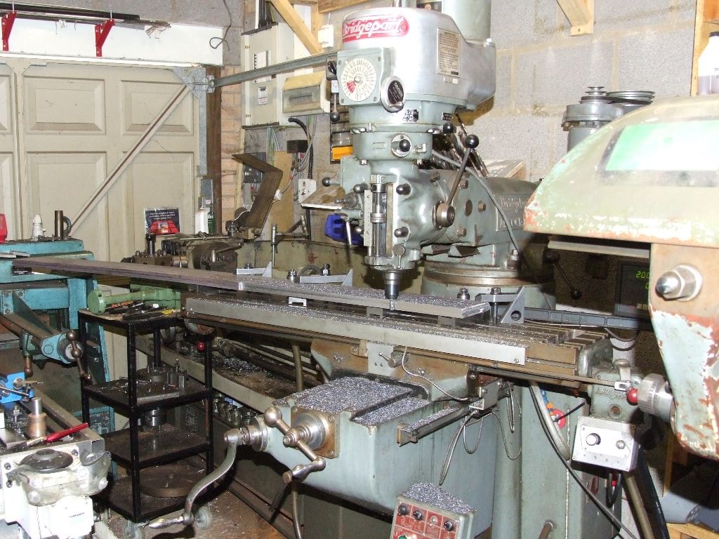

          Can't say I've ever heard the reason for climb milling to be at the chip exit, but I'm not going to gainsay the Sandvik paper. Another reason given for not using conventional milling is that at the start of the cut, where the depth of cut is very thin, the cutter doesn't actually cut. What happens is that the cutter deflects slightly and rubs the cutting edge on the work until the forces build up and the cutting edge eventually penetrates the work. The rubbing does the cutting edge no good at all, and for those materials that work harden creates a very hard thin layer, which makes it more difficult on the next pass and so on. That information also came from a Sandvik paper.
          On the CNC mill I normally used mixed milling for roughing and make the final profile pass climb milling. On the vertical manual mill I use both methods interchangeably. As Murray says once your over about 60% radial cut depth it makes no difference. For small radial depths of cut I normally use a bit less depth for climb milling. Here's an example:
          The cutter is 10mm three flute carbide cutting full depth (20mm) per pass. Conventional milling was with a 1mm doc and climb milling was with a 0.5mm doc. No way I'm winding that lot back just to avoid climb milling. The Bridgeport has oodles of backlash, about 15 thou, so if needed I do add a little drag with the table lock. However, I have also found when the cutter does grab It has never broken, at least not so far. Which just goes to show that we're probably pussyfooting around with small feedrates.
          I do not climb mill on the horizontal mill, despite the fact that it has a proper backlash adjuster, although it doesn't seem to work. Given that the table probably weighs 400+lbs I'm disinclined to take it off to see why.
          One material where climb milling most definitely doesn't result in a better finish is plastic.
          I always use keys when horizontal milling, irrespective of the type of cutter. I cut under power feed so in the event of a jam I'm not going to able to knock the power off quickly anyway.
          Nobody seems to have mentioned a rather more fundamental problem with set up shown. The slitting saw is fine tooth, but is cutting a thick piece of material. That is just asking for the gullets to fill, jam the cutter and bang, a shattered cutter. Much better to use a coarse tooth slitting saw that is designed to take deep depths of cut.
          For the record I am not offering to write an article; much too controversial. wink 2

                      Actually 4 stacked lengths of nominally 3/16" thick hot rolled steel. Careful examination will show a 'step' near the lefthand table clamp, as the table travel isn't sufficient to machine the total length in one pass. The carbide cutter was retired after use, but speeds and feeds were such that it was running dull red.
                      Having just been using the Bridgeport to make some copper busbars I 'measured' the backlash, rather than try and remember. Backlash was estimated by turning the handle one way until there was movement, zero the DRO and then move the handle the other way until the DRO changed. Results were X axis 0.7mm and Y axis 0.9mm. They'd probably come down a bit with some TLC, but basically the mill is pretty worn. Can't say it worries me, and I'm happy with the work that it produces.

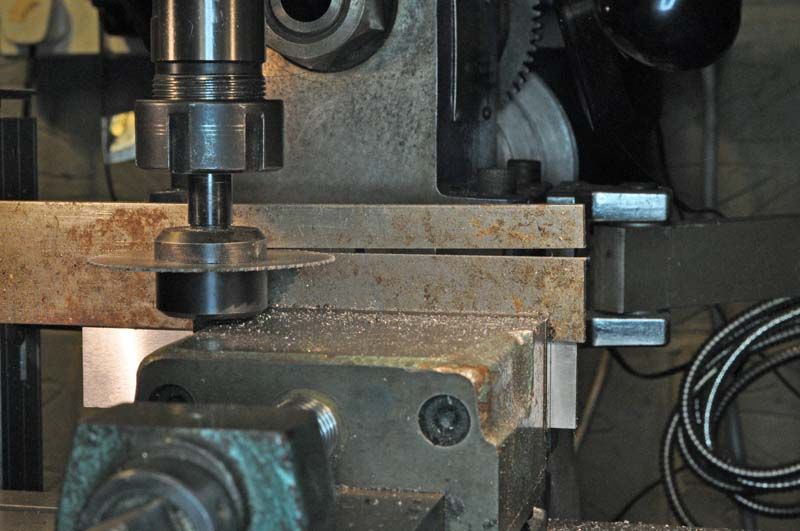

                          I use my slitting saws in an arbour with a half inch parallel shank that I mount in an ER collet on the mill. Consequently I tend to put the saw in the arbour first, usually holding it up side down in the vice. It's pot luck whether I get the saw in the correct orientation blushbut since I put a VFD drive on the mill I can easily reverse the direction smiley
                          By chance, I think I got it right in this photo. As an aside, it clearly demonstrates the result of releasing the locked in forces in BMS.
