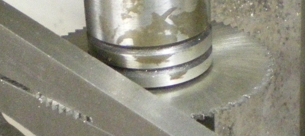

        I've just had an email about picture 21 on page 70 of the current issue, criticising the use of a picture that shows climb milling.
        Now, aside from the fact that close inspection of the picture will show this isn't the case, I'm aware that opinions on climb milling vary hugely. Mention the subject and you can be sure:

                I think it's plainly obvious that the slitting saw is not climb cutting. I'm more surprised that someone hasn't commented on the workholding. There's very little material actually held in the vice jaws and with a substantial slot already in the workpiece I would have thought vibration/movement of the work would be more of an issue here. That said, the author is demonstrating what can be achieved with the equipment to hand. Overall I think this is a very well written and presented article.

                  Neil/Graeme what can you see that I can't as it looks like it is climb cutting to me. Unless the blade is mounted so the spindle can run in reverse

                    Doesn't everyone have reversible spindles? That one is going anticlockwise.

                      But won't the blade retaining screw be at risk of comming undone.

                        Can't see what thread was used might be L/H, anyway, cutter will probably have a key?

                          I can't determine the tooth form to see whether that is climb milling or not. Certainly you can install a slitting saw so it cuts clockwise or anti-clockwise. May not be best practice to run it the "other" way as Jason says. Not sure I am brave enough to climb cut with a slitting saw though.

                            Yes suppose the author may have left and right hand threaded arbors. I thought running slittingsaws with a key was more of a taboo than climb millingwink 2
                            J
                            PS can anyone confirm which way the blade is facing as the digital mag is not clear enough to see the teeth

                              From what I can determine on my ipad (and in the printed mag) the spindle must be running anticlockwise as the saw appears to be installed to cut left to right as you look at the image.
                              As for the arbor, it is quite feasible that it has a LH thread retaining screw. I have arbors with both LH and RH threads.

                                Tooth form can be seen but you need a magnifier unless you have rodent eyesight.
                                                  Exackertaly!
                                                  #206996
                                                    I was hoping you would all rush out and buy a paper copy!
                                                    Right click and view image if it's a bit small.
