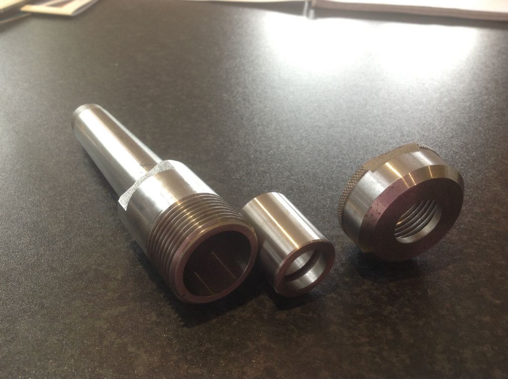

      image.jpgGot one with a mill I bought but no idea how or what type of bits fit, I have an S type clarkson on mt2 but this is not the same, please see photo, and if you can post photos of how it work.
      rob
      #22809
      Robonthemoor
        @robonthemoor
        How does it work?

          Hello Rob, it seems that the two smaller items, if combined into one, would perform the function of the Clarkson nosepiece, apart from there being no obvious driving dogs. At any rate there would be a need for a collet to hold the tool, which would be tightened by the short taper in the central piece illustrated. I take it you have no collets ?
          Regarding potential tool slippage, are there any driving lugs or similar buried up in the main body ?
          Sorry I can't really help, I've not seen one like this, but I'll bet there are members who have. Hopefully they will come forward and shine the necessary light. Good Luck !
          Ken.

            Thank Ken, yes two driving dogs at the bottom, & no I have no collets. I think it is a C type! But would like it confirmed before I start buying collets that don't fit. 20mm or 3/4 OD collets would fit.

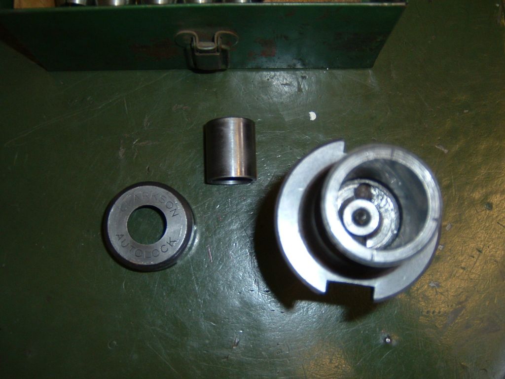

                A picture of the internals of the chuck body would help identify the type of collets required. It looks like a Clarkson C-type; does it have 'Clarkson' engraved anywhere?

                  It looks too new to be a c-type!. Posilock perhaps. There are several ‘own brand’ versions of that eg axminster. The sleeve looks unusual as there is no taper either in it or on it and the groove is for what?
                  Could it be for something else – like part of a sliding tapping fixture, or tailstock die holder-holder.

                    I will take a photo of that sleeve you can see, and yes it has a taper, also it says clarkson Autolock On It and a part number, when I get home I will post photo & number.

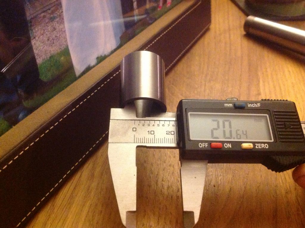

                      I've just checked my Clarkson "C" type chuck and it looks the same as your's, apart from mine being a bit more battered on the outside. Mine is stamped quite clearly Clarkson Autolock on the face of the closing nut.
                      The collets that I have for it are all in the region of 20.64 – 20.65 mm od so well over either 3/4 in or 20 mm. They need to be a good sliding fit in the sleeve as this helps with the concentricity, and the sleeve is a VERY nice sliding fit in the body. I also have 3 collets that I've picked up separately that won't actually go into the sleeve, being slightly oversize on diameter. One of them is just 0.01mm too big so should be possible to get it to size fairly easily, the other 2 are more like 0.1mm oversize so more of a problem as they are HARD. It may be that those are for another make of chuck that uses the same principle, so be careful when you buy collets. If you can take the sleeve with you to try the collets for fit. Also good luck with finding metric ones, they seem to be VERY thin on the ground.
                      None of my collets are marked in any way with a trade mark but a number came with the chuck so I don't have any real reason to assume that they are NOT of Clarkson origin.
                      The sleeve for my chuck also has that groove, it's there as an undercut for where the nose taper meets the parallel outer diameter of the collet, so it avoids any "hang-ups" in that corner and also helps to minimise the effects of swarf or debris that gets in there so it doesn't affect the closing and centrering action.

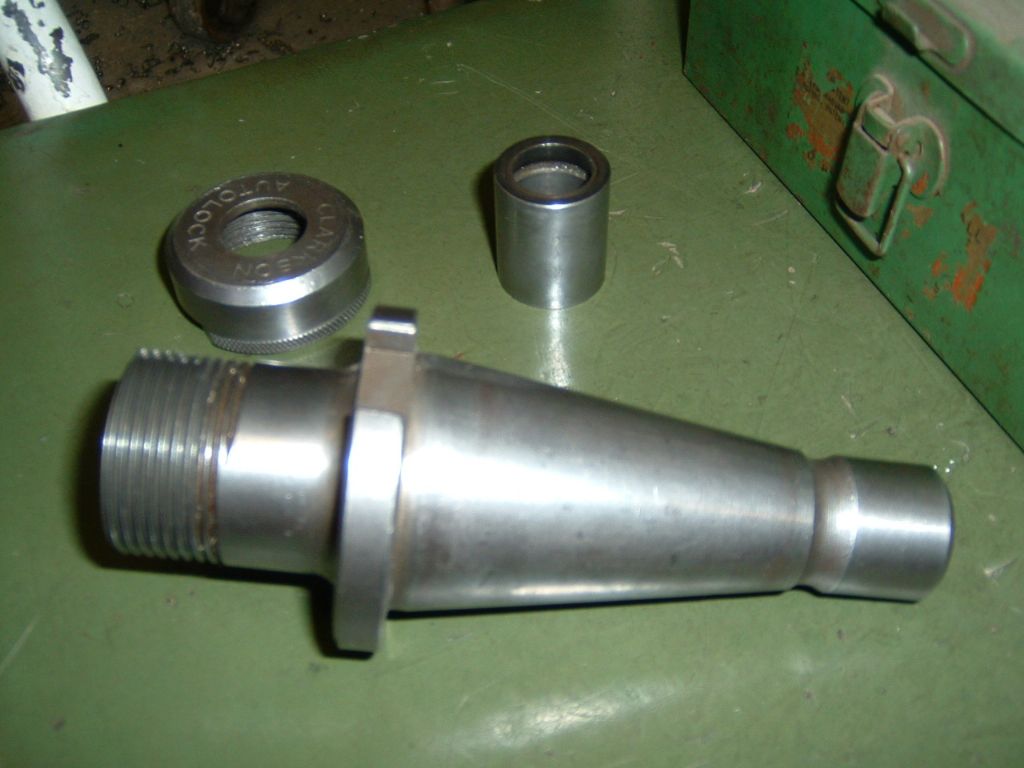

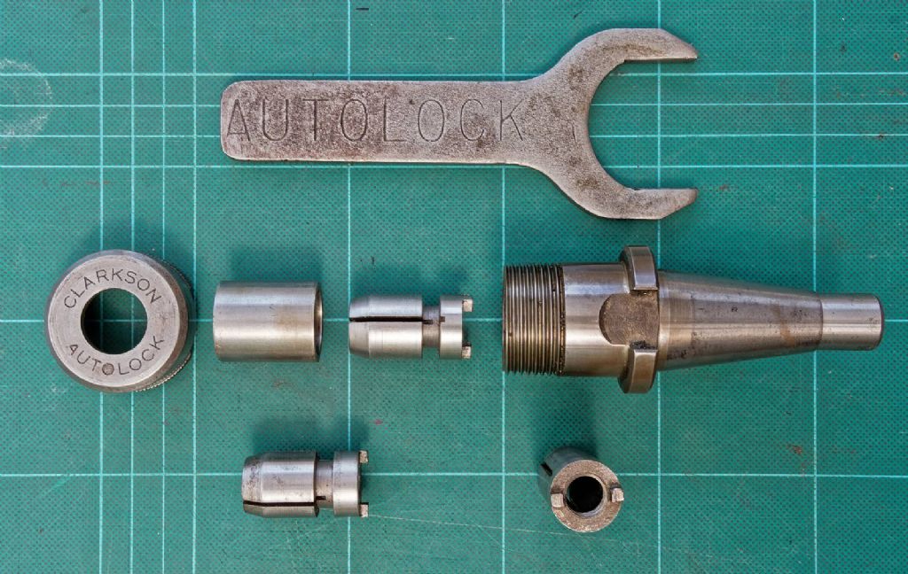

                        Hello Rob,
                        Here are some pictures of a Clarkson "C" type ? chuck that I've got, the collets are all 811 thou in diameter, the metric ones have an identifying groove around them, all collets have two locating "dogs" on the top end,
                        There are 1/4 , 3/8 , 1/2 , and 5/8" , also 6mm , 2 x 10mm,1 x 12mm and 1 x 16mm,
                        The lot can be yours for £ 40 if they are any use to you, I'm in Bucks. ( collection only )
                        All collets are in very good condition. ( nice original box as well )
                        Richard.

                          image.jpgThanks Keith all very good points' mine measure 20.64mm inside that sleeve too, & yes it looks like yours.
                          Richard, you have a nice set"and yes" I would buy them as at the moment I have none to fit. I do have a set of clarkson s type, and a reducer from mt4 to mt2 , so I can use it in my deckel fp1. Can I convince you to take them down to the post office! if I give you my address? I'm up in Lincolnshire, fair way down to you in Buckinghamshire, give it some thought with the post.

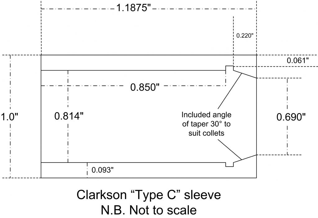

                                            Thanks Bill. I guess I should start by making a sleeve then. If you have dimensions for the sleeve that would been much appreciated. Unfortunately I think making a collet from scratch is beyond me: I only have a micro lathe with no screw cutting or cross slide capability.

                                                  here you go, I hope this reproduces/prints OK
                                                  I don't have a CAD package, so this was a quick sketch in Visio and reproduced as a jpg
                                                  N.B. it is not to scale.
                                                  The 30° angle is as close as I could measure it, but obviously to suit the collet. I came up with 15° per side.
                                                  If you need any more measurements, just shout up.
