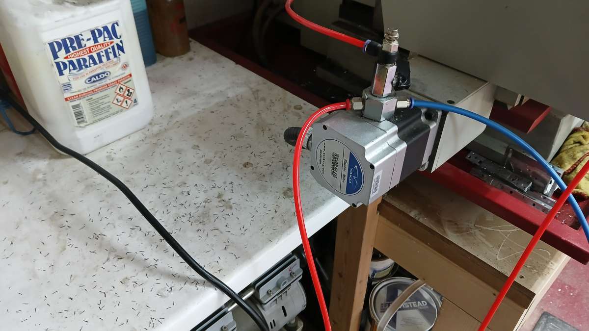

          #794371
            Dave I use air on the CNC not really for cooling but to just keep the area around the cutter clear of swarf. I only use a low pressure and not too large a flow rate otherwise it will just increase the problem of spreading the chips downwind.
            IPA is the one to add to the air if you want cooling with the bonus it does not leave you with a pile of wet soggy chips which nobody wants.

              #794386
                The likes of Datron have extractors on he enclosures so not really a problem particularly as the MQL systems use such a small amount it would not even go above accepted levels, you are looking at a few mls per hour. The liquid is feed into the air supply not sprayed from a can.
                My own MQL which I use with a neat fully synthetic cutting fluid delivers about 10 to 30mls per hour and I generally use it on the lowest rate.

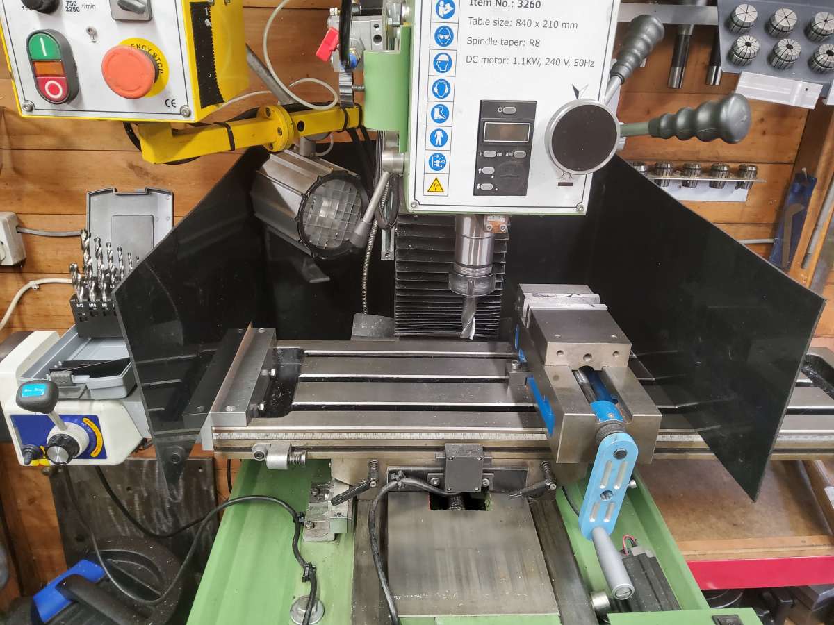

                  Hollowpoint
                    @hollowpoint
                    I like This guys approach. I’m sure something similar could be made for a bigger mill, perhaps using perspex.

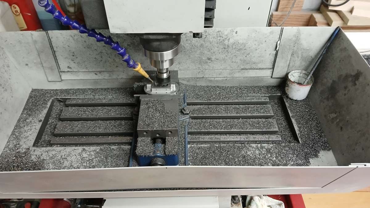

                    #794499
                      That is similar to how the trough on my CNC works. It will catch 99.9% of the chips from a standard cutter and a fair bit from the face mills provided the work is not too far up from the table. Though with 96 similar cuts to this one I did need to scoop out the shavings with a dustpan after every couple of cuts.

                          #794567
                          Vic
                            @vic
                            I did try fitting some clear plastic screens to contain the chips but I gave up with that idea as they got in the way. I now accept the problem and hoover up afterwards. I do though wear a face shield that I bought for wood turning sometimes if hot chips are headed my way. I always wear eye protection anyway but hot chips on the face can be very unpleasant.

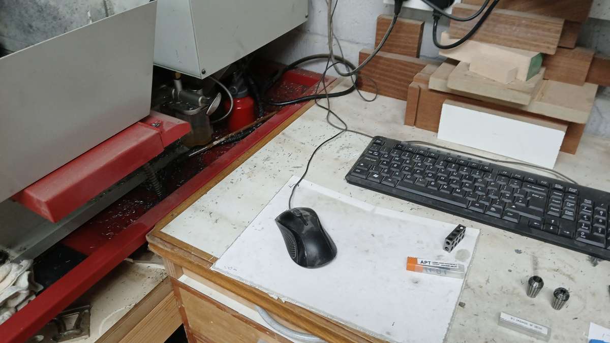

                              petro1head
                                @petro1head
                                So far20250423_114015
                                #796731
                                  I took these yesterday after nearly 2hrs of cutting a bit of cast iron, though only about 40mins was adaptive cuts which tend to produce the most swarf. As you can see the trough I have mentioned catches almost all of it. Adaptive was with a 6mm 3-flute at 5000rpm, a faster spindle speed may throw it a bit further. Also had the air on the whole time.
