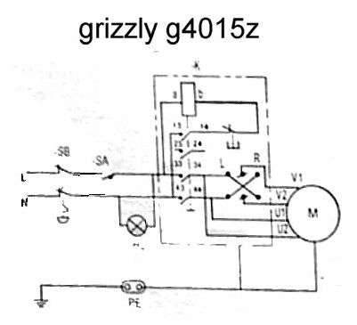

      I have a Clarke CL 500 on which the Forward /Reverse switch was broken. I carefully tagged all the wires (6 of them) then bought a switch from RS. Perfect-or so I thought. When I went into the workshop all the tags had come unstuck so Im back to square one. Grrrr!
      Can anyone send me a wiring diagram or better a photo of the rear of the switch showing where the wires go ( Yes I know-I should have done that but I thought the tags were a brilliant idea.)

          the nearest I have found is this :-
          http://cdn1.grizzly.com/manuals/g4015z_m.pdf
          figure 17 on page 21 shows a low resolution diagram
          do  two of the wires have short wires crimped on to make the diagonal connections to the switch ???
          if you test the continuity between the 4 wires from the motor
          I would expect you will find two wires   (V1 V2 )  have continuity and they need to be wired across the middle 2 switch terminals
          the other  two wires (U1 U2)  motor wires will go to the start winding that's in series with a capacitor
          and will connect directly to the mains supply from the NV release switch

                    Despite all the help so far Im still struggling. A good picture of the back of the reversing switch and the wires from the on off /stop switch might help. I know there are a lot of black wires but if I can see where they come from and go to then I may have a clue.
