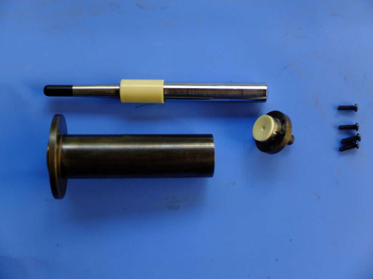

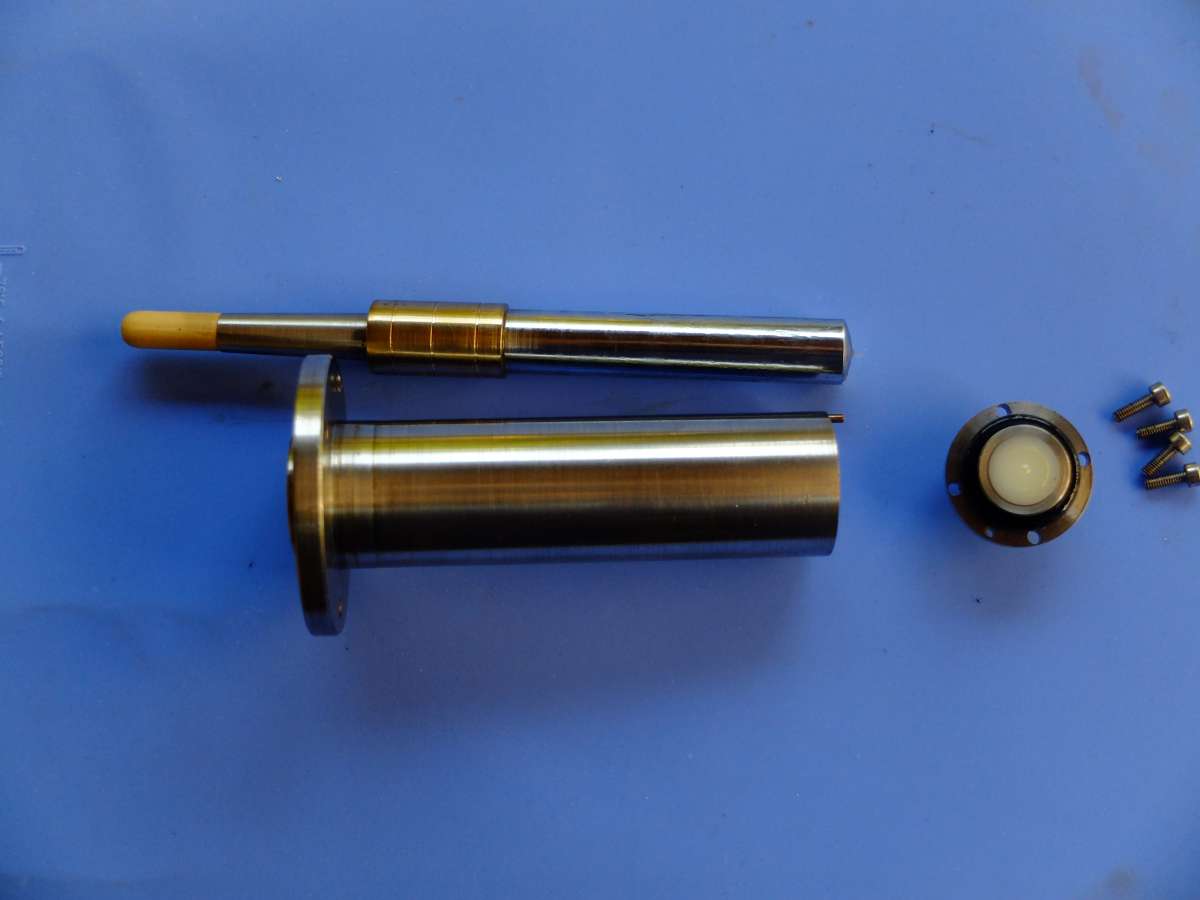

                                  Versaboss
                                    @versaboss
                                    Ah well, nice to meet a hobby colleague!
                                    It is quite a time now since I built a couple of bearings, and even sold a couple. But my bearings are strictly for Lencos (75/78), which have a very strong motor. The differences to the standard bearings are:
                                    – a much stronger housing (steel)
                                    – a thicker spindle (10 mm), running on a Delrin (or other synthetic bearing materials), rounded end without a ball
                                    – only a short part of the spindle is thicker (14 mm) and made from Bronze, sometimes Aluminium Bronze, and running also in synthetic materials.
                                    After more than 10 years, I possibly can’t remember all details, but these bearings worked perfectly and silent. Just today I enjoyed some Keith Jarret solo concerts, wonderful music!To comment what you wrote above: Brass is Not a suitable bearing material, ad the distribution of weight in the platter has imho no effect to the sound. Although I admit after 80 years I am possibly not qualified to comment.
                                    How do they look:
                                    DSCF2201
                                    DSCF2203
                                    Kind regards,
                                    Hans
