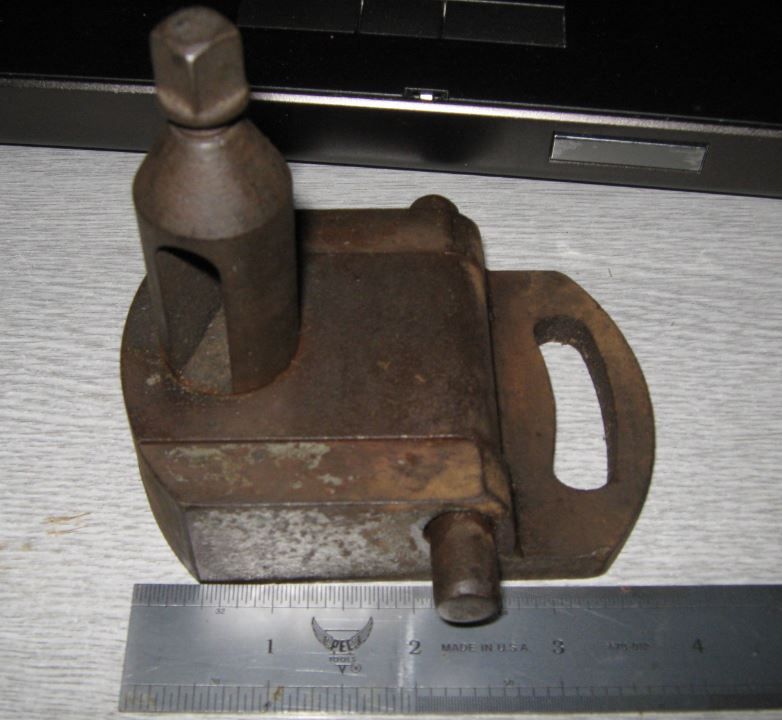

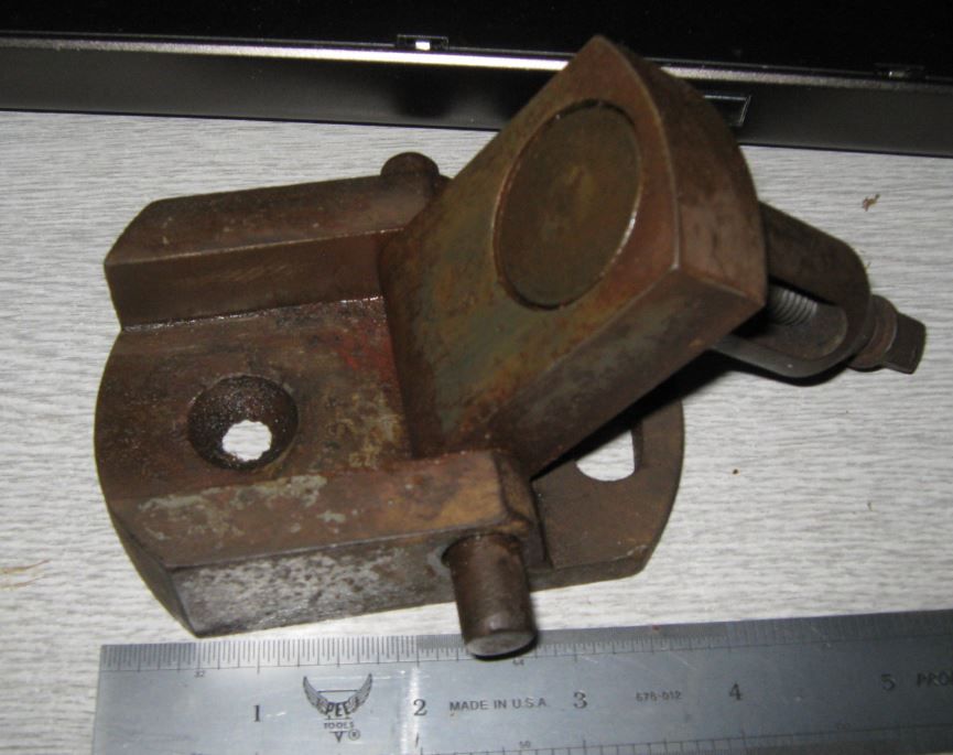

                      #202447
                      GoCreate
                        @gocreate
                        Hi Mick
                        Here's some pictures of the clapper box I have, It's 4" long x 2-3/4" wide. Its got surface rust though I think it will clean up nicely. Please send me a PM if you want it and I will find out the postage cost.
                        There is some play on the pin, probably this will need replacing and the through hole trued up, the pin measures 7/16" parallel so could be made 12mm.
                        Nigel
