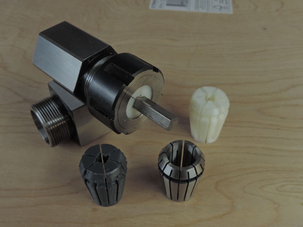

                                One solution might be to get a suitable octagonal collect 3D printed, ideally in Nylon.
                                Square Collets

                                  Another option is a wood turning chuck that has removable sub-jaws for holding different sizes of bowl. These jaws are screwed on to the movable base jaws equivalent to soft jaws on a metal lathe. Make your own wood or plastic jaws to fit gluing on felt faces if appropriate.

                                    Posted by Neil Wyatt on 16/08/2018 14:33:56:
                                    Why nylon?

                                        Posted by Alan Vos on 16/08/2018 17:52:33:
                                        Why nylon?
                                        It will last longer if repeatedly flexed, is stronger than ABS or PLA, softer than the silver and should be non-marking.
                                        You could also use PETG.
                                            Square Collets
                                            Doh! I just realized looking at this, that a bog standard square collet as picutred would hold an octagon very nicely. Just get the square collet that is the same size across the flats as the AF measurement on the octagon.
                                            If the collets are only readily available in steel, your piece of silverwork could be protected by wrapping a piece of paper around it before inserting in collets.
                                            Just a thought.

                                                Neil, where did you find the photograph of the nylon square ER collet? It's exactly what I was thinking of. The closest thing I found on the net was the tapping collets, but they are designed to hold a square and round shaft of course, with the square part being deep inside the collet.
