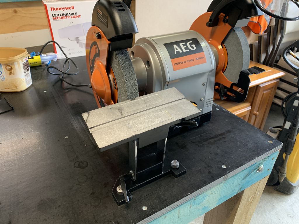

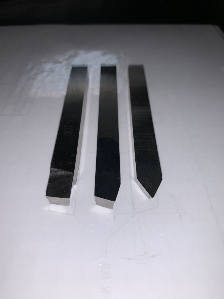

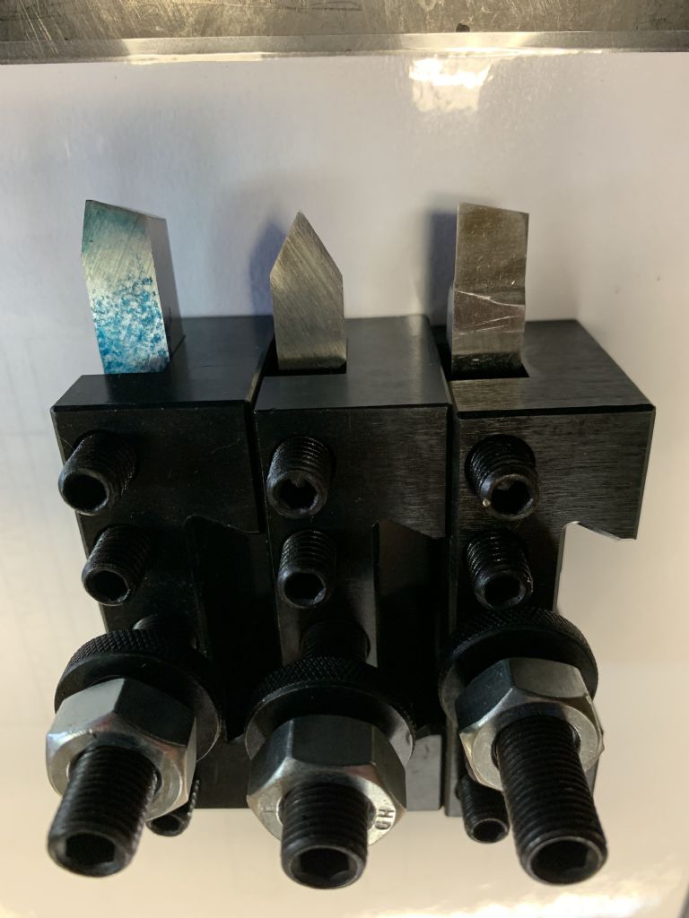

                                                  "A second hand lathe" with a QCTP and the ability to grind "Old school" tools, Did you really need to ask the questions John????laugh
                                                  Regards Ian.

                                                      Posted by Circlip on 17/08/2021 15:47:35:
                                                      Regards Ian.
                                                      Hi Ian,
                                                      I have had no training at all with a lathe and wanted one for years. I have been watching youtube clips of blonde hacks, Tubal cain, Old tony etc, since I bought the lathe. It came with a QCTP and some used carbide inserts, and me not originally knowing what to do watched, researched, stalked pages on FB machining sites and finally after getting confirmation from you guys on what steel is good, jumped right in. I got some HSS blanks, blue layout ink, a machinists protractor and decided to bite the bullet and make some HSS tools. They work great. I have the machinists black book so i figured out what carbide inserts i needed for the tools and away i went. Im enrolling in a basic machine course at TAFE here in australia when these covid restrictions lift and its a 9 week, 4hrs once a week nite class on lathe and milling, as next i want a milling machine. I really love machining as a hobby and really push myself to learn. I even stood at the lathe taking different sized cuts, using my verniers and micrometer measuring everything after each cut and figure out the hand dials on the apron, cross slide and compound so i know exactly how much steel I'm removing. i actually stalk all old posts on here for information.
                                                      cheers All
