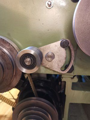

                        Thanks for all the comments chaps. I have not made my mind up yet so will just continue to use the 4 way tool post for now. But is the wedge style so much superior than the piston, dickson type? Anyway my first project is to make a new idler wheel for the belt tensioner. Noticed it don't make noise on the three lowest speeds, but the three highest it rattles and makes alot of noise. So I changed the bearings, but that did not help. Also it fits loose in the swinging bracket so will make a new one. This time with a nylon locking nut at the back instead of a locking ring and with highest quality bearings. Added a photo on how it looks like.
                        I feel it is a bit shitty since it is a new lathe, but then again it is chinese so it is a project in it is own I guess. Added the four bolt on the compound slide since the original two bolts were soft and the threads stripped out. Otherwise it seems fine and run true and I dont regret selling the other old lathe I restored since it took up too much space. Though I am a bit jealous of all the nice Myfords and Boxfords I have seem online laugh. Hope my English is good enough since it is not my native language. All the best from Norway.
                        Photo of the old and new under.
                        Edited By PipesandStuff on 20/08/2022 13:21:58
