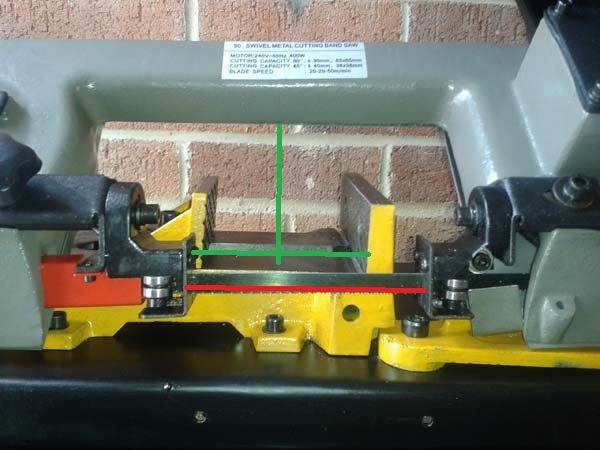

        Hello All
        I’ve just taken delivery of a Chester H80 band saw. According to the Chester web site it has a maximum cutting capacity of 120 mm by 90 mm, but now I’ve got it the two dimensions in green (below) are around 90 mm each. It’s the dimension in red that’s about 120 mm. I’ve spoken to Chester and they say the H80 actually has a maximum capacity of about 85 mm square. They are apologetic and happy to arrange collection and refund.
        However, can I just check I’m not missing something stupid and that without performing major surgery on the machine I can’t cut at the advertised capacity.
        Can I also ask if anybody has the Warco CY90, with an advertised cutting capacity of 90 mm x 130mm, what’s the actuall cutting capacity.

          David,
          I have checked mine which is the Warco variant…..max height is 90 and max cut horizontally is a shade under 105…. You could get a bit more by extending the elongated slot in the rear blade guide so it moves further back, but max jaw width is wider than the 105…..

            I have one – will cut 100 x 6 or similar but not much wider – catch is that as widen the cut the sawblade tends to move even more away from vertical
            For price charged it’s fine and saves much effort but the method of fixing blade verticaly could do with improvement – mine didn’t appreciate cutting stainless when a lower speed + some means of suppling cutting fluid would be needed – the weld on blade gave!

              Surely the maximum width of cut is determined by the maximum distance between the blade guides, which on my CY90 is 140mm. Don't forget that the saw is rotatable to give an angled cut which will be longer than the maximum width that the vice jaws will hold. The quoted figures therefore seem reasonable to me.

                if you look at photo then the saw mechanism rotates in a horizontal plane about the socket head directly under the rh end of the red line thus for an angled cut the stock must be narrower (eg 45deg means 70mm wide max

                    Hi David – I've just been and run a tape measure over my Chester H80. My figures pretty much agree with yours, but if you were to do some mods you could get very close to the 130×90 dimension. You would need to make the front blade guide move further forward, as built it's limited by the length of the slot in the adjuster bracket and by the blade guard (the red bit under the front guide) hitting the front wheel inside the top assembly. This blade guard is only held on by a single bolt. If you were trying to cut to the full 130, then I don't think the removal of that guard would present much if any of an additional hazard as the front guide would then be right up against the head assembly of the machine so no extra blade would be exposed. To get that extra movement you'd need to extend the slot in the front guide bracket, again at first sight, I dont see a problem with that as the bracket is pretty substantial.

                        Sorry forgot – suspect if you try to widen gap between supports you will run into problems with forcing the sawblade into too tight an angle coming off the guide wheel – I think the short length blade is already close to its twist limit as set

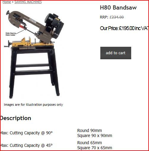

                          Don't know what you were looking at but web site says capacity is 90×90? I have also got a paper catalogue that must be at least a year old and that gives 90mm dia or 85x85mm for square
                          Edited By JasonB on 03/06/2015 20:29:24
                          #192290
                          David Cambridge
                            @davidcambridge45658
                            Wow – if nothing else Chester are quick off the mark! here is a screen shot from their web site taken at 14:40 today and just before I called them !
                            #192317
                              Looks like it was a typo on the web site as the paper catalogue (2012) had it right.
                              J
