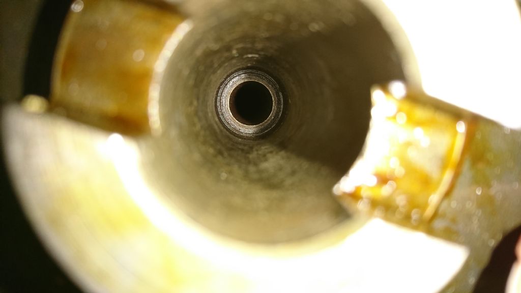

                        Thanks guys. I measured the depth of the mt3 hole and its 85mm. I managed to take a photo of the inside but I can't seem to upload it
                        It looks like it's just a few mm too short for the drills to fit as when I install them there is only slight sideways play but you can feel its bottomed out too. There is no slit milled in the top for tang tang of the drills.

                                #403060
                                Adam
                                  @adam
                                  This is when you look up into it. I called Chester and they said you can't put morse taper drills in the machine. I assume it's the same for warco units too. So my mt3 drill chuck won't fit either, but my draw bar is too short to reach my boring head and collet holder so I do wonder if its been machined slightly short. No matter I can make a longer draw bar easily.

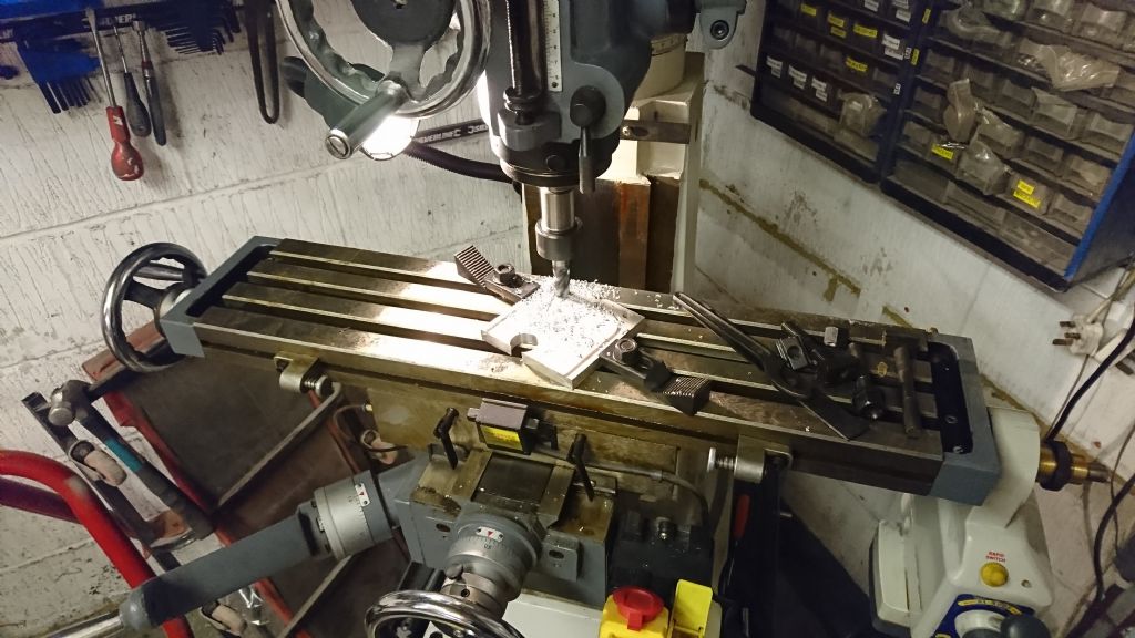

                                    Well this evening I made a longer draw bar, Whitworth one end and m12 the other so I can just turn it around whenever I need to change tooling. Took my first cuts and it is so much more sturdy than my old little mill drill. Liking it so far!

                                        Adam
                                          @adam
                                          Tha ks Phil, I appreciate that. I'm not too fussed about the mt3 drills as I don't recall needing them on a drill, only for boring on the lathe. I do use mt2 drills a lot but I can simply machine the tang off the mt3-mt2 adaptor. I just did another job on the mill, custom engine mounts and it's so nice to work with.
