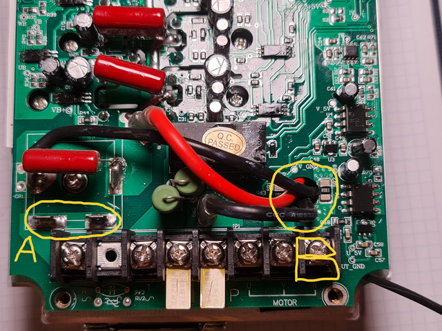

                                You made me curious about the other VFD I already have. It came with the lathe. It is a 4kW model, and one of the cheapest you can find:
                                I decided to have a look inside. Unlike the Vevor 1.5kW model, this one has 6 discrete IGBTs 25A/1200V (NGTG25N120) bolted on the heat sink together with a large square rectifying bridge.
                                I have no experience with VFDs but I wonder how this thing can boost the voltage to 380V without any coil? The 4 electrolytic capacitors are rated to 400V so there is no voltage doubler there. Anyway …

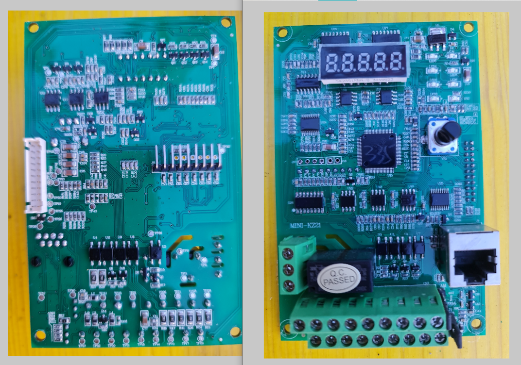

                                This is the main board. You can open in a new tab to see it in higher resolution. The active component are painted with a transparent lacquer. But not the PCB or resistors. This is strange. The large transistor on the top left must be the breaking switch, 3N150  2.5A/1500V N-MOSFET.
                                All small electrolytic capacitors are Rubycon. Not bad. That black relay is shunting the two 5W green resistors that limit the inrush current during capacitor charging. This control is not perfect. I know from experience that I can blow the fuse by turning off and the on the VFD supply.
                                The top 3 red film capacitors are connected between ground and the middle of each bridge leg. The bottom one is across the DC bridge input. IGBT drivers are TLP5701 photocouplers.
                                There are also two AMC1200 isolation amplifiers. This are expensive components. These are close to two shunts. I wonder why there are two. There is also a temperature sensor bolted on the heath sink.
                                All control and analog measurement part is on the small display board:
                                The CPU is an Sinowealth SH32F205, Cortex-M3 at 120MHz. A bunch of optocouplers, a relay output and many LF353 op amp.
                                The VFD has no filters on input or output. I don’t know how common is this. The Delta model has filters at both input and output. The guy who sold me the lathe told me that some capacitive touch lights in his home would sometimes turn on depending on the depth of cut 🙂 What I noticed is that DRO is sometimes incrementing without reason due to interferences. So I don’t trust it anymore.
                                That is all about this quick afternoon VFD dissection. I should have a comparable VFD from a more respectable OEM to draw a conclusion. Or maybe somebody can spot something interesting here.
                                #737982

                                  #737991
                                  Anonymous
                                    A few comments:
                                    I doubt the VFD is putting out 380VAC phase to phase. A voltage of 220VAC times the square root of 3 gives ~380VAC, but you cannot get 380VAC phase to phase from rectifed 220VAC. I suspect this is specmanship.
                                    You don’t need a transformer to generate the ~700VDC bus needed to generate a true 380VAC phase to phase supply. Either a seperate boost converter, or a modification of the input power factor corrector will do the job. But neither of these are likely to be found in a budget VFD.
                                    In theory the bottom side IGBTs don’t need opto isolation. The top side IGBTs do need an isolated drive and an isolated supply on the gate side. The isolated drive needs a high dv/dt rejection ratio.
                                    The two AMC1200 devices are measuring two phase currents. In theory, in a balanced 3-phase system, the third phase current can be calculated from the vector sum of the other two phases, the sum of all three being zero. The devices don’t seem that expensive, $1.45 in low volume.
                                    I don’t know what a breaking switch is? The transistor/heatsink seems too small to be acting as a braking resistor.
                                    It is common for VFDs not to have input or output filters. For a start it saves cost. Output filters are only needed in special cases. Mains input filters are normally provided seperately as part of the wider system design.
                                    Andrew
