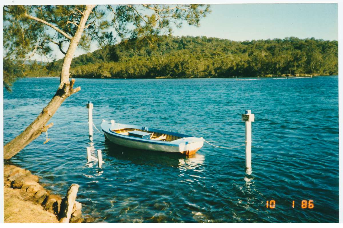

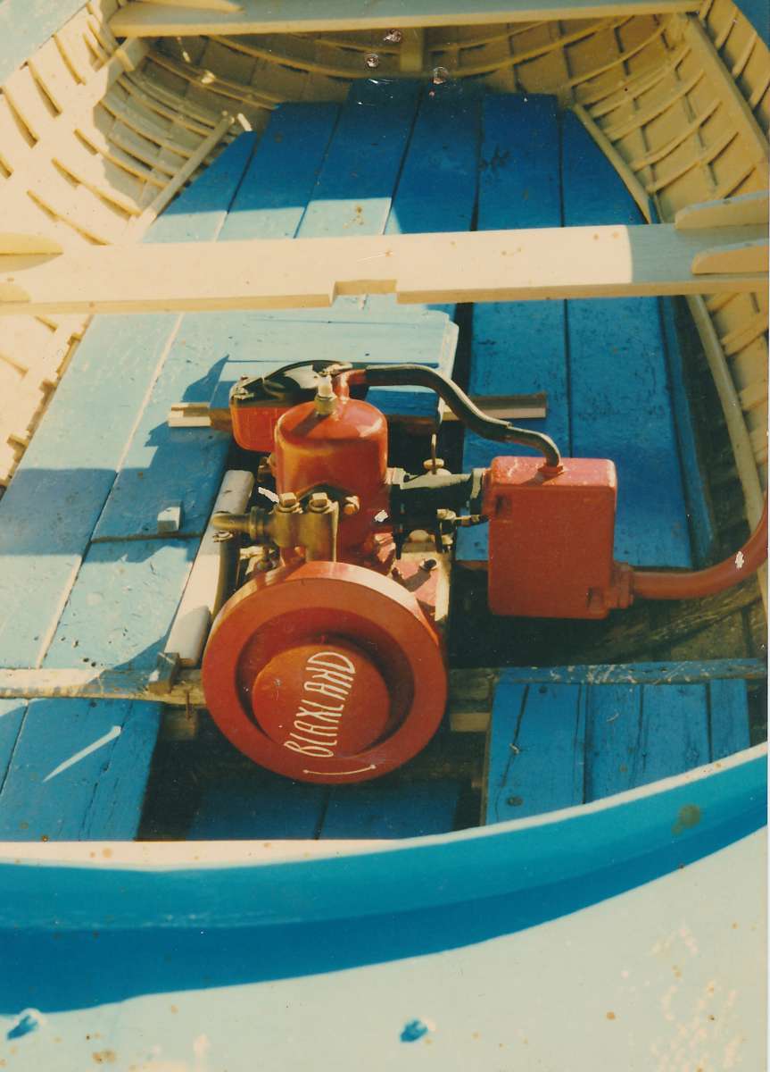

                                        This is my Putt Putt boat (clinker built) with a Blaxland Chapman inboard motor out the front of my home on our private mooring poles that I did up in the ’80s (now long gone) these were really common inboard motor timber boats when I was a boy, but when aluminium boats became common these were quickly abandoned because of the amount of maintenace. But they were just great to fish out of and had a lot more ‘soul’ than boats I’ve had moored out the front since that.

                                          I’ve always quite fancied making a model of one of the single cylinder boat engines like that plus an old outboard, maybe one day they will get to the top of the list

                                            Jason These clinker built boats (carvel built was fairly rare in my neck of the woods) weren’t built as ‘forever boats’ they were hard working boats that came with a holiday house or could be rented out at the boatshed in tourist season. They were built in a very small lakeside boat shed that was near me (long gone and now just foreshore). Its virtually impossible to stop a wooden boat from eventually developing rot somewhere. When the rot or damage was too bad they’d build another and transfer the engine over (mine was a single cylinder, some larger boats had twin cylinders)  Clinker boats needed to be kept in the water to remain water tight. It was a big job for someone to bail them out throughout a high rainfall night (maybe get out of bed multiple times to do it) so that the engines didn’t go under water. Lots of folks tried fibreglassing the outside of boats which made them heavy and not as elegant motoring, but it backfired on them because it amplified rot.
                                            As soon as aluminium boats came on the scene (first ones weren’t welded they were riveted) these beautiful old boat were left to rot on the banks and foreshores.
