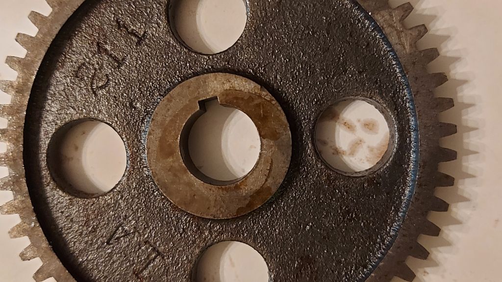

      Would like to have these gears identified please and to what lathe that they may belong.
      They appear to be unused and very fine condition of fine grain casting of steel. I do have a SBL 9 B that does not have a set if change gears, these may be able to be adapted ?. SBL are 18 DP I think, don't have a gauge. your thoughts please, otherwise I will be considering a swap trade. Doug

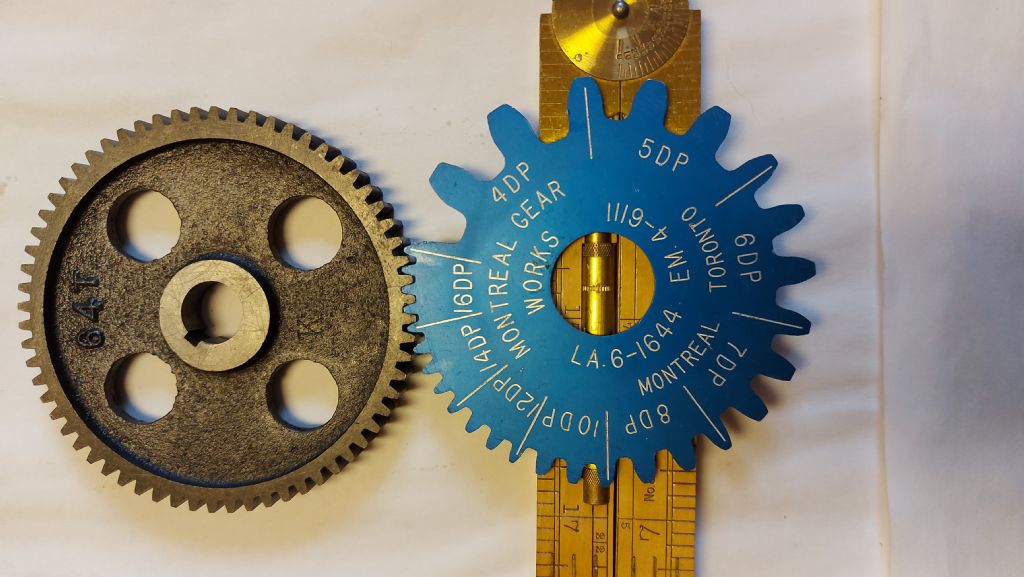

            Smart and Brown used 16DP gears. The standard sets do not include some of the tooth counts shown, perhaps they are for BA pitches.

                  Look like Logan. DP, Bore, Single Keyway, Four Holes all match
                  46T is one shown on their change gear chart, the rest being in steps of 4
                  The fact Doug is using a DP gauge from a Toronto company and has a South Bend suggests it may be he is not UK based so cutting BA is unlikely..
                  EDIT The 46T allows cutting of 11.5tpi which is used for NPT pipe threads so one more indication the lathe is from the US.

                    South Bend change gears are 18 DP. I'm sorry to say this collection will not mesh with the ones you have already and in particular the 24T pinion that is machined on the spindle, they will bump and grind doing no good to either component.
                    I can't help much in suggested which lathe they would be best suited to, but I wouldn't recommend them for your lathe.

                        I think Doug is saying he has South Bend gears but his gauge does not have an 18DP section to confirm the DP..

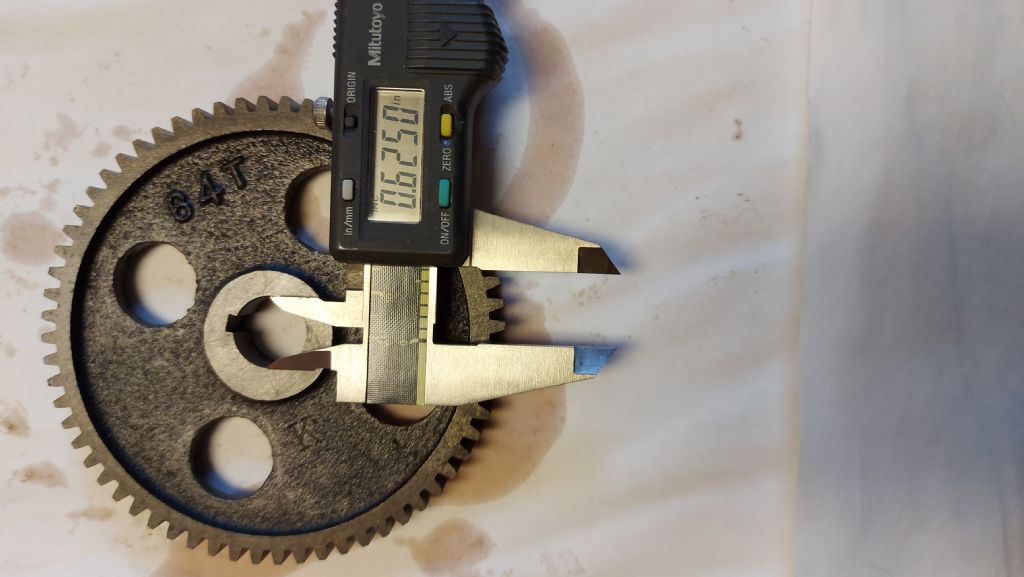

                                You can calculate the DP by measuring the O D of a gear and counting the teeth.
                                Add 2 to the tooth count and divide that by the OD in inches, the resulting number should be the DP.
                                i.e. a 20T, 20 DP gear would be 1.1" OD   (22 / 1.1 = 20  )
                                Unfortunately, there is no easy way of determining the Pressure Angle. But if the gears are of any age, they are likely to be 14.5, rather than 20 degrees, which is what seems to be the standard for more modern Metric Module gears.
                                Gears of the same DP but different Pressure Angles should not be meshed together. Both will suffer wear and not operate properly.

                                  My Model M uses 16DP gears. I've just checked to be 100% sure and the OD of the 100 tooth gear is 6.375". This matches my HPC catalogue's data. However the same book has got the OD of 18DP 100 tooth gear as 143.93" on one page and 143.99mm on another page, oops by them I think.
                                  Martin C
                                  #557674
                                  Howard Lewis
                                    @howardlewis46836
                                    102 / 5.6666 = 18 Using metric dimensions for an Imperial size!.
                                    102 / 6.375 = 16

                                      …..Except by the 'span' measurement across a number of teeth!
                                      Look up Ash Gear, Novi, Detroit for their excellent website which has a gear tooth span formula for calculating the pressure angle of a sample gear.

                                          South Bend gears are certainly 18DP 14.5PA (for the smaller lathes). Im making some currently.

                                              That will be Logan then, found a 60T with LA 212 which fits between your two quoted teeth/part numbers and the 24T is actually LA-202

                                                I have just checked with http://lathes.co.uk/logan/page6.html. the Logan No 850 Turret came furnished with 17 gears (6 on the lathe and 11 extra ) and 7/16 face width . I have the 11 extra gears with 7/16 face width. Hopefully that is what I have.
