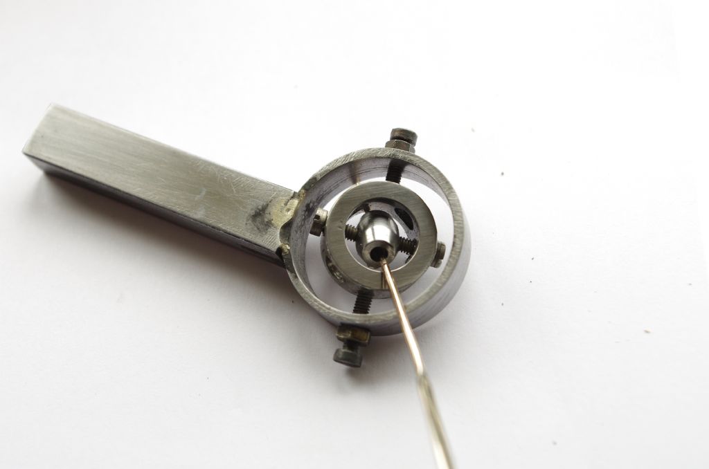

            First apologies for appearing to ignore all your replies, I've been away on a long weekend.
            I am greatly appreciative of all your comments and suggestions and went away inspired to make something.
            I tried cooking a 1/2" Ball bearing (I don;t know what type of steel – it was 'rescued' from a dead ball race). I got it bright red hot and allowed it to cool slowly between the two firebricks that I'd cooked it in. Rather disappointed – the oxidation scale was rather heavy and it was still too hard to file a flat on.
            I have – somewhere- a small double ended rose bearing, but have not been able to find it, so I'll put that on the back,burner for now.
            So using materials that I had lying around I've a made a centre finder – al la Tubal Cain but found that until I get close to centre my dial indicator kept dropping off the side. I'll try again when I get some larger diameter material to add a collar, as suggested above.
            I've made a gimbal model (see picture) which does work quite nicely. I just need to get some 3mm rod to complete the build. The photo shows just a piece of thin wire It's probably not as precise as I would have liked as I used odd pieces of material that I had and the smallest available screws are 6BA.
            Again many thanks for all your replies
            regards
            Bernard
            I've also ordered some 1/2" threaded balls off the net. They look too useful not to have any
