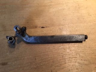

        I was given this tool the other day:
        It is more than likely a centre finder (?) but does anyone have a similar tool and able to tell me what bits are missing? (It is made by J Whitworth & Co)
        (There are a few more photos in an album I have just created)
        Matt

          It is indeed a centering aid…
          A finger fits through the gimbled bit…a point on either end..one short ( near the gimble)..wjich is engaged with the center mark of the stock..the other end wobbles around describing a much larger circle ..the stock is adjusted in the (four jaw) chuck until this wobble is minimised. ..with a typically five to one ratio a very small error can be detected…
          #214802

                Thanks. Do you think the finger/needle is within some sort of collet? Interestingly the gimble is spring loaded in one direction.
                Matt

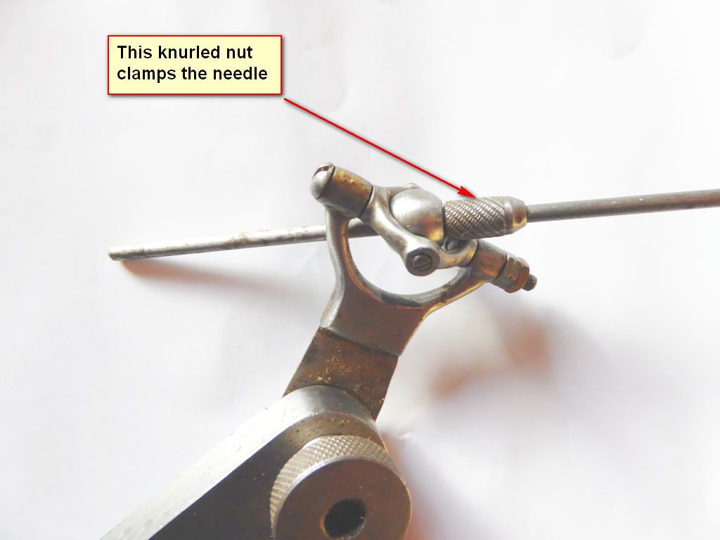

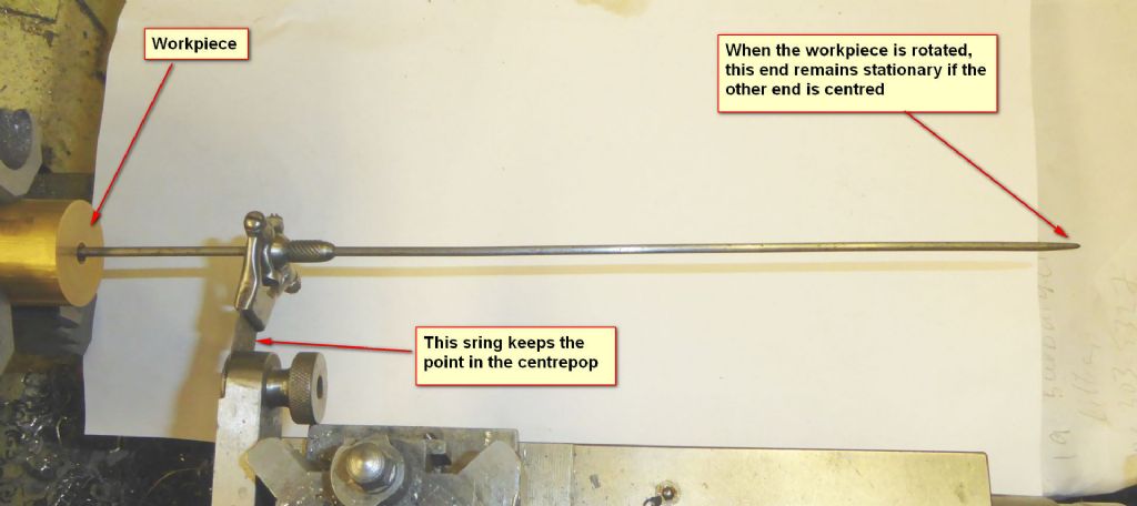

                  Here's a photo of a similar item in use.
                  centrefinder.jpgSorry for the typo, for sring read spring

                    Does a centering finger like this have to run off of a center-bored hole (as in previously-turned item) or would it also work pressed into a center-punched witness mark on new, not-yet-turned work?
                    #215055
                    Gary Wooding
                      @garywooding25363
                      Posted by Ignatz on 04/12/2015 02:42:36:
                      Yes, that's what it designed to do.
                      I'm afraid that my photo was created in a hurry and, to save time I just stuffed something in the 3-jaw. In practise, the workpiece would be in the 4-jaw independent with a centre-punched mark that needs to be centred. The pointed end of the finger follows the centrepop as the chuck is rotated, and if its not truly centred the other end wiggles even more because of the difference in the lengths either side of the support.

                        In your centre finder is the pin fixed or does it slide along and the knurled part used to fix the pin in situ? I'm obviously missing parts here and I still cant see how the small attachments (stored in the body) are used on it.
                        Matt
                        #215077
                        Gary Wooding
                          @garywooding25363
                          The needle can be moved back and forth when the knurled nut shown in the photo is loosened.

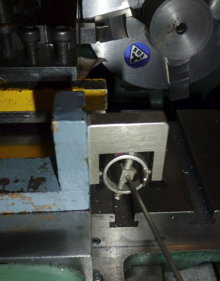

                                            Many years ago in one of the ME mags, it was suggested that you could dispense with gimbals etc and just cut a thin slice of india rubber (= pencil eraser) and fix in a frame. The pointed rod was simply pushed through to provide the magnified "wobble". I remember trying the idea and after cutting a slice from an eraser about 1/16th thick (?) it worked well enough for setting up in a 4 jaw.
                                            Much later, the gimbal below was removed from a broken lab item. The gimbal looks easy enough to make, probably more so than drilling steel balls..

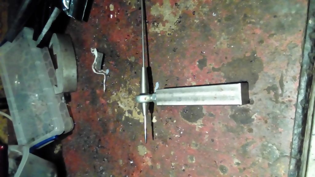

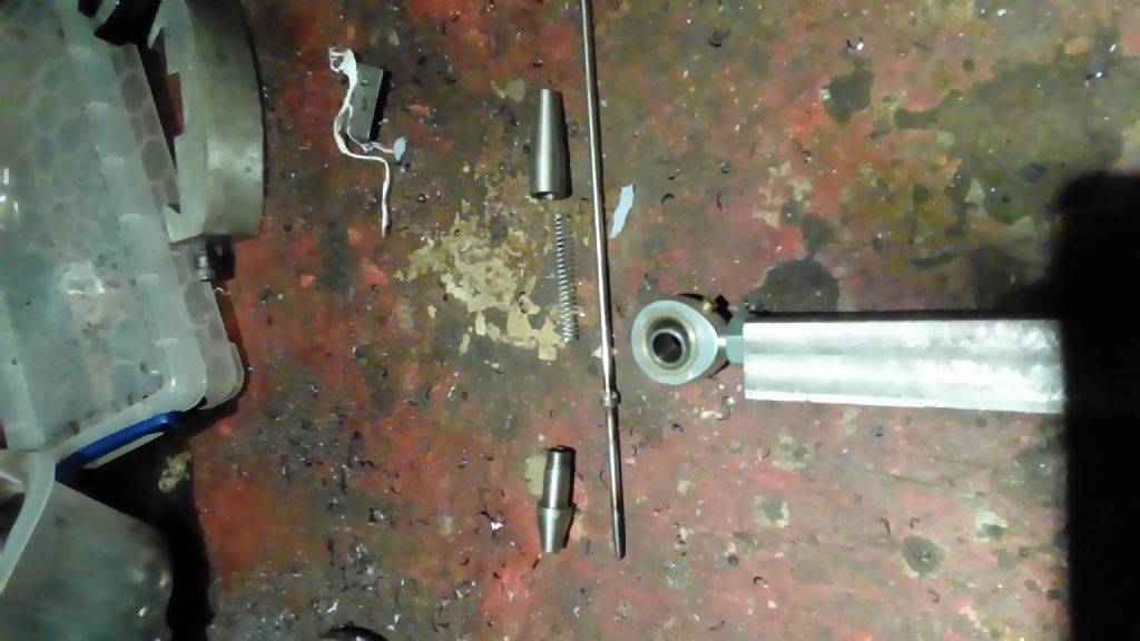

                                                    Here's mine:
                                                    and disassembled:
                                                    The rose joint was bought from one of the odds&ends suppliers at an ME show for £3, and is 8mm bore. The mounting bar was clamped in the toolpost, and I used the lathe to drill and tap the hole for the rod end. The rod is 3mm silver steel turned to a taper on each end and hardened(in the gas stove) at the working end. There's a stop soldered on 1/5 along the rod, nearest the working end; this gives a 4:1 ratio and is plenty close enough for anything I do. The centre parts are 10mm steel, turned to a sliding fit in the rod end, and screw together with an M8 thread. The spring is from an assortment bought for just this sort of job; nothing technical, just 'springy'.
                                                    That was a productive 1/2 hour in the workshop, making it up as I went along.
