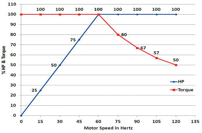

                              Interesting post – I’m convinced I read in a book that magnetic losses were the limiting factor, and found this post on StackExchange Electrical Engineering which I think indirectly supports the idea.   I posit that the design speed determines the nature of the core.
                              AC Induction Motor design is dependent upon a relationship between applied voltage and frequency, what’s referred to as the “V/Hz ratio”, to produce a given amount of torque at a given speed. So a motor designed for 460V at 60Hz has a V/Hz ratio of 460/60 = 7.67 (to one), motors designed for 380V 50Hz have a V/Hz ratio of 7.6 (the similarity is not a coincidence by the way). Maintaining this V/Hz ratio (+-10%) allows the motor to produce rated torque at any speed, up to the design speed. If you only reduced the voltage without maintaining the ratio, the torque drops at the square of the voltage change, so the motor stalls very easily. What a VFD does is to allow you to attain that rated torque from the motor at any speed below the designed speed without stalling.
                              And this website offers analysis, including the comforting advice” High-quality, 1,800-rpm and 1,200-rpm motors up to 200 HP should be able to handle up to two times the base speed without problems” and a graph.   Note that torque falls with frequency above design speed.
                              motor_f
                              I could be completely wrong about the magnetic reason – need to find and re-read the book!
                                            motor_f
                                            Wish I was fit  –  I’ve lost several months of hands-on workshop fun this year.   In this example I’d like to attach a brake dynamometer to my lathe and measure how the relationship between torque, power, and efficiency varies with frequency, including driving it briefly at 3x base frequency or higher.
                                            Hi Dave,
                                            The stack exchange quote is correct with respect to V/Hz ratio when considering a fixed voltage supply or simple inverter drive. For instance if you want to run a 115V 400Hz motor on a 50Hz supply you must drop the voltage to 1/8 or 14.4V The speed and power is also reduced to 1/8.
                                            Increasing speed / frequency means you can increase the voltage to maintain the current and torque. Clearly as speed is increased and torque (current) is maintained by the voltage increase the power is increased. This is a “free” increase in power for a given motor size and weight. This is exactly why aircraft systems use 400Hz.
                                            The graph shows a drop of in power with increased frequency because “The torque reduction occurs because motor impedance increases with increasing frequency. Since a VFD cannot increase the voltage above its supply voltage, the current decreases as frequency increases, decreasing the available torque.” (quote from website you linked to). The incorrect bit is “a VFD cannnot increase the voltage”. Modern VFDs can increase voltage. They also use more complex algorithms to control the current in the motor than simple V/F ratio.
                                            More applicable to our typical use is the fact it considers full load operation. When run at less than full design load there is more headroom from resistive losses etc to allow the motor to draw more current and maintain the power needed.
                                            You can of course get motors intended for VFD use wound for rated voltage at a higher than line frequency. Another option would be to use an 115V / 60Hz motor on a 240V supply with suitable VFD settings. Something to remember if a low cost 115V motor or even machine turns up at low cost.
