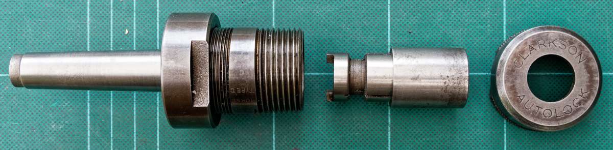

        My own preference though is to use a Clarkson collet chuck, in my case an older C type, with threaded cutters up to 16mm & 5/8″.
        I find this far more rigid than the simple MT2 arbor cutters and holders.
        The main reason, is that it has a second “snugging” ring at the top of the chuck, on a fine left hand thread.
        Essentially fit the collet chuck as normal, gently nipping up the drawbar, and then hand tighten the ring upwards.
        This provides further support for the comparatively slim MT2 arbor.

        I also have an S type with a similar ring, as seen here; have a scroll through the album
        Clarkson S Type 2MT
        N.B. don’t tighten the drawbar too much, and consider slackening off/removing the chuck whilst everything is still warm after using it.
        If you over tighten, and particularly if you do so when the spindle is warm, it becomes very hard to free off the tooling later when it cools down.

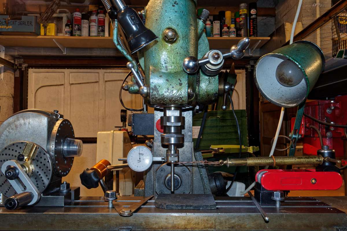

                          Out of curiosity, I’ve just been having a quick play with the Centec and a Clarkson C Type, with and without snugging ring.
                          This was the setup; not ideal, but just to give a rough idea.
                          S9080080_DxO-Facebook-s
                          Spring balance on the right, with tension applied by the table movement.
                          In order to get a 1 thou deflection on the clock, I needed 15-16 lb pull on the balance without the ring snugged up to the spindle nose.
                          With the ring lightly tightened with a spanner, that increased to about 20lb to get the same 1 thou, so not a huge difference, but it does indicate slightly more rigid; it might help to reduce chatter as well.
                          With a 20lb load, I then carefully released the ring, upon which the DTI showed a further 0.0003″ deflection, which went away after re-tightening.
                          The first 7-8 lb load seemed to be taking up spindle play, rather than anything actually bending slightly.
                          Photo not shown, or taken, but I tried a similar setup with a longer test bar with both this chuck and an ER25 MT2 arbor. Deflection was about the same with a disengaged snugging ring on the Clarkson, but improved a bit on tightening. I did take care to ensure the same overall projection from the spindle nose to the loading and indicating points
                          Bill

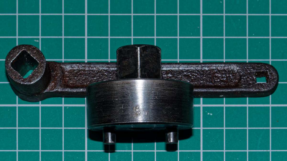

                                    Rather than a butterfly, maybe try something like this style of spanner; it sits and stays nicely on the top of the drawbar, and spins easily around with just a finger after the bar is loosened.
                                    Very quick and easy releasing of the arbor, with little chance of dropping a fiddly spanner.
                                    The other gizmo engages with the retaining nut at the top of the drawbar, which forms the self eject collar, above the spring. It’s far easier than playing with a peg spanner.
                                    The hex is machined to M17 as that’s the size I use for most of my clamping kit’s M8 flange nuts; again a short M17 combination spanner’s ring end sits there nicely with little chance of dropping anything.
                                    It makes changing the drawbar from 3/8″ to M10 a breeze.
                                    S9080081_DxO-Facebook-s
                                    Bill
