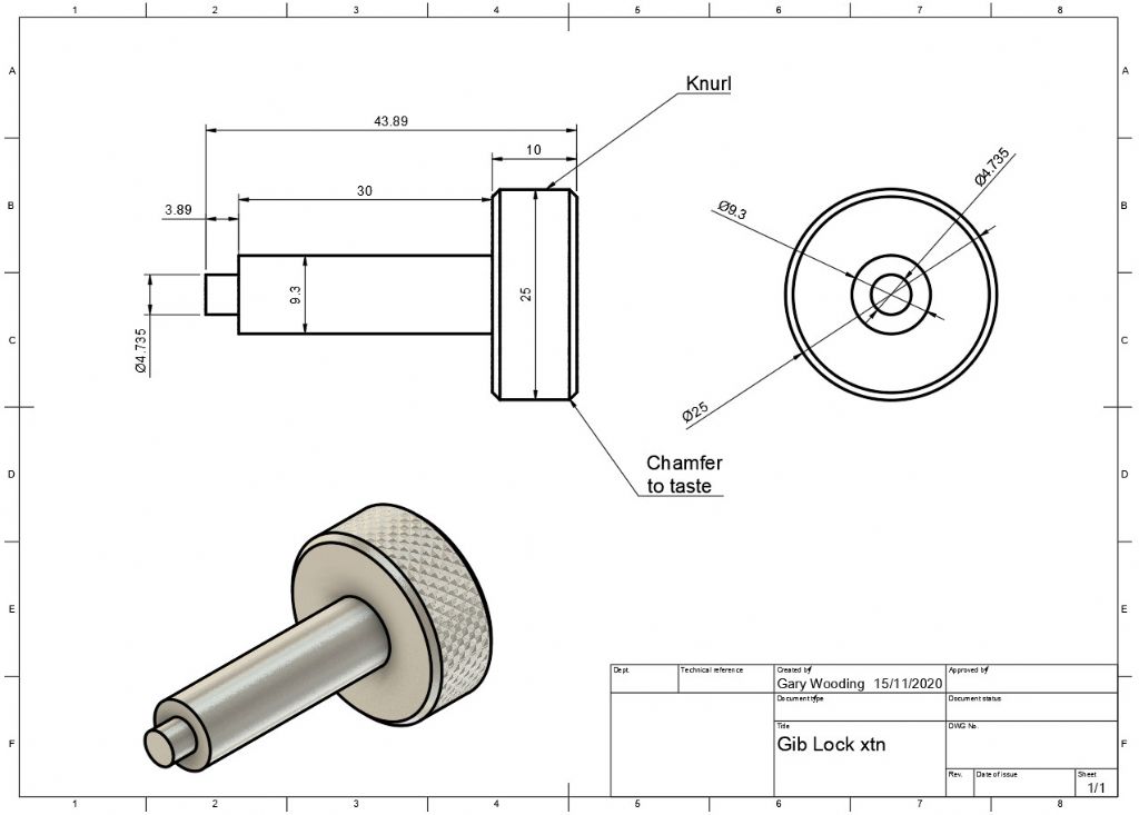

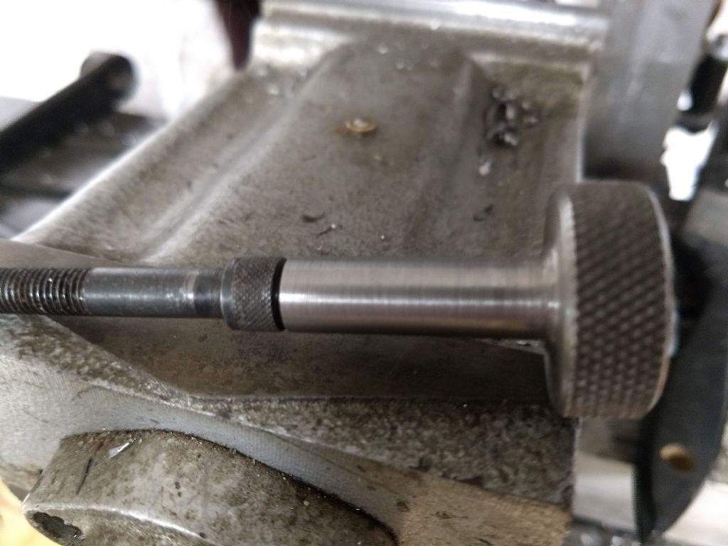

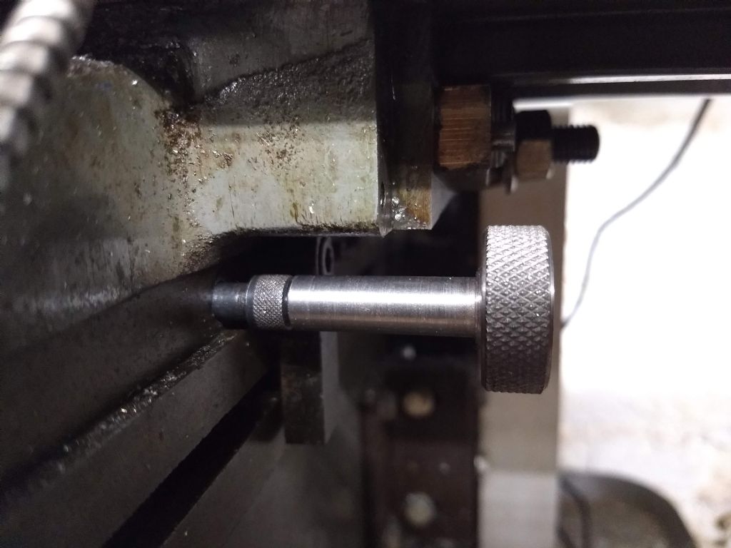

        A slight mod I made to my Centec was to the Y-axis gib-locking screw. It's a long Imperial threaded socket head screw which I found tedious to use. The Allen key kept falling out and I didn't have the wherewith all to make a custom version, so I made an extension from a piece of aluminium that's a press-fit into the socket head.
        It works for me and encourages me to lock the Y-axis more often.
