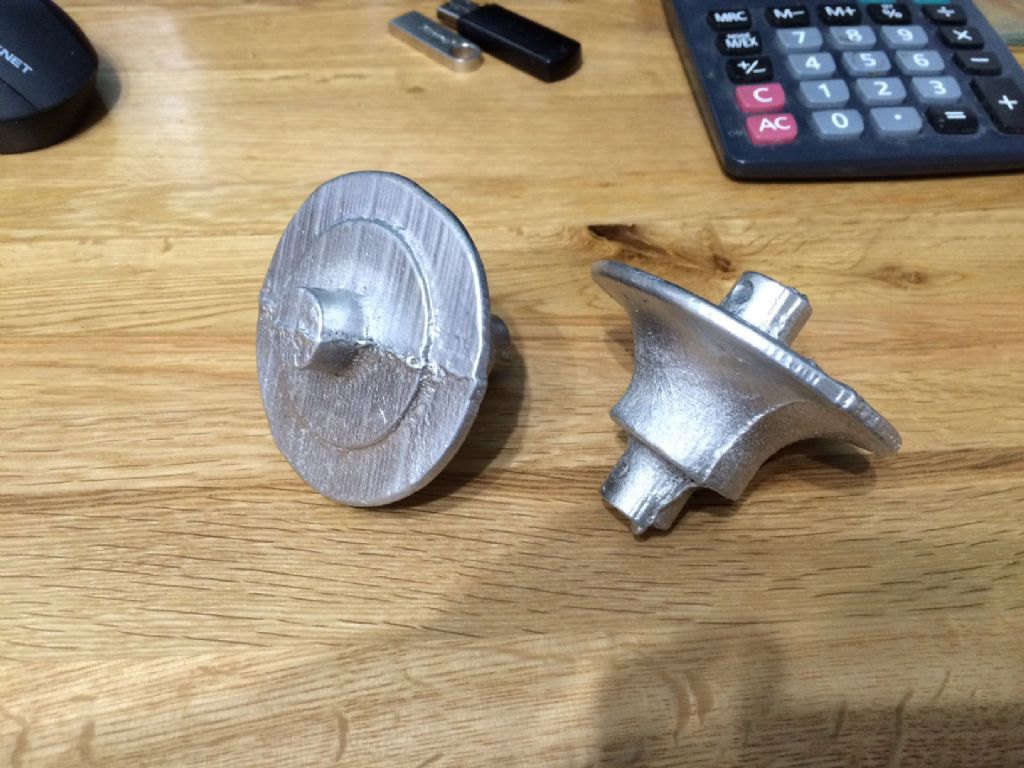

                                                Just finished my first cast then after the issues that i have had. I can easily say what i have learnt and its lots.
                                                Although the end products are not what i want they are close in that i could not make a successful core after lots of attempts, but i now know how to fix that.
                                                Todays cast ended up as the bottom flask being a good Silica Sand mold and the top one was a oil green sand mold to see which was best for me going forward.
                                                Time to start right from the beginning and to note these points:
                                                Put a marginally bigger draft on some of the patterns
                                                Make sure Silica Sand is absolutely bone dry
                                                That Silica sand does not give me a better end finish as i had expected compared to green sand
                                                That preparation (release agent/talc/wax) is key
                                                I need a better setup method for me to get the CO2 into the mold if i go this route with Sodium Silicate
                                                I think i might need a vent at the top of the rims as there is a slight dip and these were the top of the mold in teh oil sand
                                                This Forum is only a post away smiley
                                                In some respects i feel that i have lost 2 weekends with no product at the end, but with what i have learnt i am now looking forward to producing a better quality part which will be worth much more to me in the end run.
