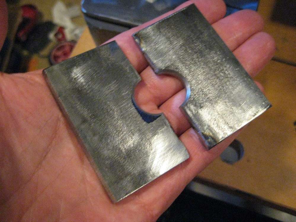

      I’ve recently starting using carbide insert boring bars.  The attached photo is one such project.
      Two pieces of 3/16″ bar that had previously heavily chamfered edges.  I tack-welded the pieces together, and then drilled and bored in the lathe. In hindsight, I should have squared-up the edges first.  The chamfered edges created an interrupted cut that chipped my CCMT insert.  And I was only taking 5 or 10 thou DOC.
      Is there a best practice in this situation?  Use HSS instead?  Don’t do any interrupted cuts with carbide ever?
      Mike

        I’ve never found it to be a problem and regularly turn and mill odd shaped steel fabrications, castings or just simple things like square or hex section bar, even facing off the end of a porely sawn round bar can give an interuppted cut.
        Don’t think we can even blame the welded joint as I’ve used carbide on welds without problem.
        Did you drill out to the minimum clearance diameter that the bar requites?

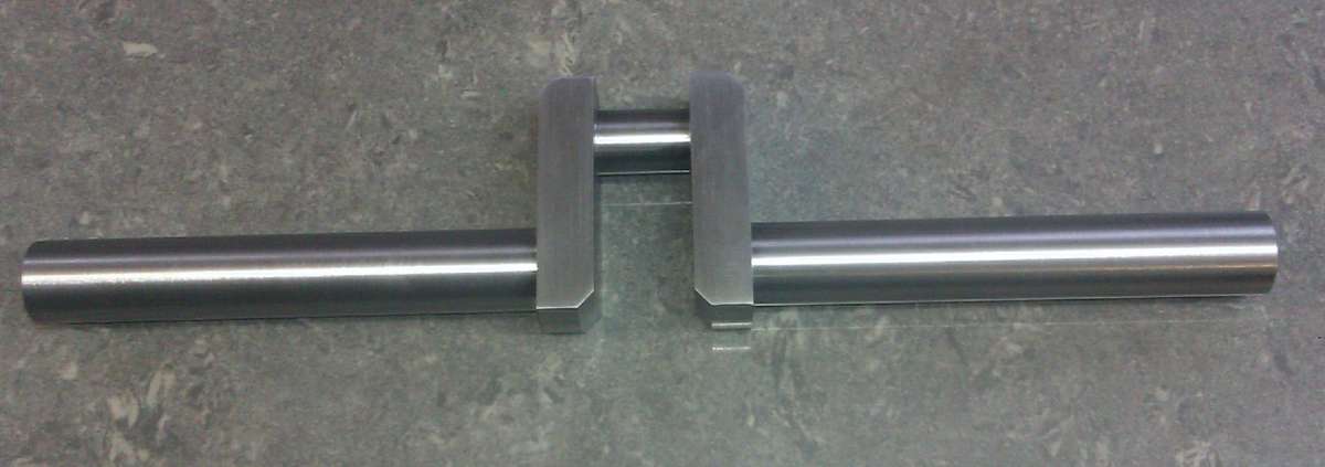

            I don’t use any special inserts, just my usual general purpose ones. Infact i#ll often use the CCGT inserts which have an even more delicate edge.
            Couple of examples that give interupted cuts but no problems with the inserts
            Crankshaft from 50 x 25 bar
            IMAG2374
            IMAG2381
            Bit of a fabrication. **GT insert on that and on large diameter work on variable speed machines I advocate running towards the top end of the inserts speed range.
            Tid81
            Similar shaped iron casting, just over 100m/min or 325ft/min on that one.

                  Actually, I wasn’t even machining the welds.  I put the welds at the outside edges of the bars and then cut them free with an angle grinder cutoff disc after boring the center.  The bar was leftover from another thing and had the edges already chamfered.
                  I should have pointed out as well, that after I chipped both corners of a CCMT insert I switched to CCGT and got a very nice finish and no insert damage (even inspected with a magnifier).  But I wasn’t sure if that was a fluke, since the CCMT got me to nearly full bore.
