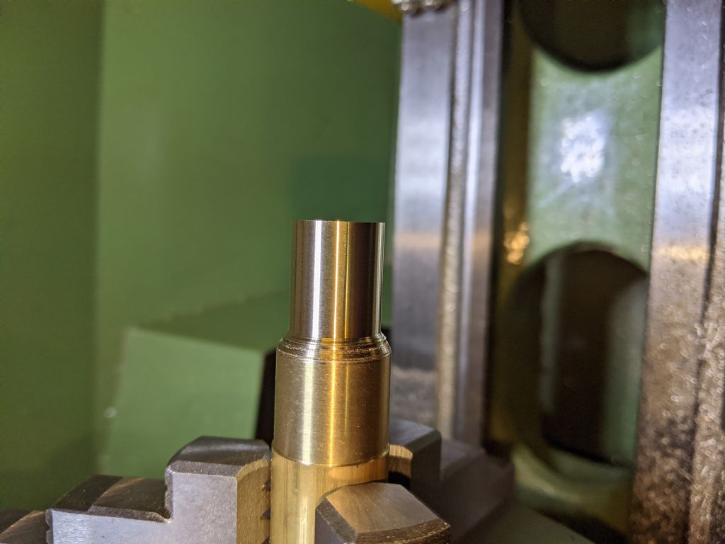

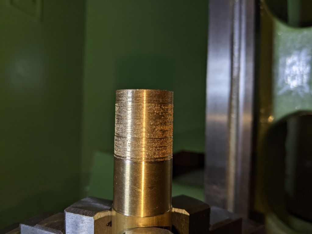

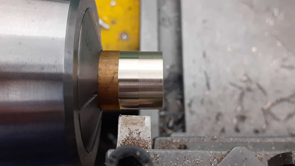

        Hi everyone,
        Another 'what am I doing wrong' question, I'm afraid.
        Everything I read suggests that carbide tips are difficult to work with and HSS very forgiving. If that's right, why can I get the finish in photo A using carbide, and no matter what I try, get the result in photo B with HSS? I must be doing something very wrong indeed…
        Photo A
        Photo B
        The lathe is a Warco WM240B – with belt drive. The stock is 20mm dia. brass, with about 2 inches out of the chuck. Carbide produces this finish on a first-pass at either 620 or 1,000 rpm. HSS makes the mess in photo B at all available speeds from 240 – 2,0000 rpm. The only thing I haven't tried is the lowest speed of 120 rpm. The HSS is a right-handed pre-ground knife straight out of the bag from Arc, and I've tried it square on to the stock and at slight angles – in both directions! Hand feeding or running off the gears at 0.1mm / rev creates the same result.
        It's brass, a new knife – not home ground, The more I read, the more I think it should be a great finish and easy…obviously beyond me at present! sad
        If anyone can point me in the right direction, I would be extremely grateful – and I could stop depleting the world supply of brass trying to get it right!

          Can you show us the HSS tool please? Maybe that will help with diagnosis. Don't lose hope!

            Almost certainly something wrong with the tool or setup. The only caveat is what type of brass? The most common type, CZ121, should be easy with carbide or HSS, but some alloys can be problematic.

              HSS tools for brass usually have zero side and back rake. The pre-ground HSS usually have a groove ground in the top that makes them too "sharp" for brass. What type of Carbide are you using? The brazed tip type usually have little or no rake.

                Radius the tip and travel faster might help. I think that looks like a very pointy tip has been travelling too slowly and has cut a very fine thread.

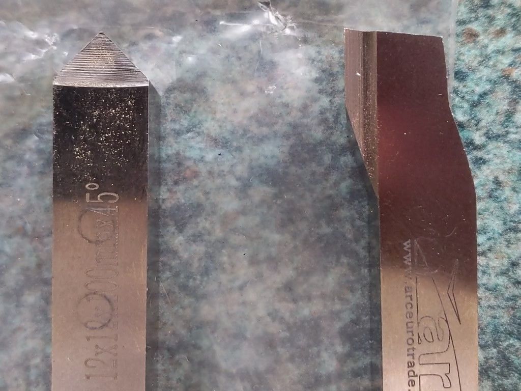

                  Hi everyone,

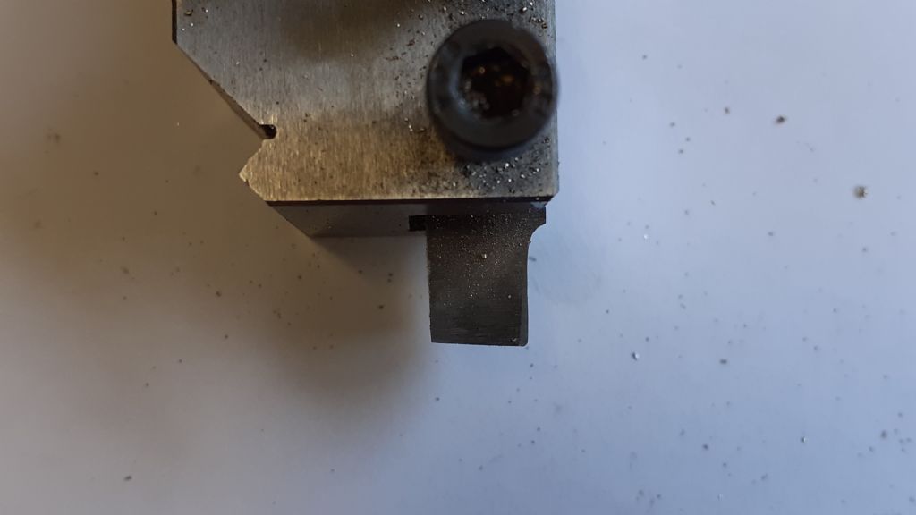

                  Here's the HSS knife I've tried – I've also included the neutral tool I had a go with briefly.
                  The carbide tips are CCGT specifically for non-ferrous, and the brass is off-the-shelf stuff from metals4u.

                    The one on the right has a bit too much top rake to be ideal for brass and out of the bag could so with the end rubbing with a diamond stone.
                    The one on the left could do with the top and two 45deg faces rubbing on a diamond stone as it does not look sharp which brass likes.
                    If you have a bench grinder I would suggest having a go at grinding the other end of the RH one. leave the top alone and just grind the end and LH side to 5degrees
                    I would not radius the tip of that RH tool as the groove means you will get even worse rake and it will be hard to set to ctr height

                        The tool on the right is too sharp and pointed for brass.
                        I would use a round nose, maybe 1/2 mm radius with zero rake on the top and left side and about 10 degrees on the front.
                        I do agree that in the second picture it looks like a very fine thread !

                              Strange – I use that type of knife on brass without bother.
                              Roderick and Martin may be on to something; a sharp tool, taking a shallow cut at low feed rate, might scratch the surface and nip swarf into the grooves. Try taking a deeper cut and increase the feed rate.
                              Also, check the change gears if they've been messed with recently: I've been known to put them back wrong. I hesitate to admit it but last time I produced a finish like that, the lathe was in reverse. Blush.
                              Carbide may be doing better because its bluntness smooths out the furrows. There's no reason HSS shouldn't cut as well as carbide.

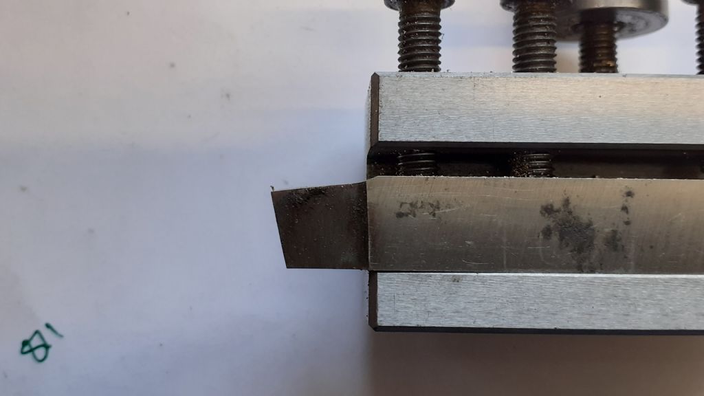

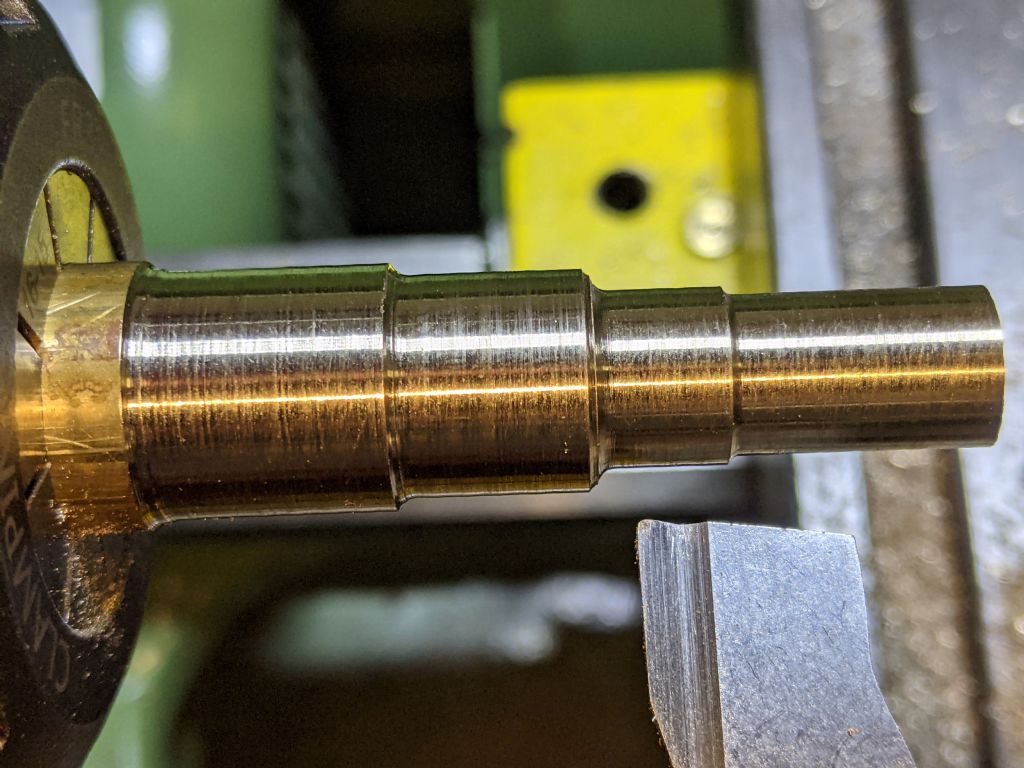

                                      After an evening of experimentation, I've made some progress – definitely better than my earlier HSS attempt, but not there yet.
                                      I haven't tried increasing the feed rate yet – I've only got two choices, and changing means swapping over the gears each time. Something to try if 0.1mm / rev really is too slow. I've eased the tip of the knife in the photo, and tried it on the various diameters of brass you can see at a speed of 620 rpm, and with various cut depths, ending up at about 0.2mm as indicated on the handwheel. Adjusting the knife angle as Mick B1 mentions produced a slightly better finish, although I suspect I am not cutting deep enough yet to make this a significant factor. Maybe my next step should be to follow the poster from Steve's Workshop and try grinding my own. Need to get an india stone as well – this easing was done with a diamond credit card.
                                      The sooner I get this sorted, the sooner I'll stop wearing my fingers out moving the belt every few minutes to try different speeds. This is where I really wish I'd got a variable speed machine!

                                        Your diamond credit card might be as good as my India oilstone, or better. Just saying what works for me. A polished finish on the tool tip helps if other factors are right.
                                        Some HSS is better than other for tools. I have a knife tool that looks like yours that has a sort of brittle-crumbly microstructure, and I don't get on well with it. I prefer straight 1/4" square-section HSS blanks ground to suit, on a packing-piece I made to set them on centre-height.

                                          Experimentally, just to test the hypothesis wind the saddle over fast by hand rather than driving it with the lead-screw. If finish improves, it could be due to the faster feed by hand, or because the saddle is being rocked by by a bent lead-screw or the half-nuts not engaging properly. Not sure how to prove the saddle is rocking, because the movement will be be tiny. Perhaps run a DTI mounted on the saddle along a rod in the chuck. Can't try myself because my workshop's filled with empty boxes pending daughter moving house soon!
                                          Another thought, if the saddle has been crashed into the headstock, the pin protecting the lead-screw may have sheared and is acting as a slipping clutch, ie the cut progresses by fits and starts. With the lead-screw engaged and turning try holding the saddle to stop it moving: if the lead-screw stops, the shear-pin needs to be knocked out and replaced.

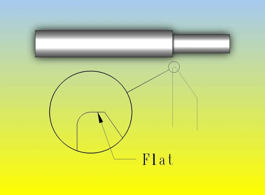

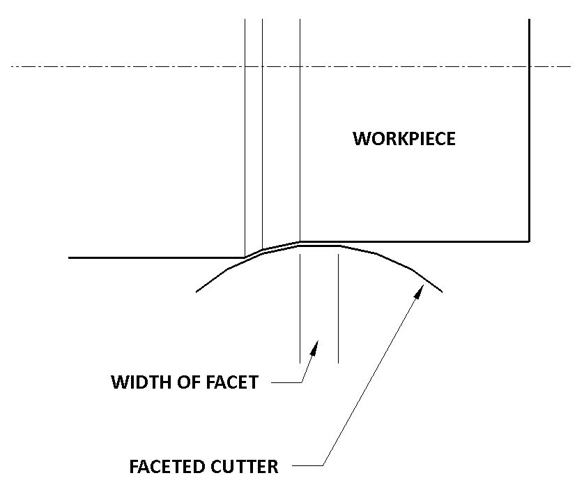

                                                … Back in’t toolroom in the 50s and adopted frequently during the building of my skeleton clock (and other projects), I used this technique for fine finishing. The result is not unlike JasonB produces. Oh! and for brass in particular, no top rake.
                                                The (HSS) tool tip is modified in line with a technique called diamond turning*. The flat, stoned parallel with the saddle traverse, spans a little more than the pitch of the feed.
                                                Cheers,
                                                Sam
                                                *I haven’t been able to find any reference to 'diamond turning' as applied in this context, but it has nothing to do with diamond as a material, but the faceting.

                                                  It may be that folk are confusing using the Diamond Turning Tool (A tangential turning tool ) from Eccentric Engineering, with diamond turning..
                                                  It is called the Diamond Tool, because the ground face of the toolbit is diamond shaped.
                                                  Quite a few people have made their own tangential turning tools (At least two designs have been published in MEW )
                                                  Howard

                                                    For clarification, my recollection of ‘diamond turning’ takes me back to either ONC or HNC Mech. Eng.
                                                    I can’t be sure if the tool tip was an actual faceted diamond.
                                                    The particular facet was set to be parallel with the traverse using a microscope, while the width of the facet spanned the feed pitch.
                                                    I seem to recall it was used mainly for aluminium in the aircraft industry, but not sure.
