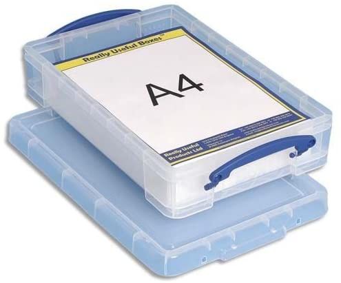

                                                I think I would just go to the local stationers or visit Amazon and buy a really useful A4 boxwink

                                                  @Journeyman – Yes, I am extremely familiar with the Really Useful boxes. However they do not have collapsible side walls.
