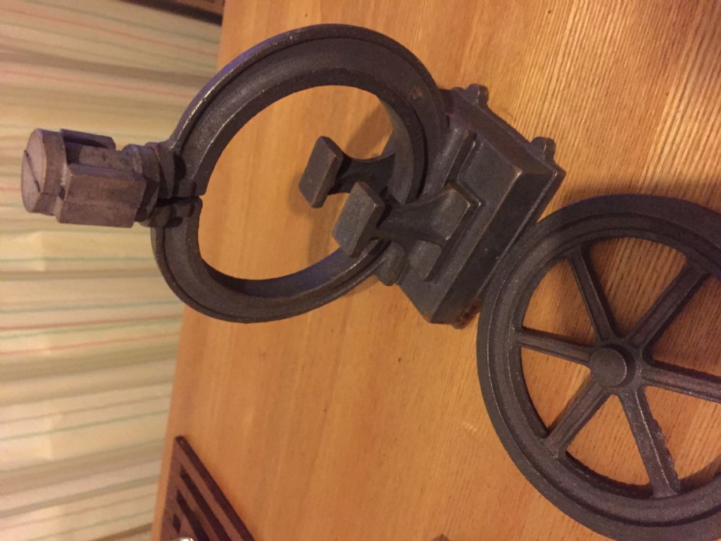

        I have been givenimg_0424.jpg some castings for an interesting model. I do not know if they are all for the same model. I have assembled some how I think that they might go. Can anyone identify the model? Thanks.

          I think they are tubal cains engine – Tom Walshaw- the cylinder rotates in the central casting I seem to remember with a roller on the end of the piston rod. The cylinder rotates in the frame, fed by steam through its trunnions. Valve was driven by a fixed eccentric sheve with a rotating strap It was a published design perhaps 20 years ago in EIM or Model Engineer. A very neat and brilliant mantle shelf engine. Good luck! I seem to remember the machining of the frame was quite involved. A gyrations challenge ……..but I’m working from distant memories…..

            Look up Coomber Rotary engine

              My recollection is that the frame needs to be given just the right amount of play in just the right places – it isn't circular either, so you do need TC's description unless you want a lot of head scratching.

                  Thank you very much for the quick replies. I will have to do some research to see if I can find the drawings.
