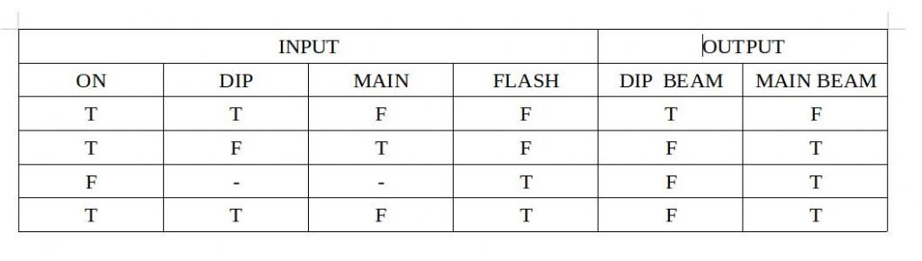

                              Posted by noel shelley on 16/11/2022 20:16:08:
                              It very much depends on what micro switches and relays you have as to how it was wired up. The simple answer would be to use a dip switch of the floor mounted type used in the 60s/70s ! fused side light circuit NO fuse on a headlight circuit, panel switch to dip switch and 2 wires to each bulb, no micro switches and NO relays. Each bulb wired to chassis. Flasher – ignition live to flash switch then to coil and other coil connection to chassis. Fused live from battery or light switch to moving contact main beam filaments to NO contact.use a 20A relay If using auto motive relays then connection 31 is ground/chassis Noel.
                              Having drawn a partial truth table, the hard part is the last entry:
                              If the headlights are On AND Dipped, then Flash has to turn the Dipped Beam off and the Main beam on. I think it's easy if a change over relay is available, but I've not spotted a way of doing it with a simple on/off relay.

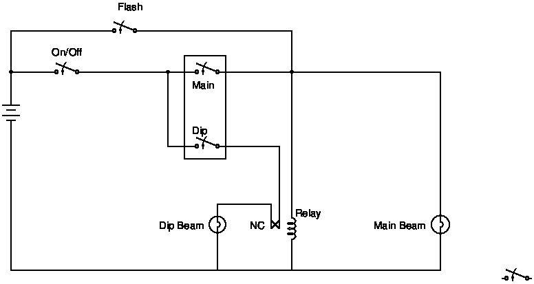

                                          For review:
                                          I think Tim's lights obey the following logic:
                                          1. Flash always turns on main (high beam)
                                          2. When main beam is ON, dip beam is always OFF
                                          3. Headlight ON allows two switches to activate either dip or main, but not both
                                          I suggest this circuit, which assumes a relay with a Normally Closed contact.
                                          The relay disconnects the dip lamps whenever the main beam is on.
                                          Comment: strictly speaking only one switch is needed in the Dip/Main selector. But the circuit shown allows dip to go OFF just before main comes ON, and vice versa.
                                          I've not tested the circuit.

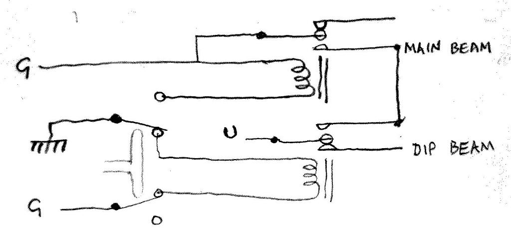

                                                    #621491
                                                    Tim Stevens
                                                      @timstevens64731
                                                      Right – you now have the diagram.
                                                      Got it – at last.
                                                      The dip switch assembly is lower left, operated by the faint outline of a T sideways. This moves up for flash, in the middle as shown for Dip, and down for main beam. The ends of the T push the microswitch blades across to the further contact (ring shaped). The relays are on the right and shown in the conventional manner.
                                                      G is the green always-on 12 volts in.
                                                      U is the blue feed 12 volts from the headlamps switch.
                                                      The top output from the relay is not connected, neither is the bottom output from the lower microswitch.
                                                      The Dip (as shown) works because it is fed from Green to earth, and so draws a very small current at almost all times (ie except when the flash or main is needed.)
                                                      Do let me know if I have got it all wrong.
