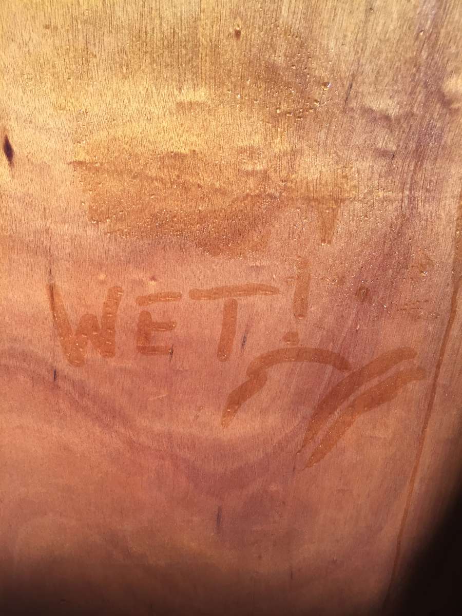

      Thanks to Bazyle and Rod for the recommendation to use either an oil filled radiator or wall mounted tubular heater which seem to me to be the safest way to go to prevent the workshop temperature falling too low and thereby producing condensation.
      As I mentioned in my earlier post I am in the fortunate position of having a fairly well insulated workshop but will be boosting the amount of insulation in the garage roof as this is relatively easy to do.
      Just to show how easy condensation forms outside of the workshop in the part of my double garage still used as a garage (in theory) look at the picture I took about a year ago of the workshop door when it was cold and damp. Fortunately inside the workshop there was no condensation on the mill or lathe as the frost stat on the fan heater kept the air temperature high enough to stop the condensation forming. Like most garages these days mine has ended up as a dumping ground for all sorts of things including me using it when I need more space!

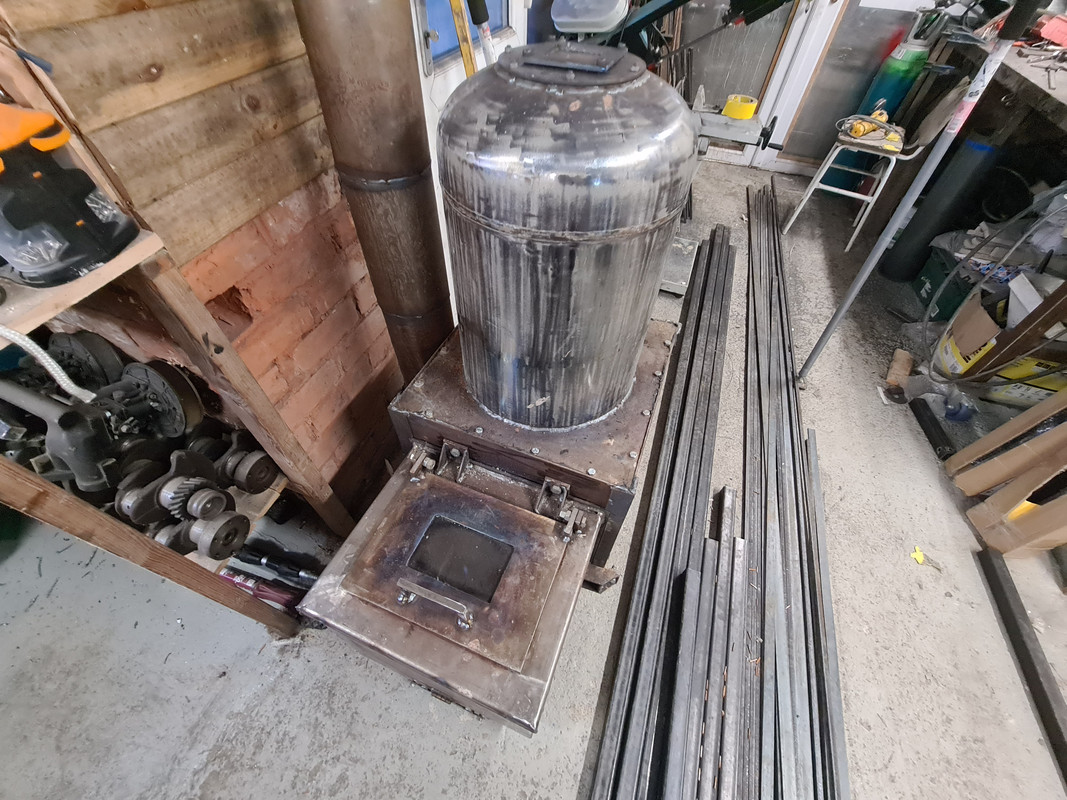

            I built my workshop a few years ago and it was part concrete panels…ill put pics up as its easier. but its works area wise at 24 foot x 12 with an 8×4 shelved area. Condenstation was bad at first untill i insulated it
            Before i insulated it the 5kw cheapo chinese DH was useless and the cost on diesel was to much to keep running at around £7per 8-10 hr day. It wasnt great deal better once insulated.
            I now get Kerosene for 96pl but i have fitted a 2kw to the house. the 5kw is sat doing nothing now as i made and fitted a mass air heater stove.
            Oh in the middle of all that i insulated part the concrete panels with rockwool. roof is 75mm metal clad panels. cost a fair bit but excellent. NO condensation at all.
            the only insulation is on the back wall behind the lathe and flypress area. also behind the stove cladding. all gaps filled wit expanding foam. well most as i want a bit of air circulation still.
            Stove is a good size and works great. the domed section is part of a 47kg LPG cylinder to give an idea on size.
            It burns wood only and 99% smoke free for smoke free zone worriers. and will burn toasty all day on a euro pallet and half.
            I have no condensation at all with this partly insulated set up.

                      @Wayne Ollerenshaw..
                      ..if you ever got round to sticking even a rough pencil sketch of the construction of your stove into an album somewhere or a link to likewise I’d be interested in seeing it..

                              I see what pics i have as i had a fair few and should help with the idea. there are a few ways to do int and a lot better hear output but this is more than enough so i never fettled. it to gain more output.
                              But yes i do a build thread when i get 10 mins.
