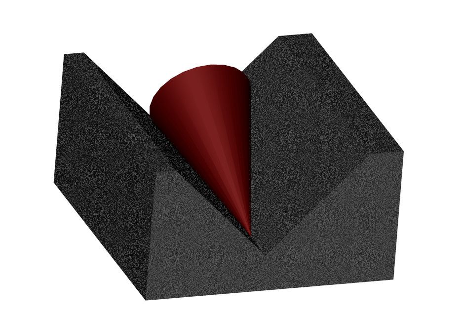

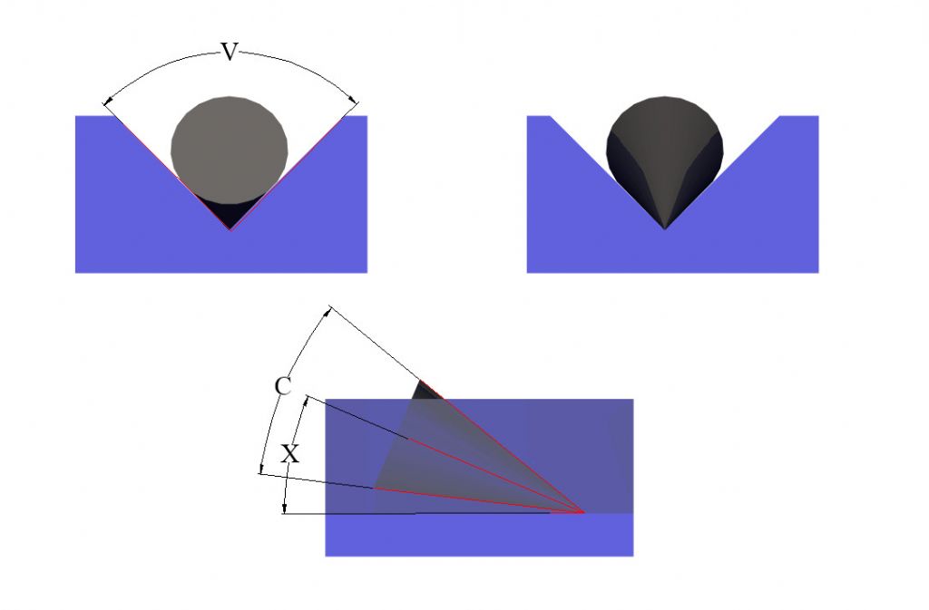

      The diagrams show a V-groove in a solid block. The angle of the groove is V.
      There is a right circular cone, included angle C, resting in the groove. The point of the cone is at the bottom of the groove, and the cone just lies there touching both sides of the groove. The axis of the cone now lies at some angle X relative to the bottom of the groove.
      The problem is simple: what is angle X?

                Jason is right, I'm looking for a formula that calculates X for various values of C and V.

                    For those that don't have cad and want to see if they can come up with a formula then these are some random CAD values.
                    V = 80deg
                    C = 40deg included angle
                    X = 32.15deg

                          This looks like it may do, going to try it with those figures
                          Edited By JasonB on 27/03/2019 14:03:57
                          #402416
                            yes that works
                            Sin X = Sin M x Cosec N
                            Where M is half the value of C and N is half the Value of V from the original question.
                            So taking those CAD figures I posted earlier
                            Sin X = Sin 20 x Cosec 40
                            Sin X = 0.342 x 1.558
                            Sin X = 0.533
                            X = 32.21 which allowing for me rounding to 3 decimal places is right.

                              Thanks Jason, I can verify that formula does work.
                              How did you do it in CAD? I could only do it by trial and error.
                              #402418
                              John Haine
                                @johnhaine32865
                                Or sin(x) = sin(M/2)/sin(V/2) since csc(x) = 1/sin(x)

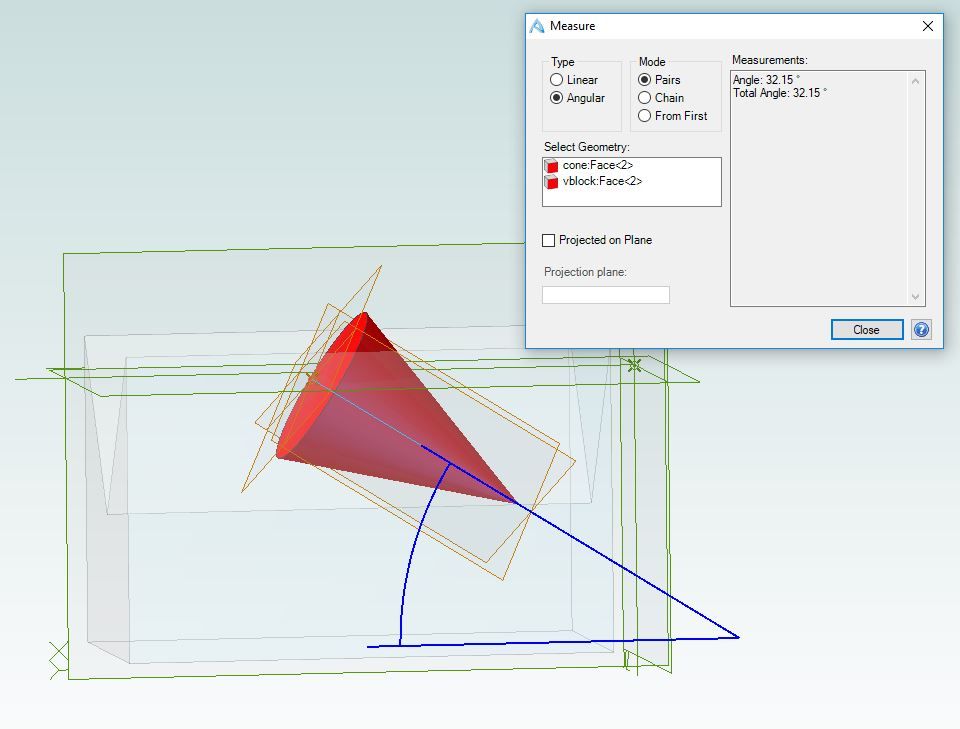

                                  I drew out the vee block and cone to those angles which is easy enough. I then assembled the two using a tangental mate to first mate the slope of the cone to one side of the vee and then a second similar mate to get it to sit against that. Then just a case of measuring the angle between base and the central axis is the cone. I've made the block semi transparent so you can see things better

                                      I tried, and failed to do it in Fusion, which is the reason I wanted a formula. Fusion doesn't use mates – it uses something called joints instead, which I couldn't make work.
