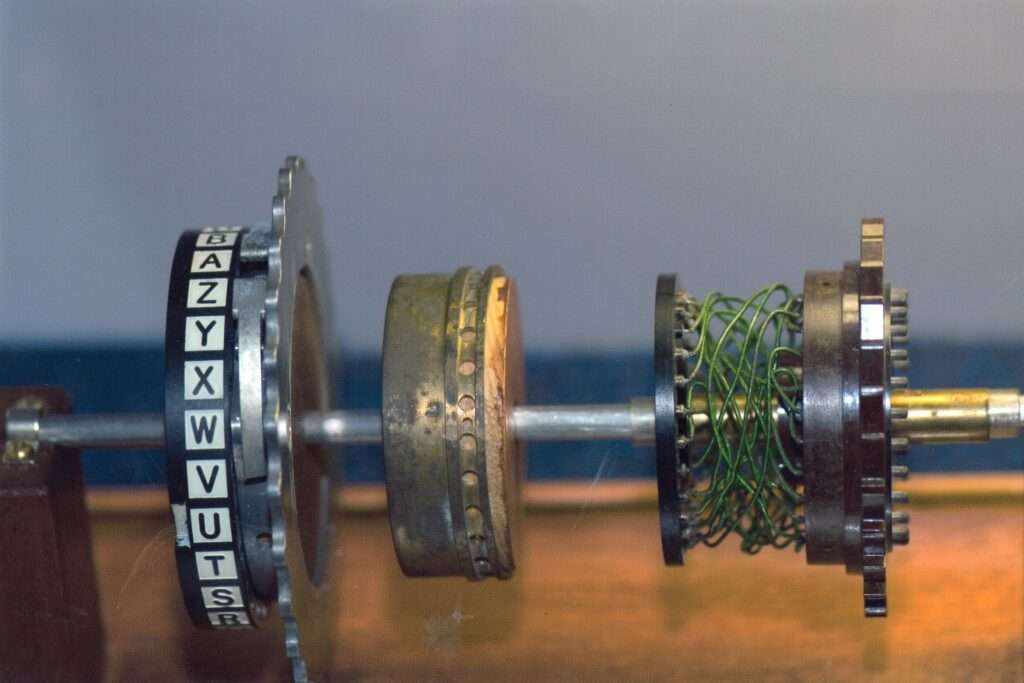

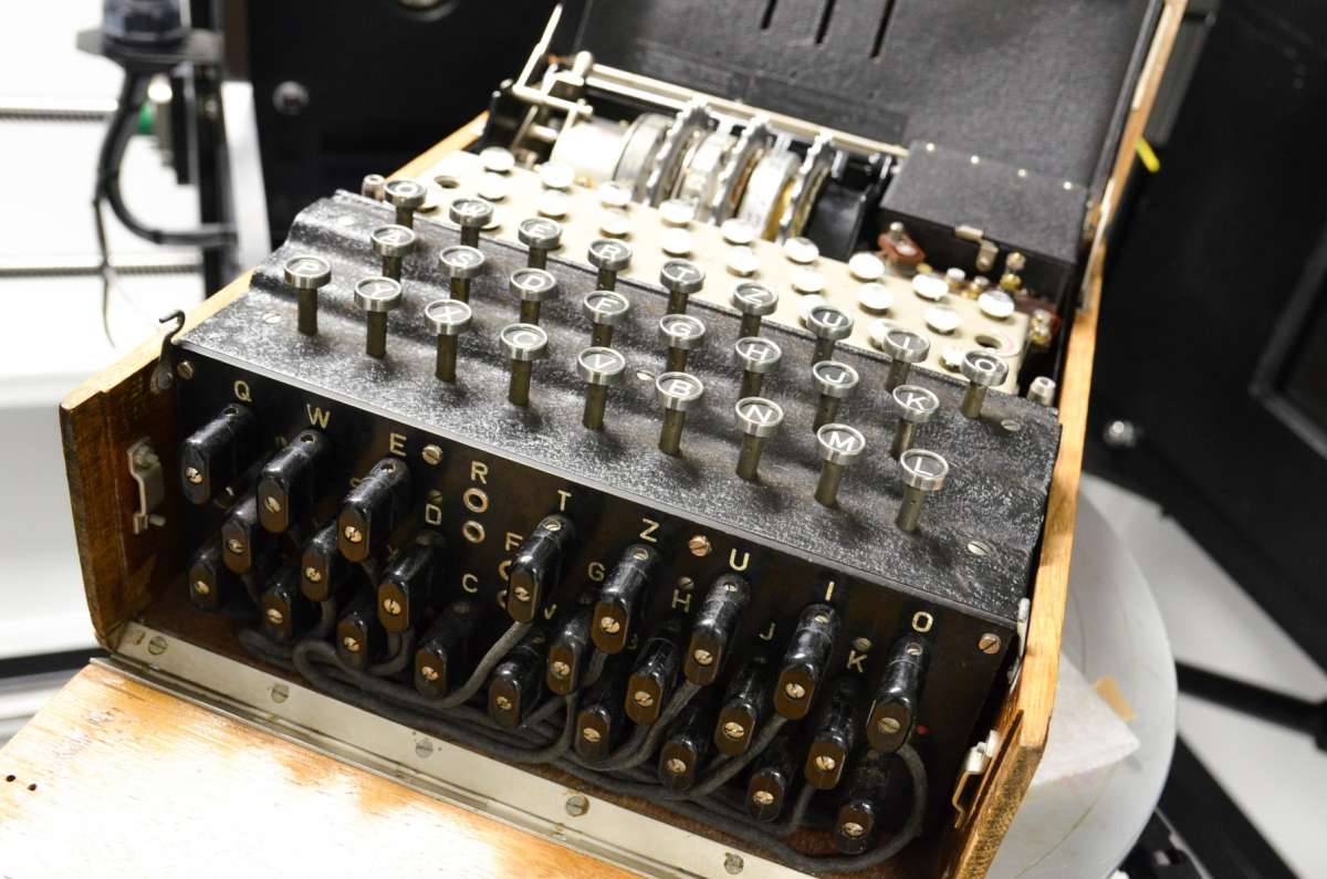

      Typical photo off the web.
      1920_enigmamachine-schoolofmathematics-universityofmanchester-2-986340

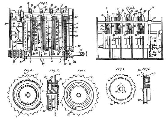

      and this drawing:
      enigmadwg
      The web shows several Enigma variations existed, so lots of guesswork ahead, and my effort may not be like any of them.  This is my first attempt, about 5 hours work yesterday. A 26 toothed ratchet wheel missing, and I’m not sure how rotors 2 and 3 are turned over.

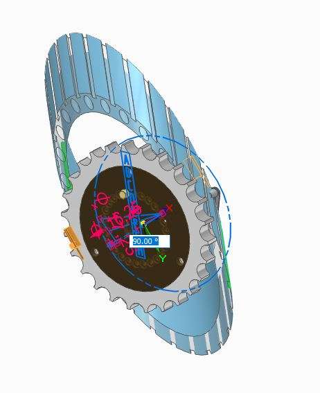

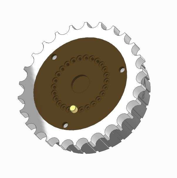

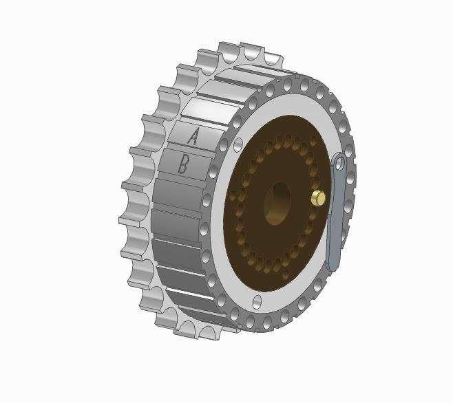

      Began by modelling the Aluminium thumb wheel which is the main part of the rotor.   It determines the size of all the other components, all of which are modelled as an Assembly from this component.  When I eventually got to the brass electrical contact pins, of which 208 are needed, the head is only ⌀1.8mm with an M1 threaded shaft.  A watchmaking size, and my WM280 doesn’t make producing tiny things easy!  Can be done, but this shrieks ‘production problem’, so I’m tempted to double the scale.   With luck SE has a tool that scales all the parts in an assembly with one click.  Bet it doesn’t, I’m expecting to find that all the parts have to be scaled individually and re-assembled!   Another mistake, the alphabet ring is too wide, and I’ve put it’s spring lock on the wrong side.  Also need to change some internal pillars to make more room inside the wiring chamber.
      3D-CAD helps find design blunders without cutting metal.   Physically making a rotor only to find it’s wrong must hurt.
      A few negatives about SE.  Adding A to Z lettering to the curved alphabet wheel is long-winded and all eagle-eyed inspectors will have noticed the B is a mirror image.  Flipping it was too difficult yesterday, so another baffled learner session needed.  Would be handy if SE could change several parts in an assembly with one operation in situ, like sharpening a pencil, but, apart from the hole tool, I’ve not found a way, so more work!   SE allows complex features to be copied, but all the faces have to be selected.   How to edit a repeated complex feature later on took time to understand – not done as I expected.
      Have an hour to do add the pawl gear now, maybe, more.  Will report again if I make progress.

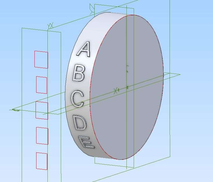

      #778483
        Can  you not wrap ABCD………….XYZ as a single strip onto the curved surface? May need doing to a smooth surface before you cut the shallow slots
        WRAP
        #778484
          Or if engraved
          wrap 2
          Though it looks like the letters are flush with teh cylindrical surface and have the square background engraved to depth

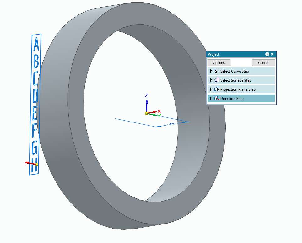

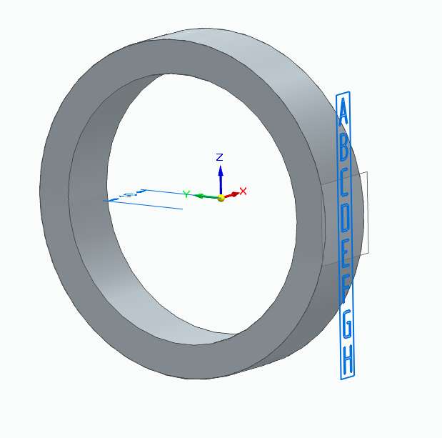

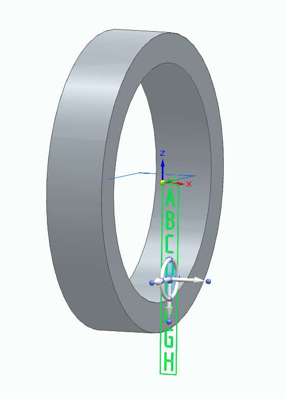

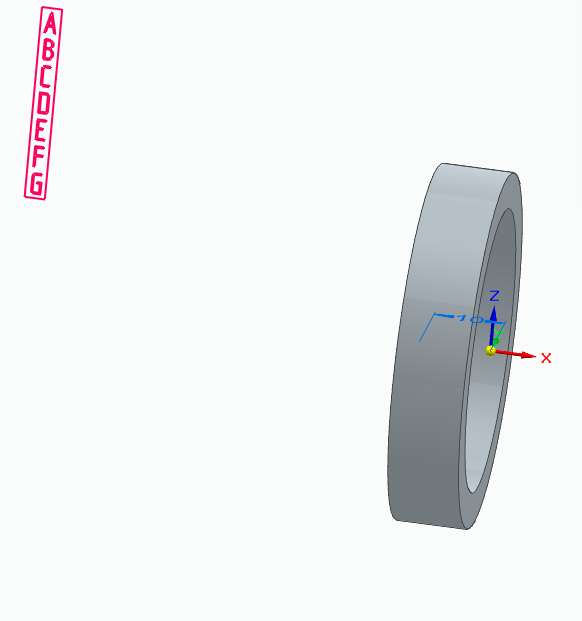

            Good idea, I’ll experiment.  Yesterday I couldn’t see how to type in a vertical strip, and now think I was being dim.
            Here’s the result: SE produces the vertical strip, but in the wrong plane.   Hope Nigel is reading this, because when I tried to rotate the text box, the model went wild!   On the right track, I feel, except I’m doing something wrong, maybe selecting too much.
            wonky
            I’ll come back to it later.
            Thanks for the advice,

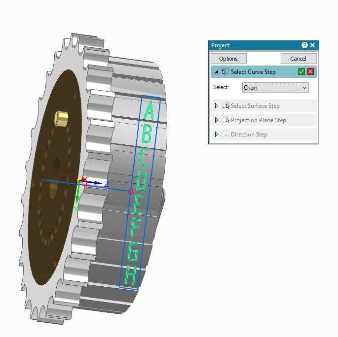

              Aha, the problem is selecting the text directly on screen opens SE’s text reposition tool which doesn’t do rotate, why not I wonder?  But if the sketch is selected from the pathfinder tree, the SE wheel tool opens instead, and it does rotate and more.
              textproject
              That done the project sketch tool still won’t select the curve though.  I bet money it’s because the curve has been segmented as Jason says.   So this has to be done in the right order.  Project letters first, then emboss/engrave them, then add the segments.  Have to change the alphabet ring because it’s too wide and will apply both changes when I get to back to it.
              Many thanks,

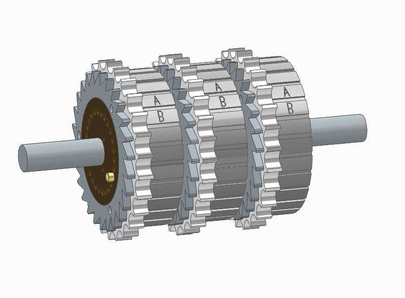

                    Another practical worry; I’ve modelled the rotors as having a 6.00mm diameter hole through which a 6.00mm shaft passes.  Far too tight for a 3D printed build, and OTT if I make it in metal.  I ought to look at how SE manages tolerances.
                    Bedtime – tiring work!
                    enigmaAxleAssy
                    Cheers,

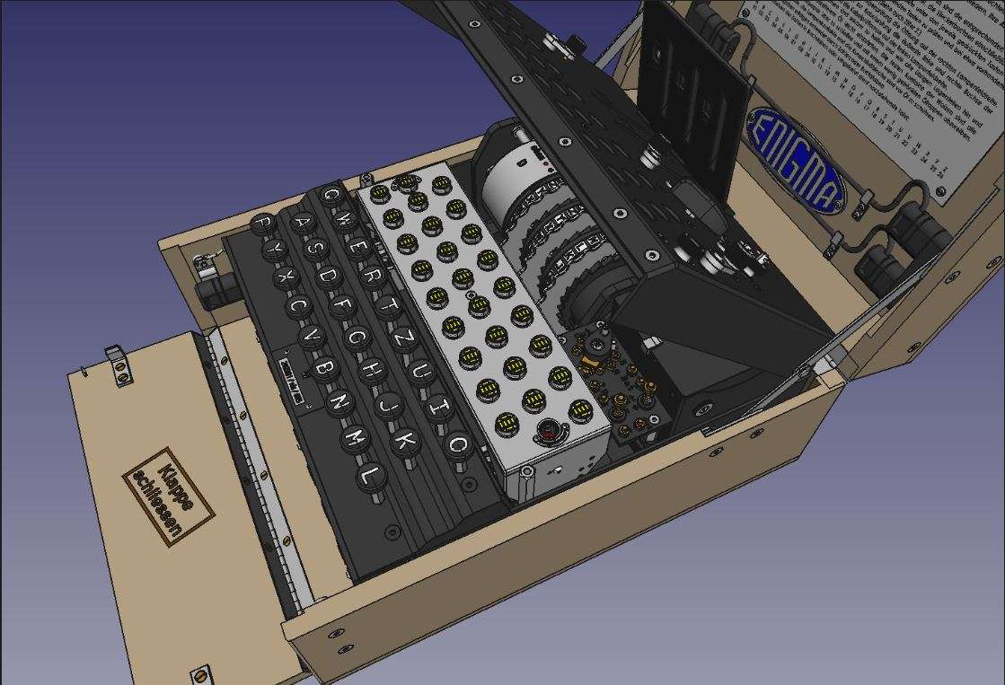

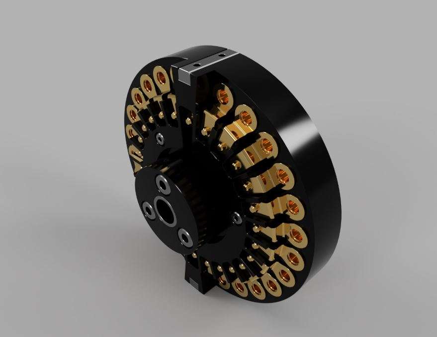

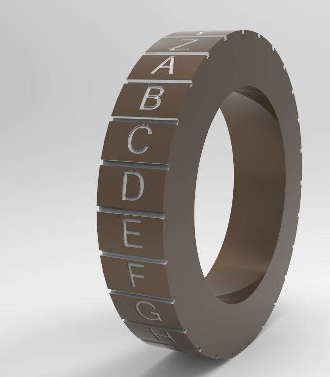

                              What’s keeping you Dave. All done here😉😉
                              enima4
                              enima1
                              #778738

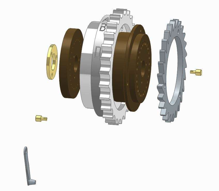

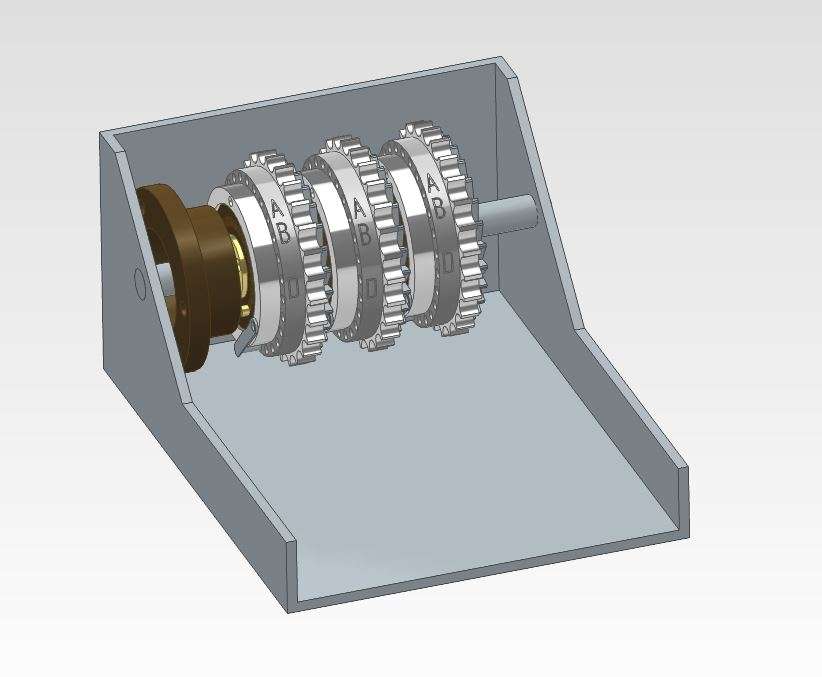

                                Bad day here.  First lost a post this morning acknowledging advice.  Then wasted most of the afternoon trying to put letters on the alphabet ring, an unsatisfactory tale of woe.
                                I did manage to sort out the brown wiring cage and add a brass washer, but the rotor assemby is poorly at the moment, not exploding properly…
                                rotorexplode

                                  Khan’s book I cited has some diagrams (pp 338-9) from patent applications and a German naval manual. The first is from inventor Arthus Scherbius’ initial patent in the US for it.
                                  The naval manual diagram is the basic electrical circuit of the Service machine, though how usefully without the accompanying text I would not like to say. It does show five rotors: input, the three rotable ones and the one described as the “reversing rotor” – which appears to send the current back through the others, doubling the cypher effect.

                                    I’ve been naughty this evening and added the reflector (brown object on left) and a frame rather than having another go at the letters.  Therapeutic, I can go to bed having got something done.
                                    The picture shows problems with the letters:
                                    enigmaInFrame
                                    They are too big.  I need to calculate the height in mm of 26 letters wrapped round that circumference and correct the sketch.  A-Z only, no numbers, spaces or punctuation.  (Although some original rotors are marked 01 for A, 02 for B etc.  I don’t know why!)
                                    C is missing because extrude says the sketch has errors.   A, B and D look OK, but the cuts aren’t right when zoomed in.  Not good, something is wrong!

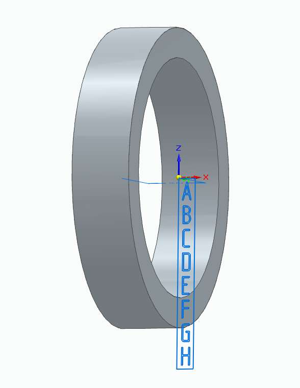

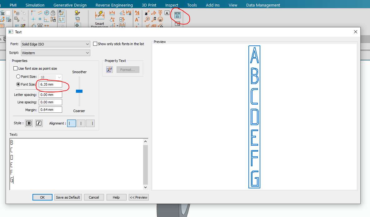

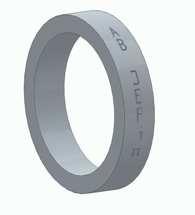

                                                Here’s how I’m doing it.

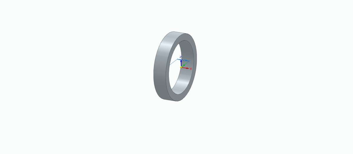

                                                First, a ring produced conventionally:
                                                sebasicring
                                                Then created a vertical A-Z list with the Text Profile tool:
                                                setextprofile
                                                This creates a sketch containing the text:
                                                SEalphasketch
                                                Wanting to try the Wrap tool, I located the text sketch on the ZX plane:
                                                SEsketchonXZ
                                                Then selected the sketch in the Pathfinder list, which opens SE’s wheel tool (allows stuff to be moved and rotated)
                                                SEsketchwithwheel
                                                Moved the sketch to align it with the ring:
                                                SEsketchaligned
                                                Then used the wrap too, which failed:
                                                SEwrapError

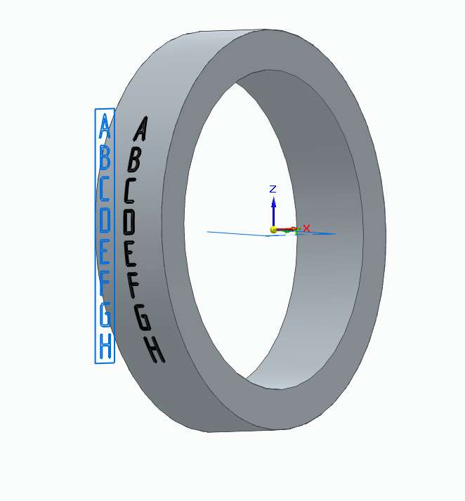

                                                Have an idea about what to do about that, but decided to try the Project tool.
                                                SESketchProject

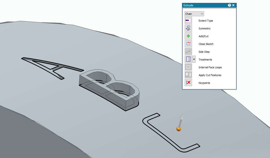

                                                This projected the text, but not all is well.  The H is stretched, so it doesn’t maintain text height:
                                                SEtextprojected
                                                Anyway, used the extrude tool on the projected text.  Only works on one letter at a time, with faulty results:
                                                SEextrudeyuk
                                                The ‘A’ cut is of unequal depths.
                                                The ‘B’ won’t cut, but it extrudes out and looks OK
                                                The ‘C’ won’t cut or add, and enters a different mode, and stops.
                                                Feels like SE is confused about which plane it’s in.  Maybe I’ve missed a step and have to tell it to extrude relative to the X-axis.  Somehow!
                                                Had a quick look for internet examples, and haven’t found anything quite like what I’m attempting.
                                                Ideally, I’d just type A-Z and a tool would automagically wrap it round the ring, and the extrude tool would work on all the letters together.   If SE does that, I’ve not found out how.

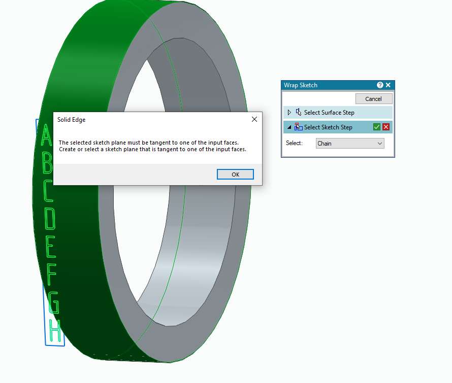

                                                #778841

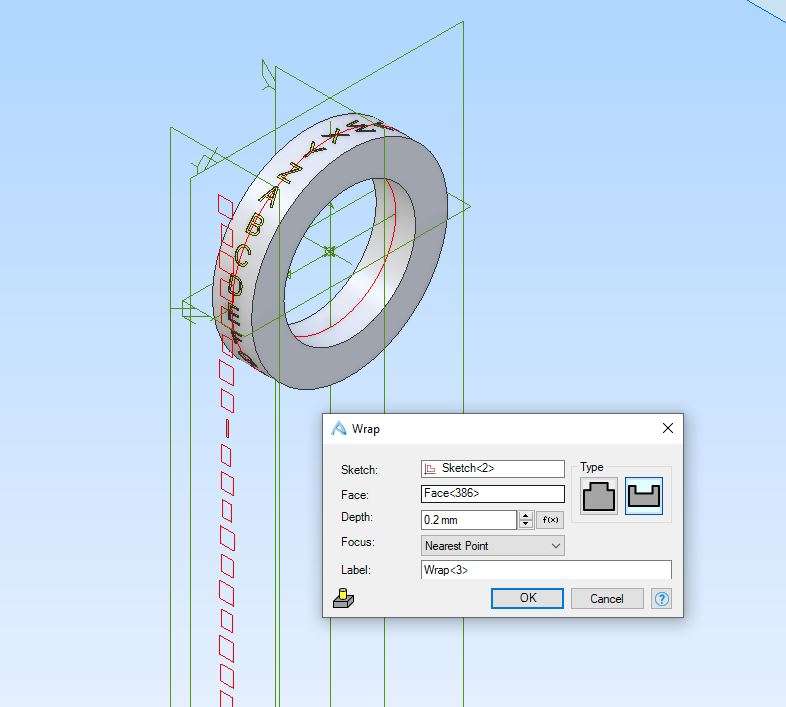

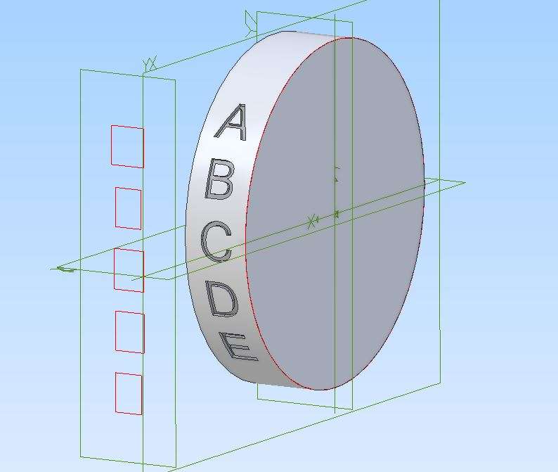

                                                  Dave, from the error message, is the plane you have the text on positioned 1/2 the dimameter of the ring away from the ctr of the ring so that it is tangent to the edge of the ring.
                                                  Alibre does not need it tangent but wrapping will keep depth or projection above the surfac econstant and all letter heights are the same, you just need to play with font height and line spacing to get them equal around the ring.
                                                  I did the slots after the letters, placing a rectangle between two letters and after a cut extrude did a 26 circle pattern
                                                  enima1
                                                  #778843
                                                    Alibre has the two icons top right of the wrap box depending if you want to engrave or have the letters proud
                                                    wrap
                                                    #778849
                                                      It wasn’t but that’s what tried just now. I created a plane tangent to the ring’s outer surface, and put the text on that:
                                                      SEtextprofileTangent
                                                      The wrap step works, or at least looks correct.  SE wrap does not have a built-in emboss/engrave action; after the letters are placed, they’re cut or raised with the Extrude tool. Clunky.   And when I do, the extrude doesn’t work properly, as can be seen below.  All these letters should be cut 1mm deep:
                                                      sewrapfail
                                                      Alibre seems to be better at this than SE!
                                                      Reckon about a third of the time spent on the enigma model has been wasted on this problem!
