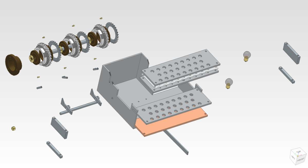

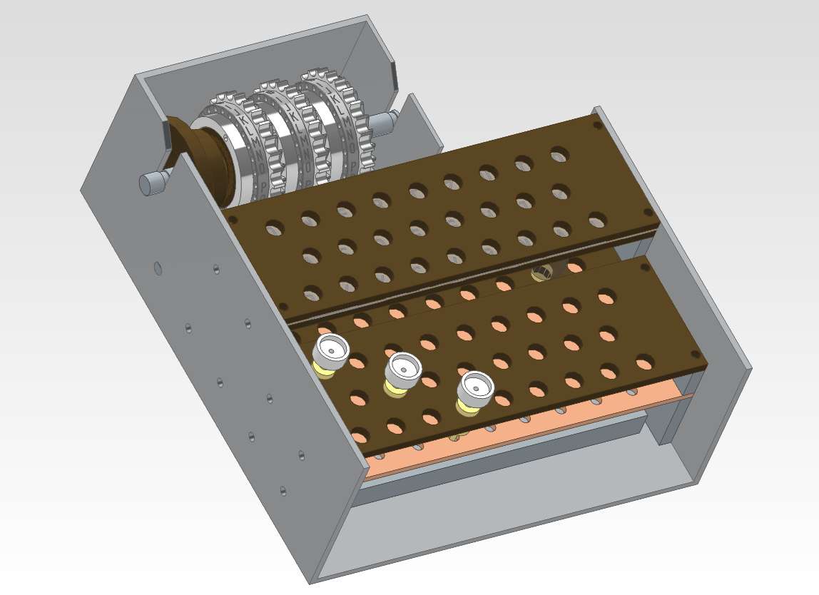

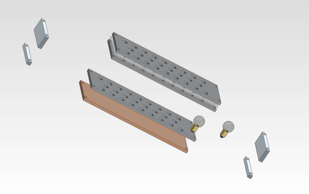

          More done on the lamp assembly:
          enigma23JFront
          enigma23JFtilt
          enigmaJ23exploded
          Pleased to say laying out QWERTZUID was straightforward.  After I realised this is a job for a fixed font!  Adjusting for a flat surface can be guesstimated and then tuned by eye.  Laying out vertically on a curve needs the maths and I shall have to have another go.
          Wasted loads of time on the MES10 thread so the bulb isn’t properly modelled.  Have to pay for the standard IEC60061-1 and I haven’t been able to determine the thread form.  It’s rounded, not a recognised V, square, Whitworth, Sellars, or BS fastener profile.   Also seems to be a weird mix of metric and Imperial measure.  E10 is 10mm diameter (tap 8.8mm) and 14tpi. Maybe mixed because it was defined in the USA by electricians who have always been metric.
          #779629
            Ordered a book earlier and it’s just arrived: “Inside Enigma” by Prof Tom Perera.  Lots of pictures, and it’s interesting to see what I got right and wrong.  Give myself 5/10, not bad for a freelance based on limited information, but my version wouldn’t impress a collector!   My rotors are on the left whilst the real one has them centred, and other details.
            Going to carry on with what I’ve got for the time being, but this new information means there will have to be a second attempt.   What I’ve done isn’t time wasted and I’m not tempted to try and reuse components from the prototype.  The whole lot can go into my electronic junkbox.   Next time I’ll get the scale right, and because I’ve honed my Solid Edge skills, should be much quicker – the experience will pay off!
            Mentioning re-use reminded me that I’ve been able to some parts repeatedly for different purposes, best example being the lamp-plate:

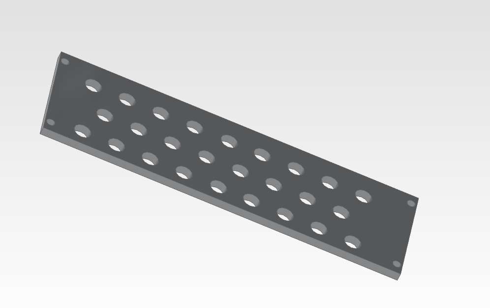

            lampplate
            It appears 3 times on the lamp assembly, and the same layout is used for the letters too.
            enigmaLampExplode
            I think the same part can be used in the keyboard, which is next on my list.

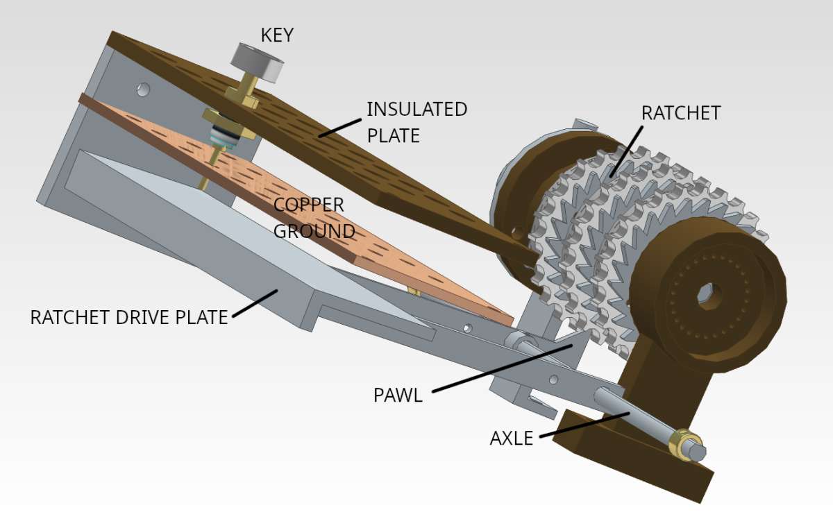

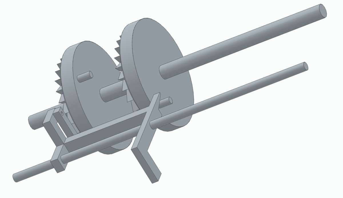

            #779769

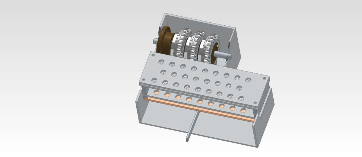

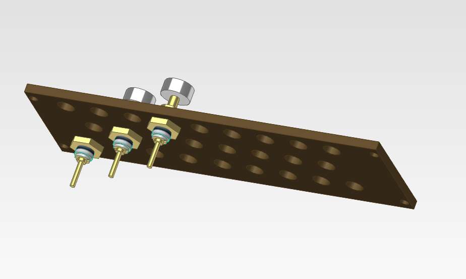

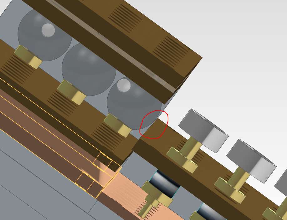

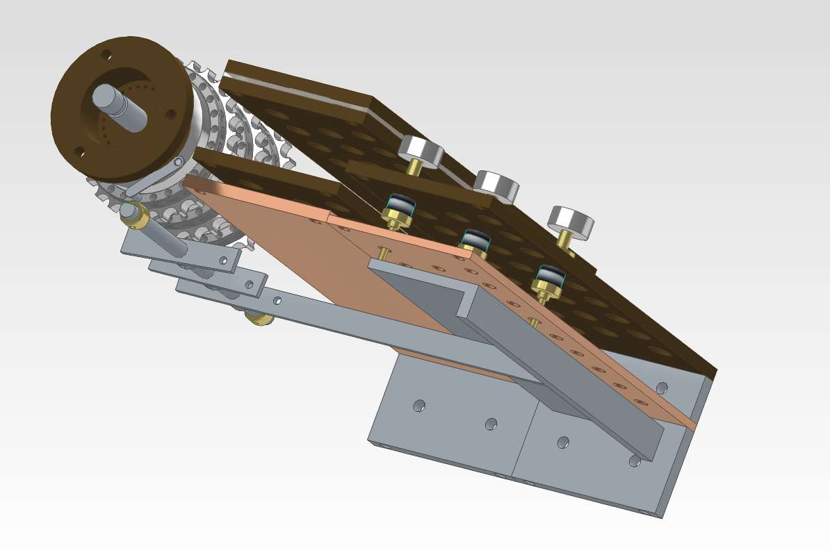

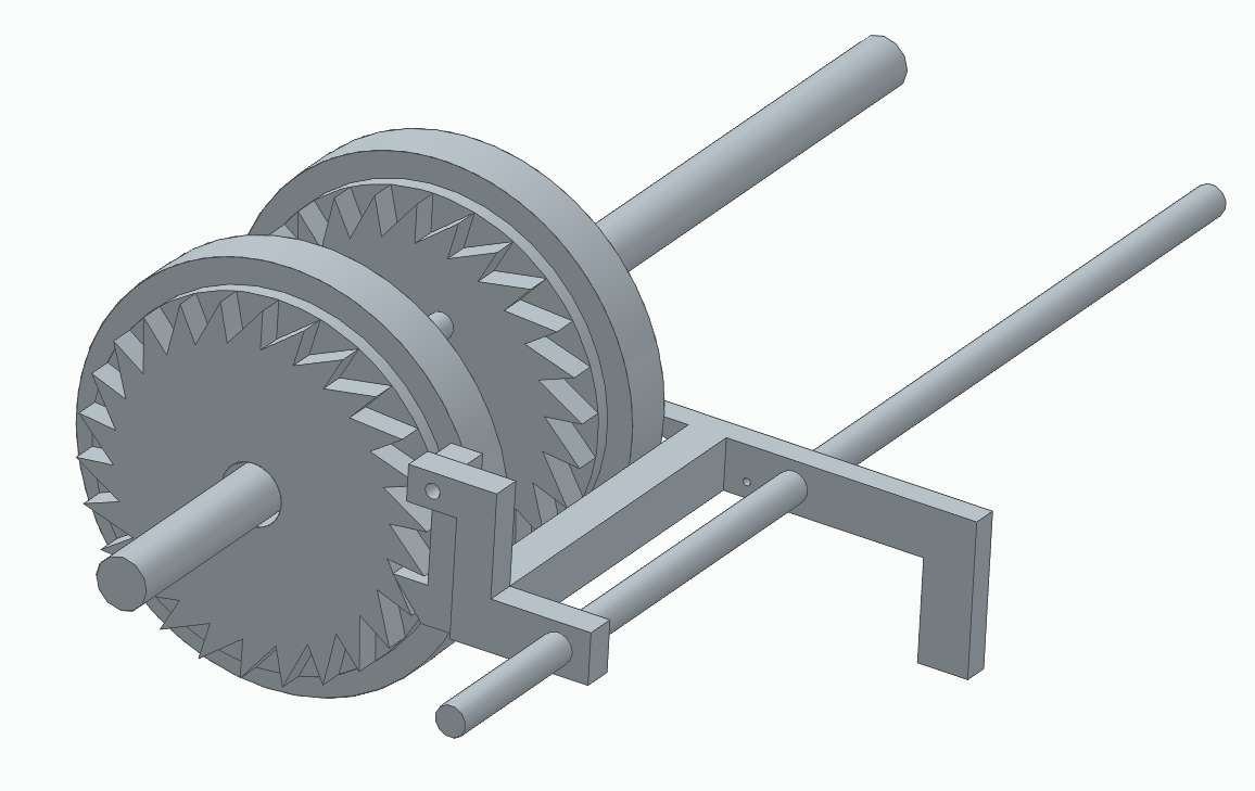

              Onwards and upwards.  Added the keyboard and a few keys, plus the paddle that advances the rotors.
              enigmaDrivePlate

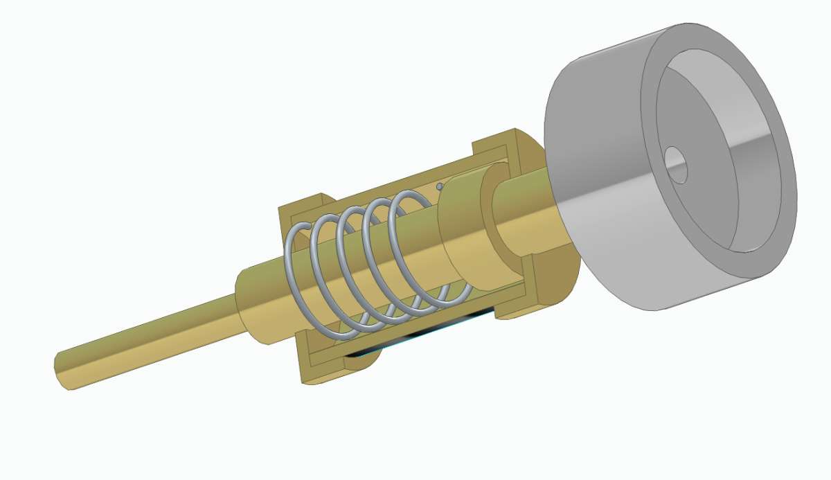

              The key is quite simple.  Pressing it passes a rod through a hole in the Copper plus volts plate and then, by pressing on the plate underneath, starts the rotor moving.  Finally a wider section of the rod completes the circuit by hitting the volts plate.  May be too simple!
              Section of a key:
              enigmaKeySection

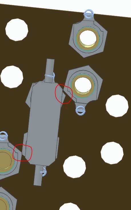

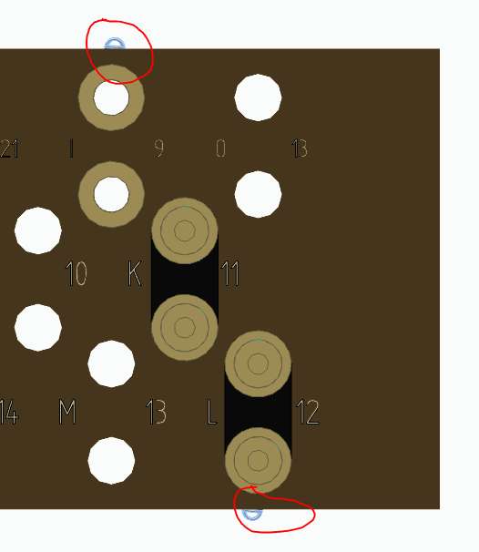

              Next image shows a near collision, ringed in red, which ought to be fixed, even though the 3V lamp has an exaggerated globe:
              emigmaCollision
              General view:
              enigmaJ24view
              Learned more about Solid Edge, nothing exciting, and got into trouble by trying to create an assembly that depended on itself.   Assemblies within assemblies within assemblies; my poor head!
              #779883

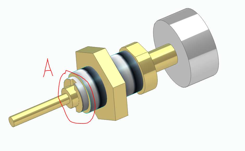

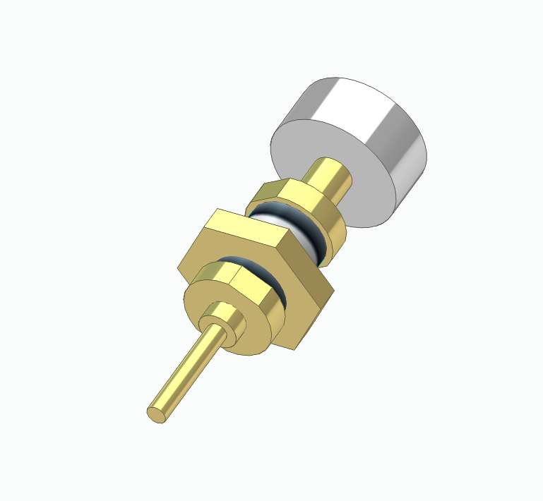

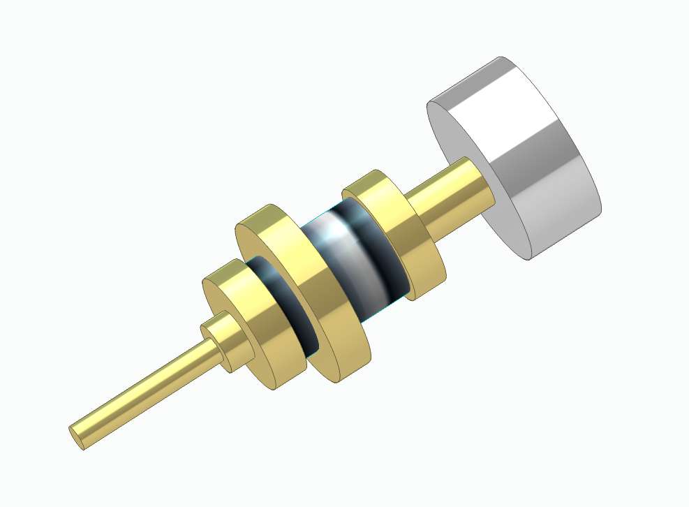

                Realised this morning my key design causes avoidable production and assembly time wasting.   As conceived I used the same end-cap at both ends, with a securing ring:
                enigmaKeybad
                Works in theory but!!!  First problem is the securing ring and end cap provide no way of gripping them for tightening.  So turn the ring into a nut and add flats to the end-cap:
                enigmaFlats
                But that leaves an even worse problem.  Using the same end-cap at both ends means each and every key has to be individually assembled on the mounting plate.   Better if keys can be assembled separately as units that just drop into the mounting plate and are secured with a nut.   Rather than having a tray of key parts, the assembler has a bix of ready to plug in keys.   Design change!   The lower end-cap is replaced by a plug, marked ‘A’ below:
                enigmaFixedKey
                Changing the key sub-assembly automatically updates the main model:
                enigmaKeyMounted
                Design requires a certain amount of thinking ahead.  Experience helps in cases like this: yes the design works and can be made as described, but it’s flawed.   Why did I miss it?  Partly inexperience with practical mechanical assembly problems, and partly brain fade.

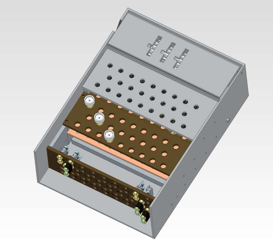

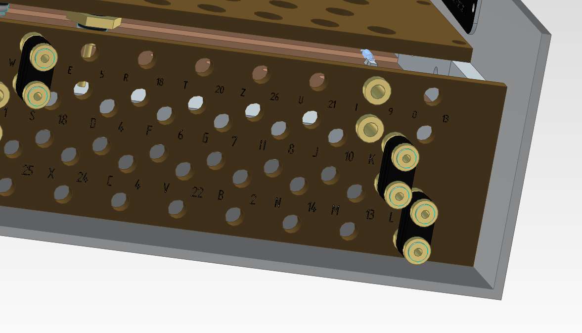

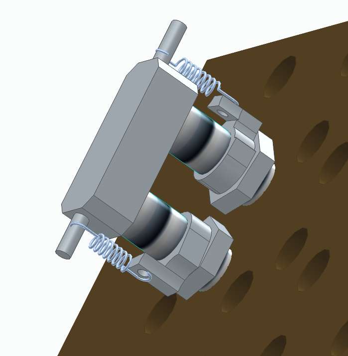

                  Are problems part of the fun?  I’ve smacked into a couple today working on the plugboard (Steckerbrett), and am bruised.
                  26 normally closed socket pairs at the front of the machine allow the operator to reroute up to 13 letters, massively increasing the number of possible encryptions.
                  plugboardfront
                  The letters and numbers on the front panel tell the operator which letters are which.   For reasons unknown the secret key sometimes used the letter and sometimes it’s number equivalent.  I is the 9th letter in the alphabet, A 1, B 2 etc..
                  Inserting a plug lifts a shorting bar that normally bridges a pair of sockets.
                  enigmaPlug
                  Here’s a view of the spring loaded shorting bar, my version, not a copy of the original:
                  shortingbarside

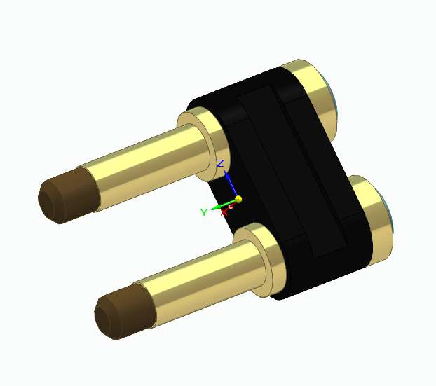

                  The plug has insulated tips, so lifting the bar breaks the contact.  Except as I’ve modelled it, the sockets are still connected via the springs!  They need to be insulated.
                  Bad news – I have interferences and misfits:
                  First the springs extend beyond the plugboard – they won’t fit in the box!
                  plugBoardBottomRight
                  And the nuts that fix the socket to the front panel collide.  It can also be seen that neighbouring shorting bars will collide.  It’s too cramped.
                  shortingbartop
                  Oh dear, should have taken up knitting!

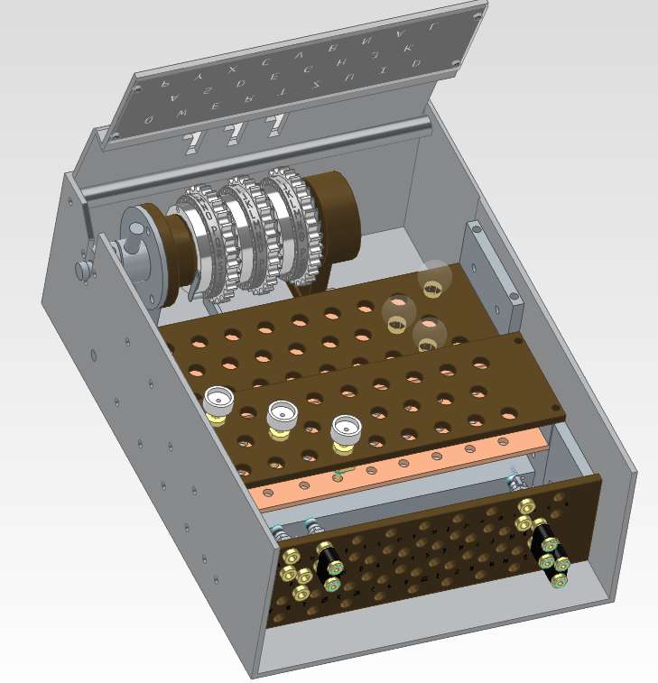

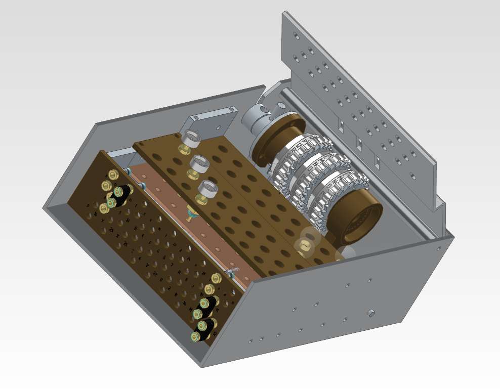

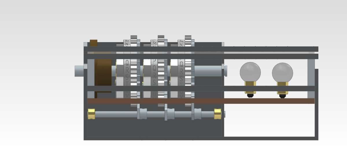

                        No good deed goes unpunished.  I modelled an overcomplicated lid yesterday and wasted this afternoon producing a simpler version.  The ten minute estimate turned into a 90 minute slog and then testing the assembly to ensure the lid opened and closed led to all sorts of shenanigans.  Zooming in finally showed the problem was a tiny collision, fixed by shaving 0.1mm off the edge.  Solid Edge is supposed to beep when parts collide; either I have to turn it on, or I’m deaf.
                        enigmaLidClosedJan28
                        enigma28Jan
                        With a lid, it’s possible to change the lamps without taking the machine to bits!
                        The space in the top right corner is for a 4V battery.  No idea what it looked like.
                        Also added:
                        • a lever operated cam (top left) which squeezes the rotors together to make electrical contact, and allows them to come loose so the they can be lifted out and changed.  (The Army enigmas mostly came with a set of 5 rotors, of which 3 were in the machine, order varied daily.)
                        • The brown reflector is notched to stop it rotating.
                        • on the right of the rotor assembly is the input box.  I guessed round, the book shows the original was a box, ho hum.

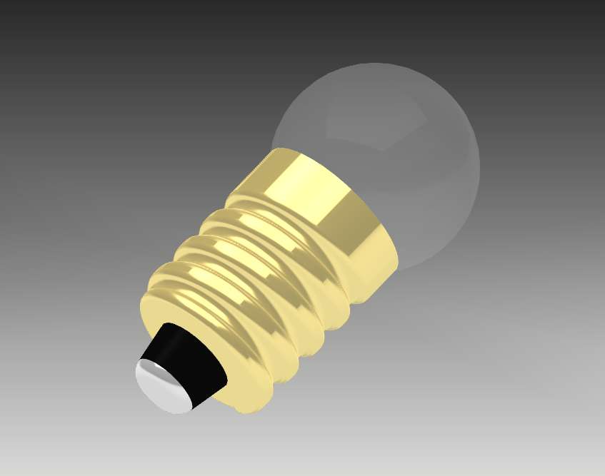

                        • Did a proper model of a 3V torch bulb, and it’s not any better than my first bodge.  Pretty though!
                        torchbulb
                        New items on the TODO list!
                        • ‘Improved’ the plate that steps the end wheel when keys are pressed and got it the wrong way round!  Should turn the rightmost wheel, not the left.
                        • Found a bezel is fitted under the lid to channel light into the letter display.  Has to be added and it has interesting curves.
                        • The plugboard socket and plug have to be plugged in the right way round.  Done by making one pin/socket bigger than the other so they only fit one way.  More work!
                        • In the original the bulbs screw down onto sprung contacts.   My version, where they screw down on a hard plate would work electrically, but many filaments would break if the machine were dropped.

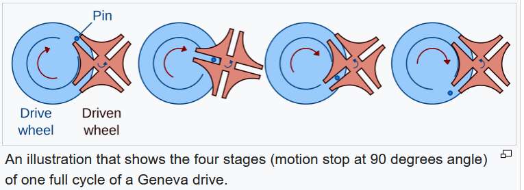

                        • Tackle the odometer mechanism.  I have an idea now: a pin on the side of each rotor engages a lever once per rotation, and the lever clicks the ratchet round.

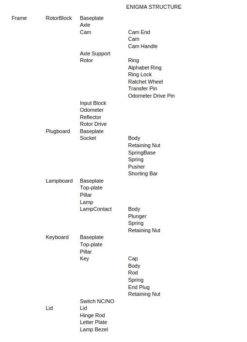

                        • I’ve caused mild problems by not planning the assembly tree more carefully.  Most of the model is assembled off the rotor shaft and it’s now apparent the rotors should be a sub-assembly, and it’s more logical to assemble off the box frame. Although an assembly can start with almost any part, the build is more stable if it’s done foundations up, i,e with a fixed part that doesn’t change much and provides a solid reference.  As is I’ve got a few parts in the ‘wrong’ sub-assembly, making it slightly awkward to navigate.
                        • Freelancing at reduced scale continues to cause trouble.  Couldn’t find the machine’s actual dimensions so the next version will assume the keyboard is about 250mm wide.  In theory action should follow on the heels of decision, but I’m dithering about starting again.
                        #780877

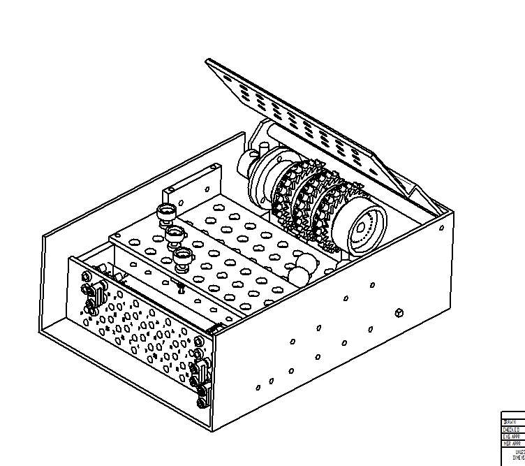

                          Not much done today because of a computer problem, but here’s the latest:
                          enigmaView29Jan
                          Gone as far as I think wise with this version, and, starting with the scale being wrong, fixing it is time wasted.  Better to start again and apply lessons learnt.   I’m now planning the Mk2.

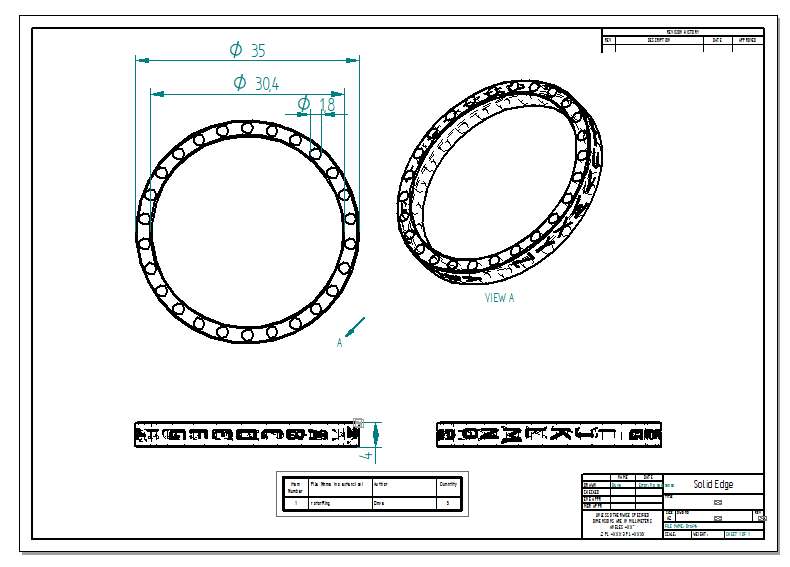

                          Had the Mk1 been good enough for production, CAD offers multiple ways of doing that:
                          • Generate CAM for subtractive processes like CNC, and find someone to make them.
                          • Generate CAM for additive processes like 3D printing, welding and casting.   Can’t weld or cast myself but I own a 3D printer and can braze/solder small parts.
                          • Generate 2D drawings, 49 so far, and make the parts using time-honoured methods in my traditional workshop.  CAD helps!  Creating 2D drawings from 3D models is fairly quick once you get the hang of it, certainly faster than 2D CAD and far, far faster than a manual drawing board.   Have to admit though that CAD generated drawings aren’t as good looking as hand drawn plans.  They’re not works of art though, only needed to provide dimensions in the workshop.
                          enigmaDraw1
                          enigmaRotorDrawing
                          A good thing about CAD is how much of the Enigma was modelled without me measuring anything!   Almost all the dimensions and proportions flow from the diameter of the rotor ring, not from endless calculations, dozens of 2D-drawings, and a notebook full of dimensions.   Not having to track dimensions rigorously is one of the things that derails 3D CAD learners with strong 2D skills.  In 2D, designers have to track dimensions, in 3D they don’t, and believe it’s essential wastes time galore.  Important to think in 3D which is a different skill.
                          My biggest mistake was to start by modelling at reduced scale.  With hindsight, I’d have done better to model at full-size.  And scale down from that later if a miniature is to be made.
                          Not finished yet!

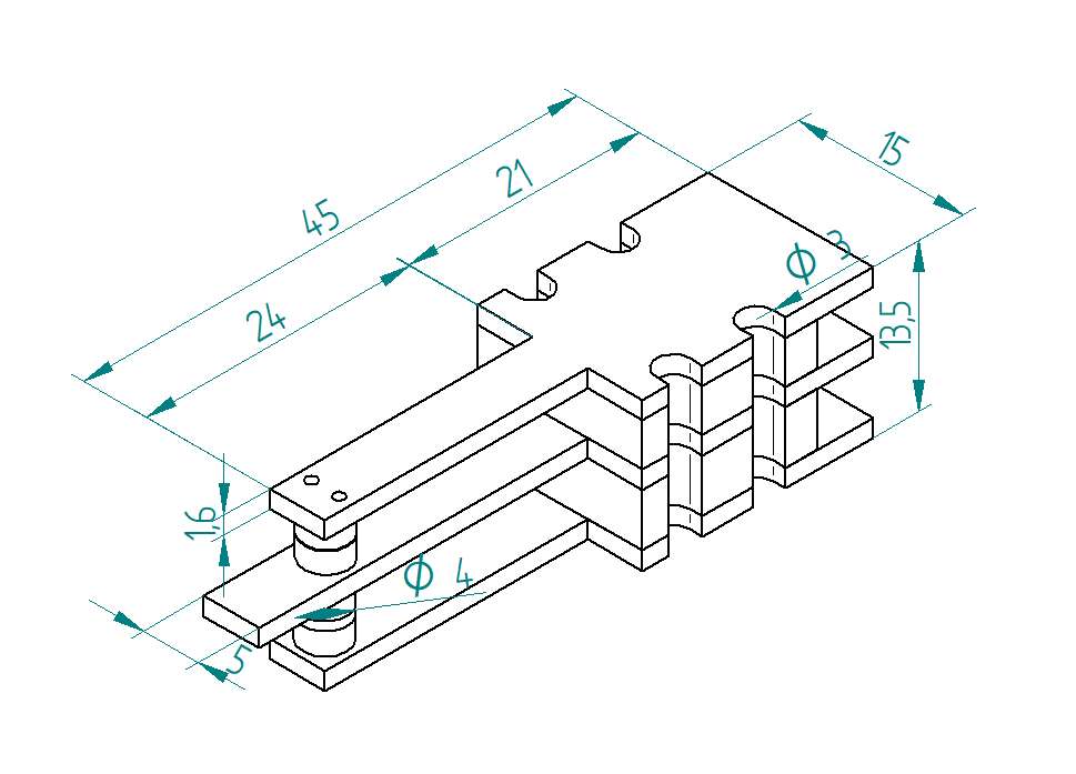

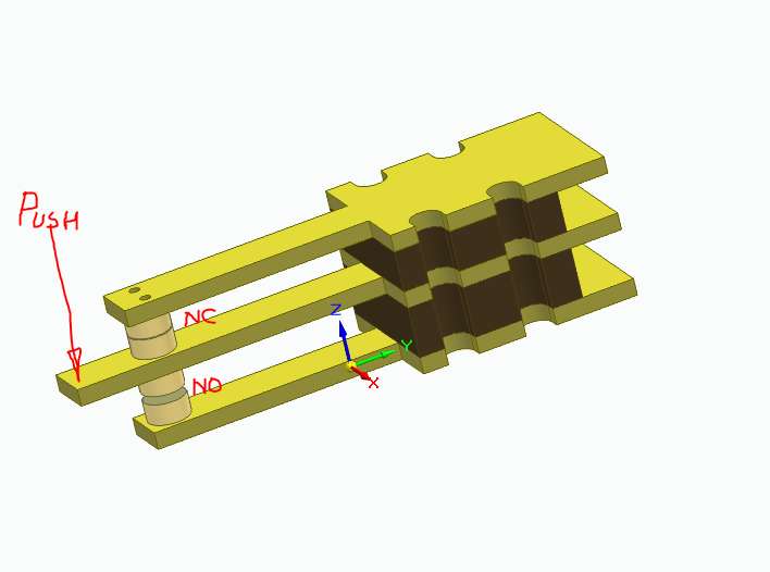

                            I need 26 Single Pole Double throw switches, each operated by pushing a spring loaded key.   I think they can be made without much bother:
                            enigmaSwitch
                            Wonder if paxolin stripboard is springy and tough enough.  If so, easily made with a Dremel and some soldering!  Otherwise, Beryllium Copper, Phosphor Bronze or wiper blade spring strip.
                            Thinking about the Mk 2 full-size model, I shall probably go with this assembly structure:
                            enigmaassystructure
                            #781078
                            Ian P
                              @ianp
                              Fibreglass would be better that Paxolin but as the pictures do not give any idea of size its to hard advise.
                              I think that when you started this thread you said it was more of an exercise than an actual build project but if it is  something you are going to build, then how close to the original design and materials are you aiming for?
                              I’ve not looked at how the switches are positioned but based on your switch diagram picture it that are all mounted in one plane then why not make your sandwich from three PCB’s, the NC and NO being achieved two different spacer thicknesses. The middle wiper PCB being a double sided one.
                              Ian P
                              #781093
                                  Your wish is my command, 45l x 15w x 13.5h, in mm:
                                  enigmaSwitchDwg
                                  Intended to be buildable, so I’m trying hard not to fake anything, but it’s a freelance.  Starting out I had very little information about the innards, so lots of guesswork based on blurred photos.  Since then got a copy of ‘Inside Enigma’, which has more photos.   Still not completely clear and no drawings – I don’t even know the size of the box.
                                  Not trying for a perfect replica, impossible without more data, but I’d like to keep it fairly authentic with 1920’s technology.  Might veer away by 3D printing much of it in plastic, cos that’s easy.   May never get built because I’m unwell.
                                  Good idea.  My notion that the holes drilled in stripboard will make it springier than PCB is a wild untested guess!  The original is made of metal insulated with what looks in a B&W photo to be Paxolin or Bakelite.

                                      So, another question. How far does the switch moving part have to travel? I presume these are not latching switches and that there is one switch per alphabet key. I know fibreglass (especially a whole PCB ‘comb’ structure) is way out of authentic, as is 1/4″ jacks and microswitches. I suggested FR4 board material because Paxolin or SRBP is brittle by comparison. However I dont have a clue about Enigma but sort of assumed that pressing each letter keys moved a rotor, oh, but then I remember rotors having to be set each day so I’m definitely confusing myself.
                                      Are the plugboard jumpers single core wires or do you need multipole connections?
                                      The switch in your drawing looks to have quite a lot of parts, with contacts fastened (how?) to the blade. If there are twenty odd switches each with there will be quite a lot of nuts and bolts!
                                        Correct!
                                        Which may be a good reason for avoiding stripboard!  The advantage of stripboard is it comes with copper tracks and pre-drilled holes.  I’d bet money fibre glass makes a better spring but it’s harder to drill and cut and there are 78 of them!

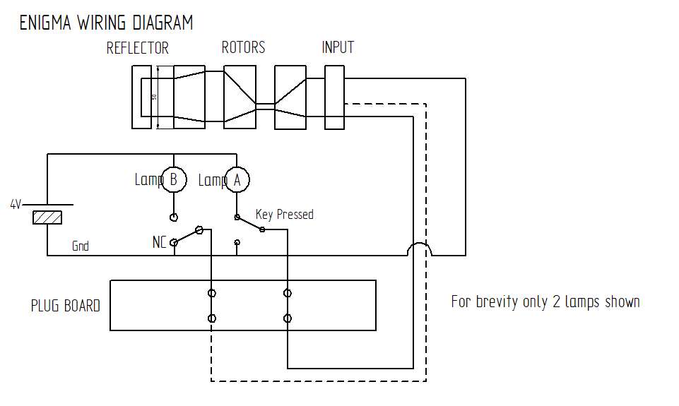

                                        That’s right.  Pressing a key steps the rightmost rotor once through 360/26 degrees.  When the rotor has stepped a rotation if moves the next rotor one step, like an odometer (my next challenge!)
                                        This part view shows my first answer, which is wrong:
                                        enigmaKeydetail
                                        When a key is pressed a rod passes through a hole in the Copper ground plate, not touching it, and pushes the ratchet drive plate down.  The drive plate turns the rotor by engaging a pawl with its’ ratchet wheel.    The rod is wider near the end of travel, and in this design, makes electric contact with the ground plate.  This is wrong, see circuit diagram below.
                                        Multipole! Yes, indeed lots of parts.  Each key contains 7 parts, and 26×7 = 182!  Each switch contains 9×26=234 parts. The contacts would be soldered to the blade.  Easy if the blade is copper, harder if spring steel.  Building an Enigma, or two as Rob suggests, calls for production technique because there are so many bits!
                                        Ian P
                                        The unchecked wiring diagram shows why my design above is wrong!  Pressing a key turns all the lamps on!  A  SPDT switch is needed:
                                        enigmaWiring
                                        Enigma was conceived just after WW1 when the Germans found that the British were reading their secret diplomatic telegrams.  See Zimmerman Telegram.  As is common with inventions, at least 3 others had much the same idea at the same time.  Scherbius was first to patent and history made his machine famous.   Few have heard of Typex or ECM.  No drama, no excitement because the Germans couldn’t break them.
                                        Thanks for asking the question.  Tackled Solid Edge’s 2D drawing tool to do the wiring diagram.  Time well spent!

                                              Dave,
                                              I have been silently following your progress with interest and have been playing with Alibre Atom and Fusion 360 to try to replicate the letter drums.  Unfortunately, Atom doesn’t have the extrude or wrap facilities that the Expert or Pro versions have, but I have been able to model the drums in Fusion.  It requires the plane upon which the letter list is placed to be offset – by an non-specific amount – from the circumference (not tangential) to produce the required result.  At least the way I do it, it does!  I used Bold Arial font, Height = 10mm and line spacing = 3.296mm, if it’s of any interest.
                                              By the way, all the pictures of Enigma machines that I have seen have the letters wrapped “the other way around” the drum, the reverse direction to that shown in your CAD shots.
                                              See the picture here the National Museum of Computing
                                              Back to watching silently ……..
                                              #781338
                                                Thanks, letters the wrong way round added to my TO DO list.  Would have been sent to the Russian Front for making that mistake in WW2!
                                                Offsetting the wrap in Solid Edge as you suggest seems to break it.  I’ll try again though – experimenting with SE wrap had me thoroughly confused, so worth trying again now it nearly works.
                                                Cheers,

                                                  Spent a few hours on Spring Design this morning.  Conclusion, spring design is hard! Baffled. Due to ignorance I’m probably asking SE to design a spring that falls outside ‘best practice’.
                                                  Having failed to learn basic springs, I had a go at the mechanism needed to turn Enigmas rotors.
                                                  Enigma rotors move like an odometer, counting in base 26.  The rightmost rotor is stepped 1/26 of a revolution every time a key is pressed.  And every full revolution of a rotor turns the next rotor along 1/26 of a revolution.
                                                  Disaster, designing mechanical movements clearly isn’t my forte!  Latest attempt:
                                                  odoSide
                                                  The pin on the right hand rotor lifts an arm.  The arm translates the motion to the left where it lifts a pawl engaged with a ratchet wheel:
                                                  odoEnd
                                                  It works except the design can only turn one adjacent rotor, and cannot be replicated to drive a third.  Also discovered my understanding of Assembly constraints is imperfect.
                                                  Aargh!
                                                  #781394
                                                  noel shelley
                                                    @noelshelley55608
                                                    Study an old speedo or counter to see how to get the rotors to turn in 1s 10s and 100s ? Noel.
                                                    #781399
                                                      Good idea, except I don’t have either!  Googling failed too in that the mechanism in the pictures I found on the web aren’t clear.  The information is out there, I’ve failed to find it.
                                                      Quite interesting what happens when attempting to design a mechanism from scratch rather than copying an existing example.  Whoever invented the odometer was a clever chap!
                                                      Triggered an idea though – I used to have a rotating number stamp.   Wonder where it is?  Also remembered one of my clock books had something, bingo!  It’s the Geneva Mechanism.  Image from Wikipedia:
                                                      geneva
                                                      Thanks,
