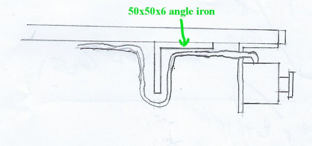

        Clive B 1
          @cliveb1
          Bill
          Yes, I know what you mean about mini trunking I’ve used it myself in the past, glued, nailed, screwed whatever it takes to get it to hold, I don’t think it will be glued not with all that shaking going on.
          At the end of the day I suppose it comes down to whatever is desirable, I must admit I was going to settle for just clipping the wire and because such a big hole needs to be drilled to accommodate glands, I was going to just loop the cable under the angle iron.
          But since you’ve mentioned mini trunking I’m now debating whether to use that and do as someone else suggested cut a grommet into two pieces and glue them into the hole both sides of the angle.
          Clive

                          When I purchased the machine from new all it ever had was the no volt switch on top of the motor.
                          The cable came out from the side of the switch box and had a three pin plug on the end of it. Because I did not want to drape the cable over the top of the machines for obvious reasons, it was passed down through the same hole the chip extraction hose goes through and from there was plugged into a convenient socket outlet on the wall.
                          To turn the machine on or off was a case of having to reach over to do so, as matter of fact sometimes when I wanted to switch the machine off, I’d use a piece of wood save stretching over.
                          My plan now was to fit emergency stops and bring all the wiring from them into the switch box on top of the motor, doing away with the original switch altogether and putting a steel blanking plate on top of box.
                          The cabling would then come out of the side of the switch box including the power supply for the motor down through the hole in the table and the DOL would be fastened to a board and either hung on the side of the machine I’m working on or on the wall and from there a short cable with a three pin plug would be pushed into a convenient power point.
                          I’d love to be able to fix the DOL starter in one permanent position but because the whole machine has to be moved around due to space limitations, I can’t do that. ie if the machine was pushed against the wall the DOL was permanently fixed to I’d never be able to reach it.
                          Ian I dare say a lot of the guys on this forum have metal turning lathes or mills, a woodwork machine such as mine needs a lot of space, think about it, if I have a piece of wood to be planed and say its 8 foot long the machine will need at least 18 feet, 8 foot going in and 8 foot coming out plus enough space to feed it in and get it out of the machine so that’s why sometimes the machine is shoved up against a wall.
                          Believe me I am trying to persuade my wife we need to move, I am working on it laugh.
                          As you can see I’ve never had E/stop buttons on the machine, I was thinking I could use them to turn the machine off without the need to turn off at the DOL, having said that I don’t even know if this would have any adverse effect on the DOL or indeed if an E/stop has been operated I’d have to take the cover off the DOL and reset anything I’m hoping not.
                          Thank you for your comments they are much appreciated .
                          Clive

                              I fully understand the workspace envelope required for woodworking and when I need to use my radial arm saw now only do so when I can wheel it outside. I'm not sure though whether your current plan is going to be as convenient to operate as you expect.
                              In normal parlance, 'Emergency Stop' switches are just for that purpose. Using four separate ones just to stop the machine without having an equally easy to operate 'On' switch is highly unusual (or at least I have never come across a setup like that).
                              Some general thoughts (on this particular) machine control.
                              Feeding the motor through a contactor (as you are planning) then gives the No-Volt release feature that nowadays seems to be mandatory so that good.
                              The contactor should have a low voltage coil so that all the control wiring (some of which we now know needs to be flexible and frequently moved) is isolated and would not cause a hazard if it got damaged, tripped over, fell iunto a bucket of water, or whatever.
                              Only three low voltage wires (which would not need an earth) are needed to connect to two pushbuttons that would be the On/Off controls for the motor. If the Stop button is the larger or more prominent button of the pair, then in effect it is your E-Stop. You can have as many two button pairs as you want from the same three wires if you want to control the motor from several locations.
                              The more switches and controls you have, especially if they are widely dispersed the less likely one would be to instinctively know which one to use in a genuine emergency.
                              If this machine has approximately a 'square' format like a large table, then just two E-Stop switches or control positions on diagonally opposite corners are just as reachable as your four will be.
                              Other options to consider could be, a keyfob type wireless control of the motor maybe on your hand or wrist whilst working, foot operated switches (that need to be kept depressed).
