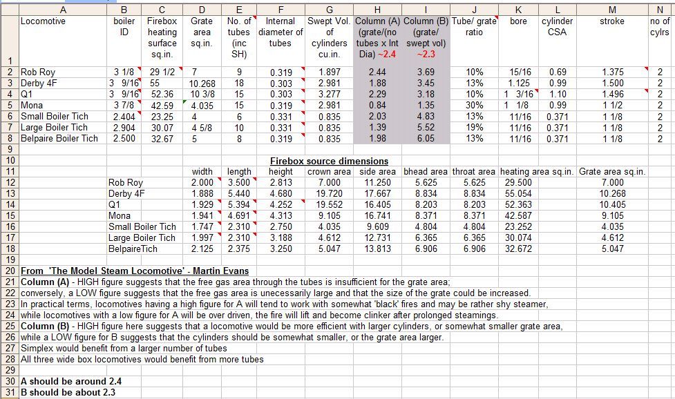

                    Besides the Tee section approach discussed by Michael W for the small and large boiler, I have wondered about the Belpaire boiler that LBSC published as an improvement. It may be too much for you at the moment, but it uses a single 2 5/8″ 16g tube, no long joint in the barrel, and the performance looks to be the best of the three of them, with a larger grate and heating area. The following is a spreadsheet comparing a few 3 1/2″ gauge boilers. It may need to be magnified, but you can do this by either adjusting you browser (View->Zoom) or downloading the image and looking at in a viewer.
