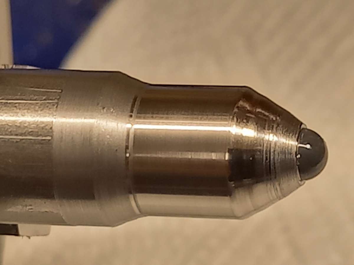

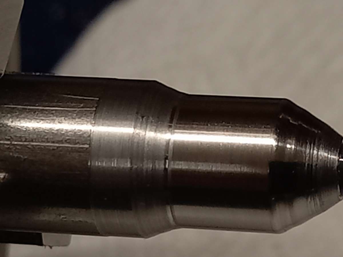

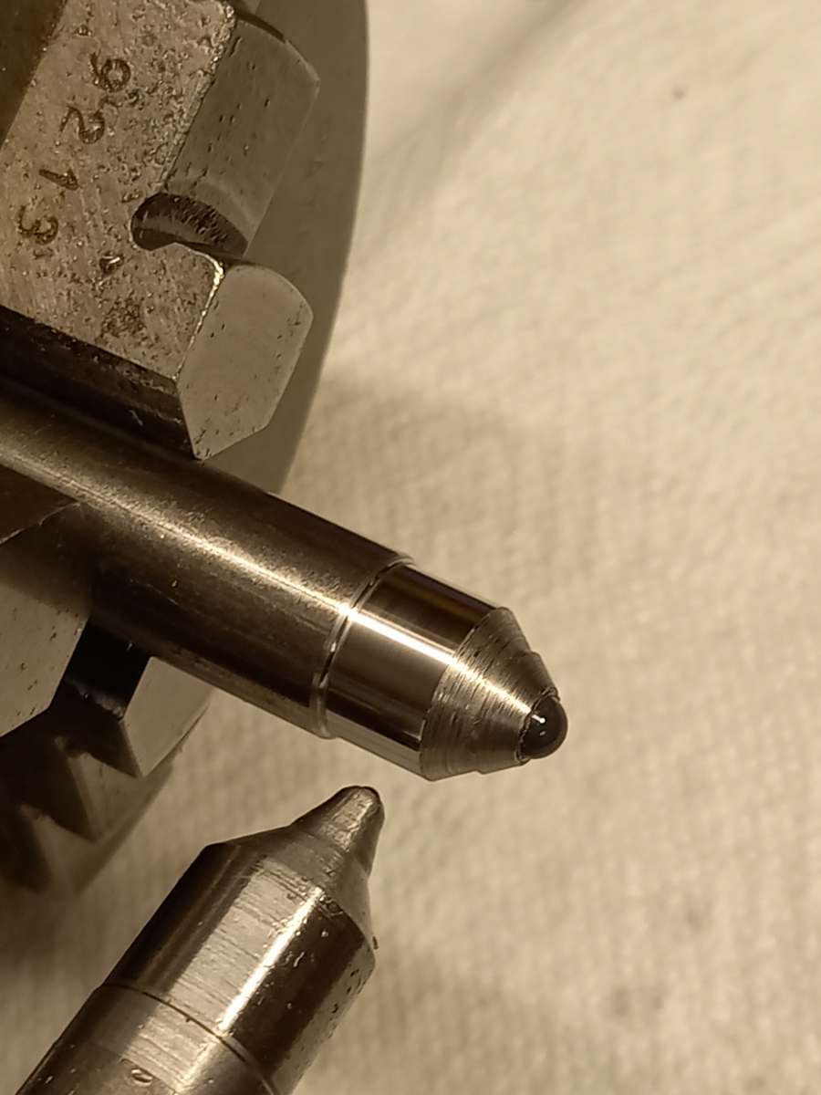

        #756532
        Neil Lickfold
          @neillickfold44316
          <p style=”text-align: left;”>Pictures.20240929_21104020240929_21505920240929_211059</p>
          #756535
          Neil Lickfold
            @neillickfold44316
            The ist picture and the last picture are the same tool that was burnished with the 5/32 tool shown in the 2nd picture. That same tool in the 2nd picture also burnished the 1/16 ceramic ball holder.
            The middle picture is showing the finish from the 1/16 ceramic ball burnishing the reference diameter of the 1st tool made. The 1/16 ball was much better than the 5/32 ball it seems to me.
            All 3 holders have the ceramic ball just pressed into the end of the bored steel.
            edit, looking at the photo’s , you can see that I have not cleaned off the oil very well. The taper was done a bit free hand and some from an old 45 chamfer tool. They can all be made pretty now that I know that it works really well.
            Will try them on other materials that are softer like free cutting MS and Aluminium etc.
