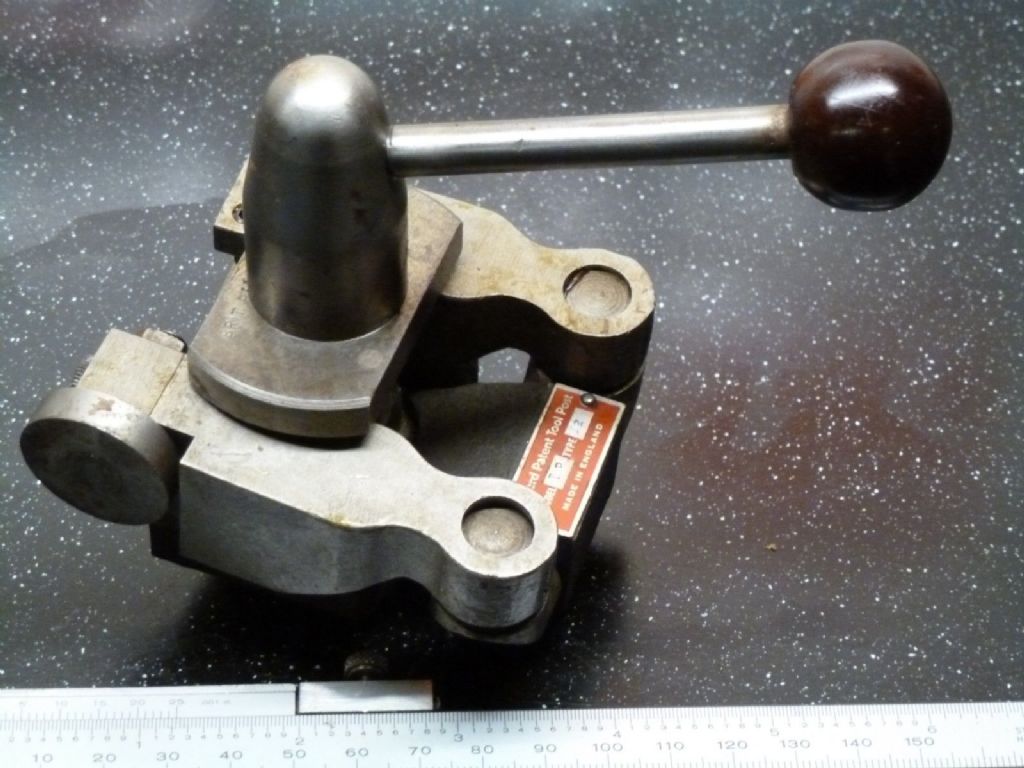

      Has anybody come across a Burnerd Miniature Quick-set Toolpost Type TP2?
      I have attached a picture of it, other pictures of it and tool holders etc. are shown in Kens Album
      Interested in any information or ME. or MEW. articles on it it.

          I'm afraid not, Ken … But having seen your pictures; I want one !!

              I wonder how well they worked with the tool bits sandwiched between two pairs of grub screws and the working end of the tool holder resting on an Inverted V? Both would seem to suggest a less than rigid setup.
              Also don't look as easy to set tool height as a good QCTP as you would have to fiddle with grub screws from below.
              Unless I'm missing something that makes the set desirable apart from the name.
              J

                It looks to me as if the inverted vee is just to prevent lateral slippage and that the flat rests on the base (?) but the four grub screws holding a toolbit would be a real PITA to adjust. Forget milking stools, this is more like an inverted pendulum
                What's with the so-called form-tool? That round slug looks more like a crude bearing alignment tool to me.

                      The opposed grub screws would, theoretically, make it unnecessary to use shims to set tool height. Jason and Jon seem to have pretty well covered the (im)practicality of adjustment on the machine. Only easy way I can see is to have a separate setting jig on the bench incorporating the Vee and pin mounting surfaces on a body suitably cut away for access to the grub screws. A vertical arrangement looks to best way of doing such.
                      Jon that round slug is a piece of tool steel to be ground as the user sees fit.
                      Yet another tool-holding system that stimulates my inner McEnroe "You cannot be serious.". Gotta be something about lathe tool holding that interferes with normal engineering sensibility.

                          That little red printed nameplate on the toolpost …. what do you call them and where do you get them made ? Anyone know ?

                                  It appears to have been well used judging by the amount of swarf in the tool holders.
                                  I was thinking of making replaceable tip tool holders fit. once set it would be a just a matter of replacing the tips as required.

                                          My George Adams round-bed lathe has this toolpost system – I've been using it for nearly 40 years and wouldn't change it for the world.
                                          See the following links for pictures and a write-up: http://lathes.co.uk/georgeadamsroundbed/
                                          http://lathes.co.uk/haighton/page3.html

                                                  The tool body does not have a patent no. on it.
                                                  The tool holder has the British Patent No 655793 on it.
                                                  Hope this helps.

                                                      I have a Burnerd Model TP Type 1 tool post set in a wooden box, don’t think it’s ever been used certainly not by me.
                                                      Six tool holders and a slave to balance the load.
                                                      3 RH
                                                      1 LH
                                                      1 Parting
                                                      1 Boring bar
                                                      1 Slave
                                                      It came with a photo copy of an advertisement showing eight different types of tool holder (plus the slave) that were available for it .
                                                      I’ve never attempted to use it.
