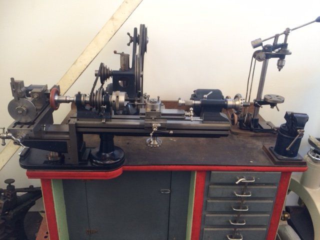

      Well I was visiting a machinery dealer and while looking around I came across this.
      The vise is a Record 00 which should give you some idea of scale
      #12709

          OK Ian, any more info or photo's of this machine ?
          Very interesting indeed.

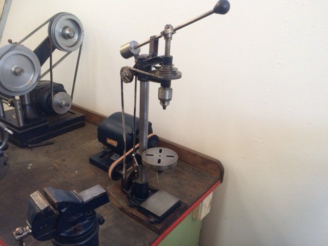

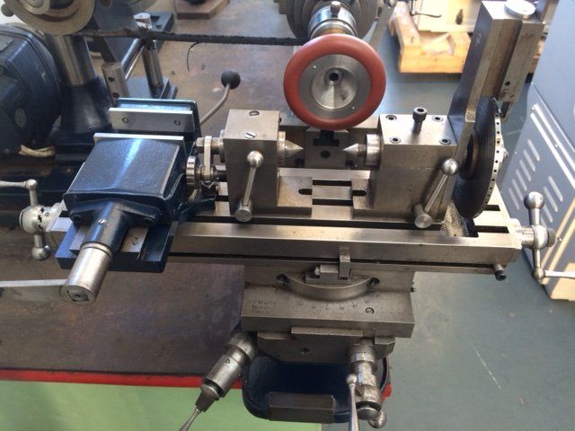

            I've added some more photos, it looks like everything was built by a bloke in Timaru, machining and markings are excellent. There is a name on the milling slide.
            I'd like to find out a bit more about it myself.
            The vice is bolted to the internal block on the pedestal and is threaded, so is rather sold when the clamping bolt is nipped up.

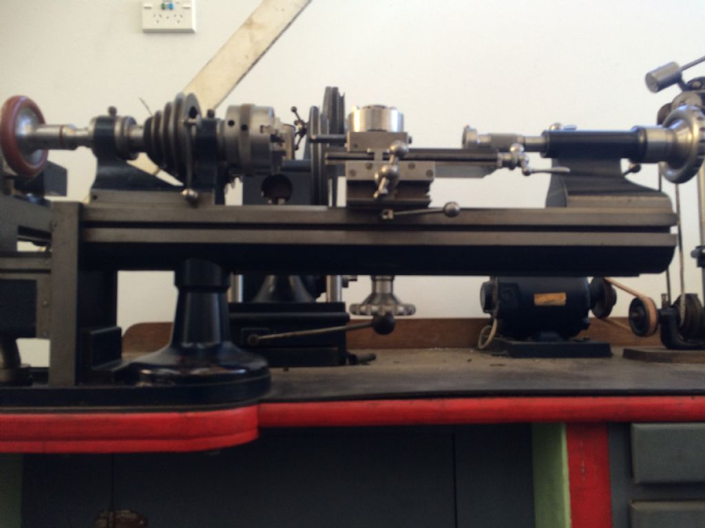

              Why is there a T slot cut into the operators side? Any ideas?
              I've seen one once, on a pultra 1590, for the threading attachment, on the far side of the lathe
              #242952
              Paul Lousick
                @paullousick59116
                T-Slot for end stops ????

                  The bed looks very much like a Mikron

                  Kiwi Bloke
                    @kiwibloke62605
                    I know this machine's 'brother'. There are five or six in the family. Their history is fascinating and may be published in the future in MEW. The machines are derived from a non-commercially-made-in-NZ 'prototype'. Five sets of castings were obtained by the person whose name appears on the photographed machine in the late 1940s. The patterns were made by his father. These were then made up into complete machines by various people, incorporating various different features. The lathes were not commercially produced. They contain no proprietary parts, apart from ball races in some of the headstocks and, I suppose, some fixings. The T-slot on the front and rear face of the bed was intended for accessory attachment. The whereabouts of all but one of the machines is known and the 'missing' one is thought to survive not too far away. Kiwi ingenuity at its best!
